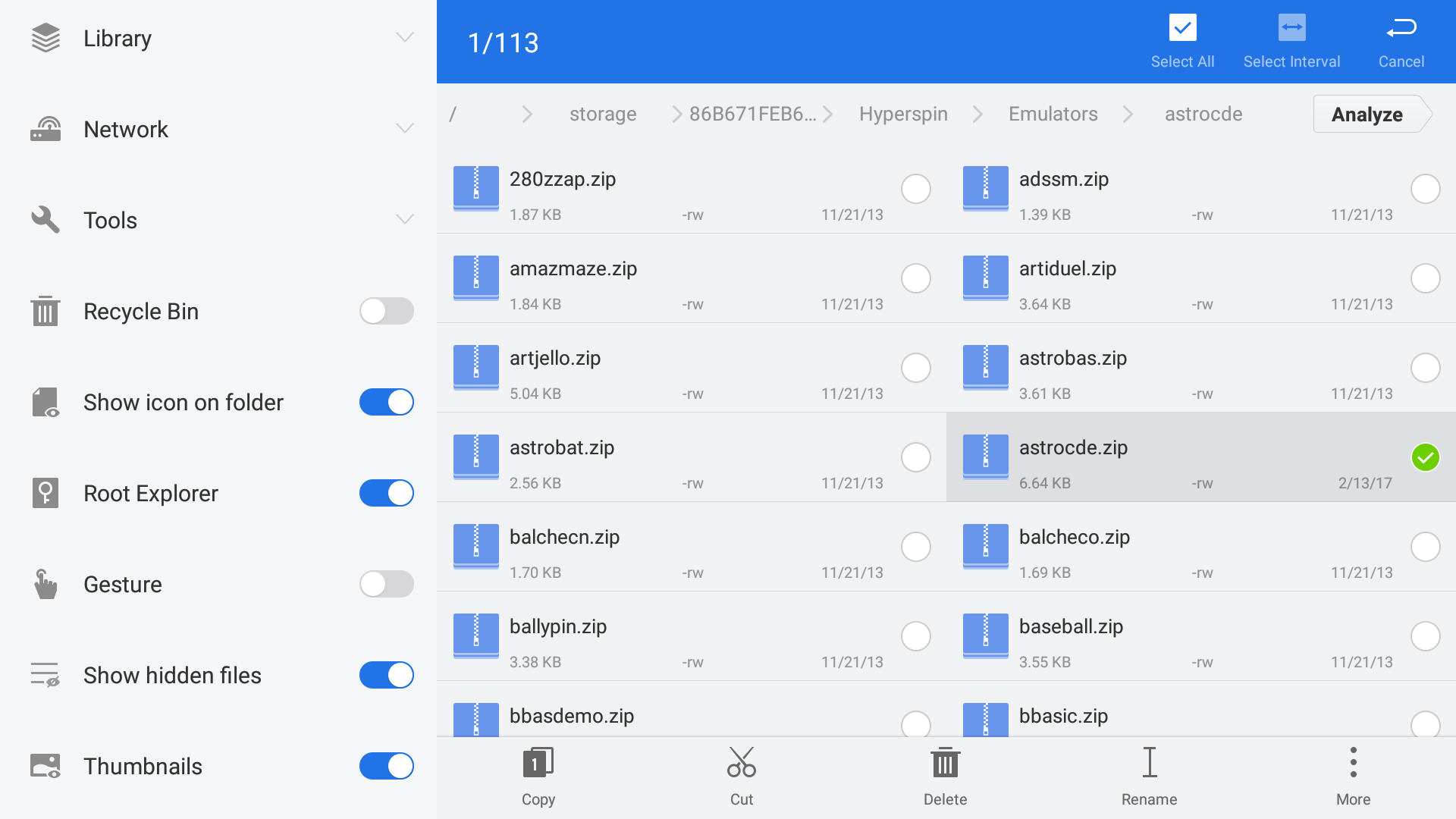

sonkun Posted February 15, 2017 Author Posted February 15, 2017 32 minutes ago, cataclysm67 said: in retroarch when i start a game it gets to loading screen then says retroarch has stopped Made a little edit to the tutorial and added a pic of my settings which I did forget to mention the first time around. See if that pic will help you out. Also make sure your bios is in that rom folder and that the rom folder is named astrocde
Creezz67 Posted February 15, 2017 Posted February 15, 2017 Thanks, yes mine is the same but still loads, then black screen then retroarch has stopped

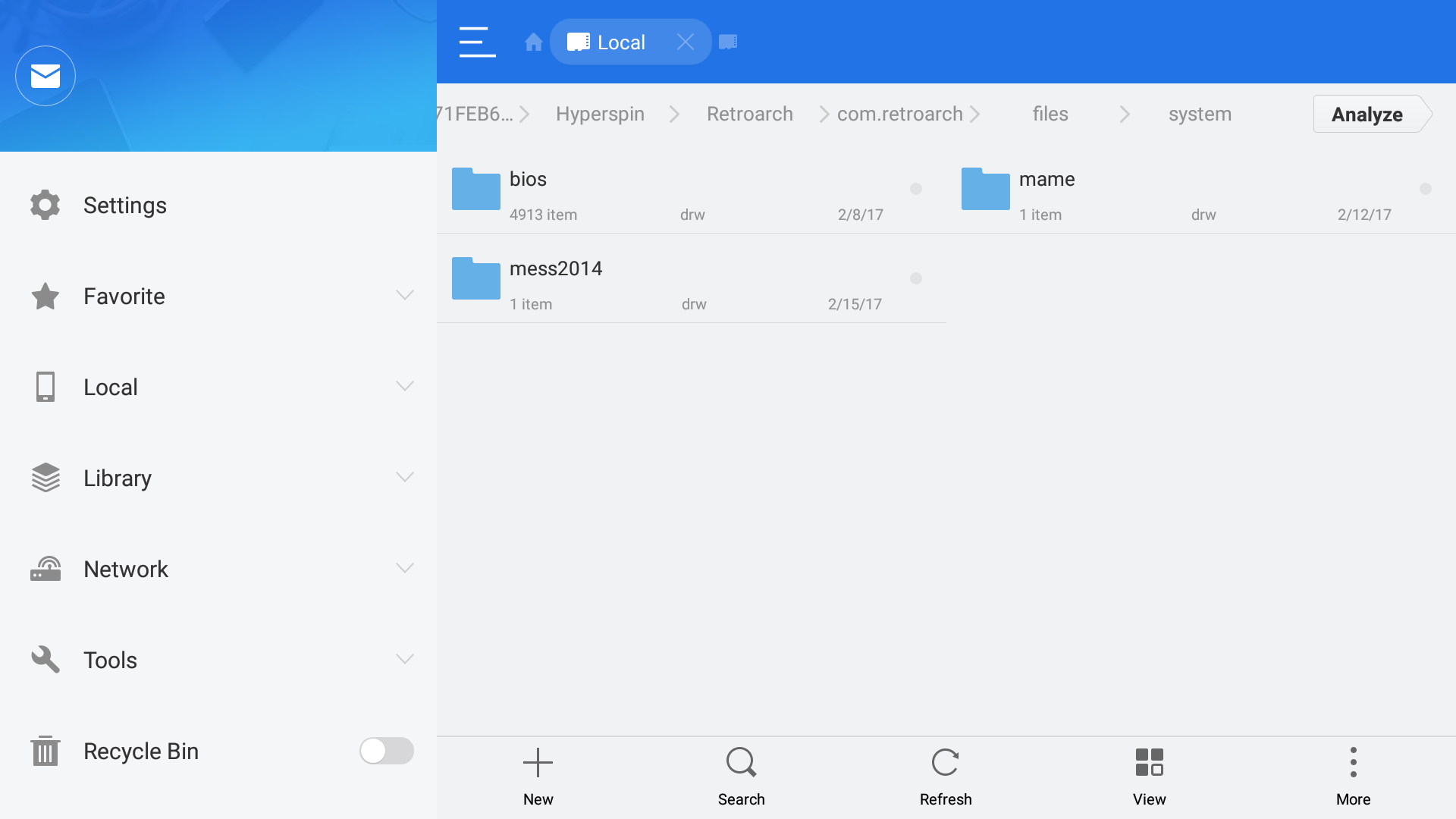

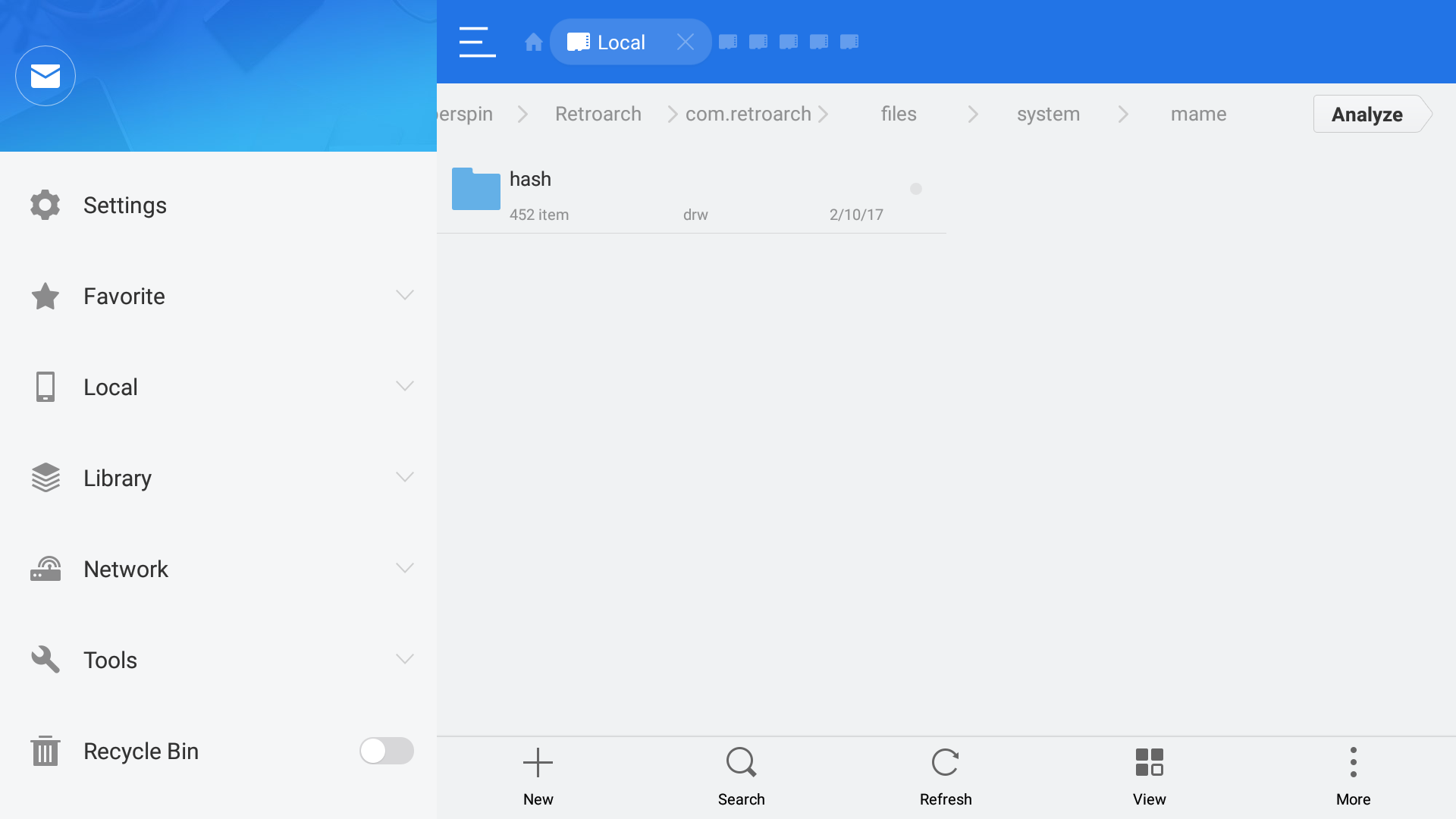

sonkun Posted February 15, 2017 Author Posted February 15, 2017 Hmm, I just did a test right now through retroarch stand alone and I got into the game. I'm not sure what could be causing your problem. One way a game will not start for sure is if you don't have that mame hash folder in your retroarch system folder, that's an absolute must and also have your retroarch "system/bios" directory pointed to where you have have your retroarch system folder which is Android>data>com.retroarch>files>system and then hit <use this directory>
sonkun Posted February 15, 2017 Author Posted February 15, 2017 12 hours ago, cataclysm67 said: Thanks, yes mine is the same but still loads, then black screen then retroarch has stopped Made a few more edits to the tutorial. Also I'm curious if you managed to get it working. If so that will also let me know if this tutorial is useful.
Creezz67 Posted February 16, 2017 Posted February 16, 2017 Hi, Still not working. I have all folders as you have stated and pointed RetroArch system/bios to this folder In bios what files go in there ? for example Bally Astrocade. I thought astrocde bios went in with the roms ? I have put it in bios and roms folders
sonkun Posted February 16, 2017 Author Posted February 16, 2017 Your bios folder is for all your other systems, for mess/mame you really just need to have the "astrocde" bios in the same folder with your roms although I pace bios for Mess systems in there as well cause why not. The fact that you couldn't get the game to start not even in retroarch can mean a few things. You didn't place/set everything where they need to be or it could possibly be a bad or outdated rom perhaps. Mame is constanly updated their roms and sometimes the old roms won't work with a newer version of Mame. Maybee try fetching a different rom and try that out. There are Mame/Mess ready rom packs out there (Google is your friend) and always make sure everything is placed/set where it needs to be.

thatman84 Posted February 16, 2017 Posted February 16, 2017 You need the 0.182 software list roms to match the hash file. (You can get away with older ones so long as the CRC's and names match what's in the hash file. you should have the 0.182 hash file make sure you have the MAME core options set correctly. software list enabled auto detect rom type. boot to bios OFF Boot to command line OFF @cataclysm67 can you drop a couple of screenshots Hyperspin 2.0 Latest Download Hyperspin 2.0 Documentation -------Pre Hyperspin 2.0 Below---------- HS Android Overview & Install HS Android Base Pack Download My Tutorials

thatman84 Posted February 16, 2017 Posted February 16, 2017 Doubt it's the 2017 shield but can't say for sure. if you can run MAME you should be able to get these running. what do yo have in your retroarch system/MAME folder? Hyperspin 2.0 Latest Download Hyperspin 2.0 Documentation -------Pre Hyperspin 2.0 Below---------- HS Android Overview & Install HS Android Base Pack Download My Tutorials
Creezz67 Posted February 16, 2017 Posted February 16, 2017 Hash folder, artwork , ini folder and bios folder
