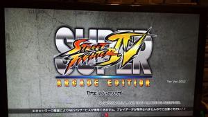

gigapig Posted March 25, 2016 Posted March 25, 2016 The 2 player patch with the unlocked characters I've always made available is for the 2012 version.
hocuslocus Posted March 26, 2016 Posted March 26, 2016 I'm kinda new to this site, so I don't know if I'm looking in the right place I went to your profile - files page and none of the items were the two player patch. are they somewhere else? other then it saying ver 2012 I'm not sure how else to tell the difference. I'm sure there are other updates for the game which is why I'm trying for it. thank you

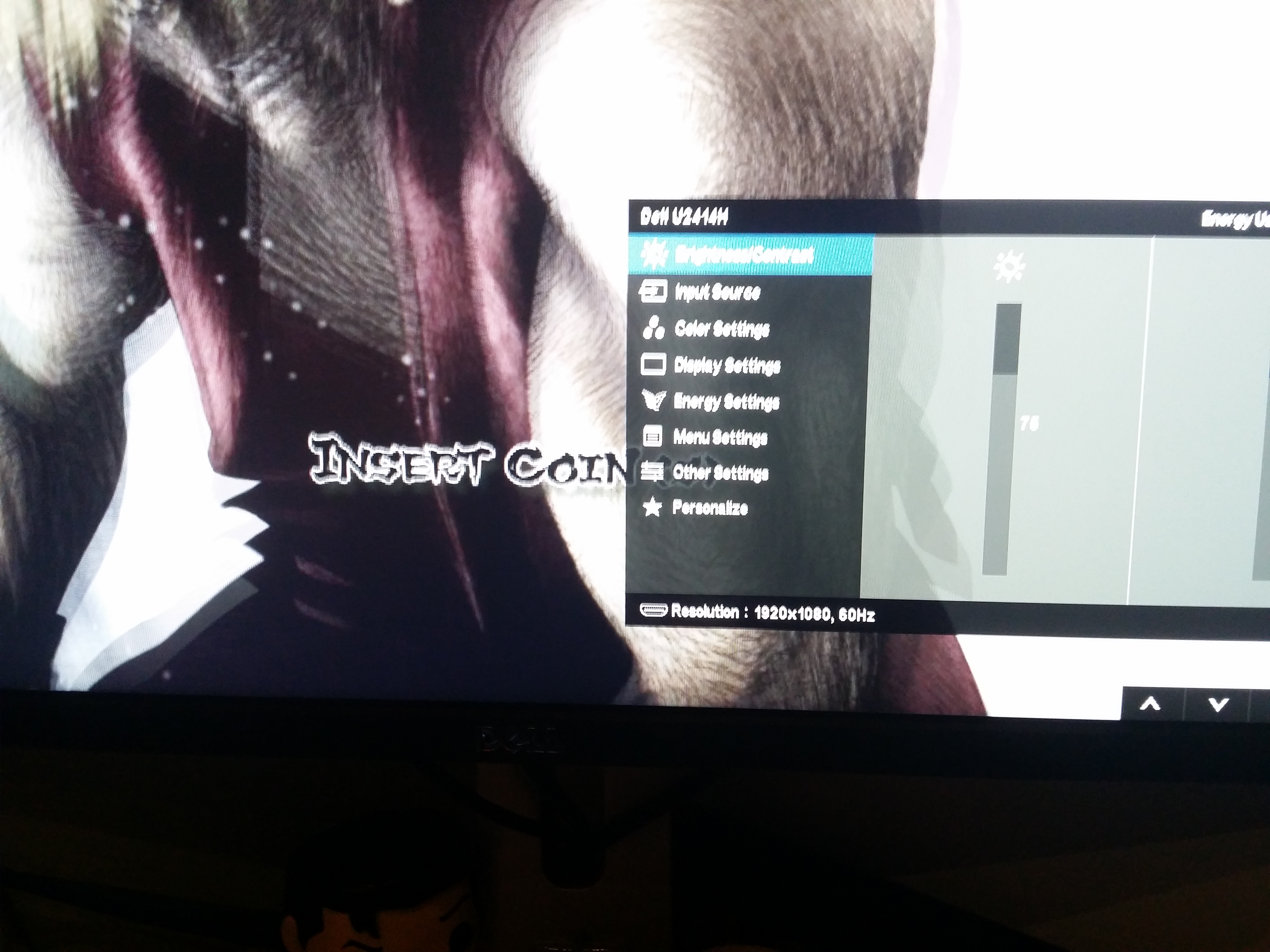

hocuslocus Posted March 26, 2016 Posted March 26, 2016 It's to bad I was trying to use arcade pc launcher v 1.4 since it already has a menu to be able to change the resolution and a corresponding .dat file. only problem is it uses it's own game.exe which is a 2010 1 player. guess I can use it on all the other ones. also vaderag I'm confused about this I don't believe I have the same .exe's as you caused I searched for the reference and didn't find it then I ran movavi (a camtasia imposter) to verify the game was running at 1920 x 1080. and went searching for both 0780 and 0438. I found a whole lot of each number but not a line where both numbers exist. I don't necessarily need to change the resolution but it would be nice to find out how.
vaderag Posted March 26, 2016 Posted March 26, 2016 It's to bad I was trying to use arcade pc launcher v 1.4 since it already has a menu to be able to change the resolution and a corresponding .dat file. only problem is it uses it's own game.exe which is a 2010 1 player. guess I can use it on all the other ones. also vaderag I'm confused about this I don't believe I have the same .exe's as you caused I searched for the reference and didn't find it then I ran movavi (a camtasia imposter) to verify the game was running at 1920 x 1080. and went searching for both 0780 and 0438. I found a whole lot of each number but not a line where both numbers exist. I don't necessarily need to change the resolution but it would be nice to find out how. If you used am extremal launcher it may have changed the exe... I was looking at the clean one...Honestly tho, if you don't need to change the resolution, save your time!!

hocuslocus Posted March 26, 2016 Posted March 26, 2016 ahhh got ya, and thank you gigapig. got it, I missed your note about byte order "intel" from those files I recieved I found the reference on line 038721C that one was at 1920 = 8007 by 1080 =3804 on the ttshell of the 2pversion it's at 1280x720 and those are 1280 = 0005 720 = D002 thank you both, definitely saved me a lot of time.

prefor Posted August 28, 2016 Posted August 28, 2016 OKAY... For anyone that cares, i solved the main issue. I can now play 2player at 16:10 The way I did this was thus: - Hex editor compared ttxshell to game.exe - it is basically a modified version of that - Found the reference to 1080p and changed to 1200 You can do the same by following these instructions: 1) Download a Hex Editor - I used Hex Workshop 2) Go to reference 00387224 3) change the value (which is 3804 if i remember rightly) to B004 - this is the hex for 1200 In theory you could change the resolution totally here - there is another value on the same line (earlier) for 8007 - this is the 1920 - you can change the combo of these to match whatever res you like (i assume) Save the file, run using loader and the new ttxshell. Bobs your uncle Oh, one other thing - if you don't know hex you can convert decimal to Hex in that tool by using the convertor under tools. Set it to intel and short and type the value in decimal box This was a full eve of trial and error so quite chuffed!! Could you please me out here I've been trying to figure this out but i just can't seem to find any of those codes that you mentioned I downloaded Hex Workshop, and i opened "ttxshell.exe" from the hex editor but as i wrote i can't find any of those codes or reference from it... How can i change my resolution to 1366x768? Please help I hate that my game is in slow-mo if i use the high-res in the "Typex-Config"

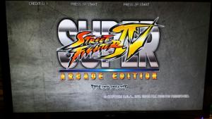

UlquiorraS4 Posted August 17, 2017 Posted August 17, 2017 4 hours ago, gigapig said: How are you testing to see that the res is 1080? Because it fits perfectly with my LCD monitor resolution, which it's maximum res 1920x1080. (Oh, and i've set "duplicate screens" in my video options.) When i look to my TV, i see that the resolution is not fit, it overpass the resolution. A Example? when i play Super Street Fighter IV Arcade Edition, in the initializing screen, i can only see "nitializing" in my tv, but when i see in my LCD monitor, its ok..
gigapig Posted August 17, 2017 Posted August 17, 2017 1 hour ago, UlquiorraS4 said: Because it fits perfectly with my LCD monitor resolution, which it's maximum res 1920x1080. (Oh, and i've set "duplicate screens" in my video options.) When i look to my TV, i see that the resolution is not fit, it overpass the resolution. A Example? when i play Super Street Fighter IV Arcade Edition, in the initializing screen, i can only see "nitializing" in my tv, but when i see in my LCD monitor, its ok.. Seems to me that the game is outputting correctly at 1360 x 768 but your TV is stretching that to fill it's 1080p display and losing a bit. You should also check that the game is actually running at your chosen resolution as sometimes changing the dat file does nothing or only with certain resolutions. The only way I know of checking that is by going into your monitors menu with the game running.
