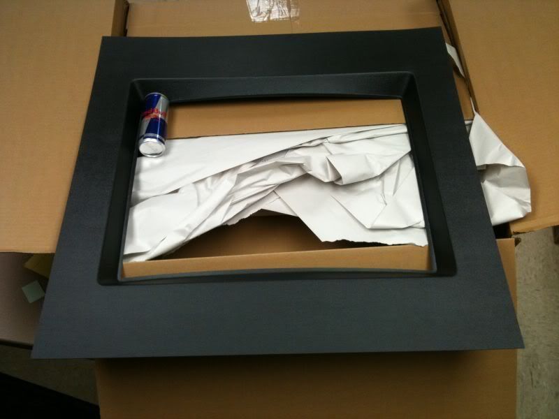

rayzor753 Posted March 3, 2011 Posted March 3, 2011 Received the screen bezel today from TwistedQuarter.com ( RedBull can for size comparison ) ______________________________________________________ battlenerds.com-Click here to check out Zac and My MAME Arcade Cabinet Project--Click here to check out our HS-NES Project-
ZacUSNYR Posted March 6, 2011 Author Posted March 6, 2011 So it was 45 degrees Saturday so I made Ray work on this thing. We got this large bezel and we have no clue how to mount the thing. Figured we'd cut it and then figure that out. First - let me say these things are cheap. The plastic cracks easy. BE VERY CAREFUL. We put a good size crack in it where it starts to form and I did an emergency super glue fixed. Then we were really cautious and how no more issues. Got it cut down and then had to figure out how to mount it. We're putting glass over the entire front and we're going to get the glass vinyled so only the screen/inside of the bezel is visible. So we figured we'd just pre-drill/screw it in with some flat top screws. You can't see it in the pictures but the curvature on the screen bezel was much greater then the curvature of the glass. So we used foam to fill up the gap - actually came out looking pretty good.

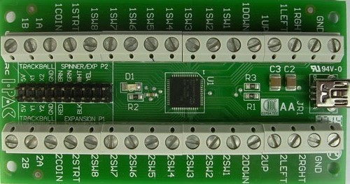

rayzor753 Posted March 7, 2011 Posted March 7, 2011 USB IPAC2 Ordered today for the control panel. http://www.ultimarc.com/ipac1.html ______________________________________________________ battlenerds.com-Click here to check out Zac and My MAME Arcade Cabinet Project--Click here to check out our HS-NES Project-

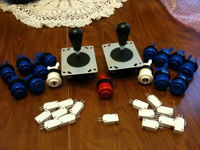

rayzor753 Posted March 17, 2011 Posted March 17, 2011 Buttons and Sticks ordered today from Ultimarc: J-Stik (Japanese) Oval Top (Sanwa JLW-UM-8 type) - in Black 12 Blue player Buttons (6 per side) and 1 red one to back out of games **(Update - ordered 3 black buttons for our TrackBall)** White 1P and 2P buttons ______________________________________________________ battlenerds.com-Click here to check out Zac and My MAME Arcade Cabinet Project--Click here to check out our HS-NES Project-

rayzor753 Posted March 23, 2011 Posted March 23, 2011 Received our buttons, switches, and joysticks yesterday ______________________________________________________ battlenerds.com-Click here to check out Zac and My MAME Arcade Cabinet Project--Click here to check out our HS-NES Project-
