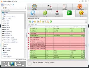

sreisig1 Posted June 3, 2014 Posted June 3, 2014 So I have some systems that aren't working correctly like sega saturn and a few others. When I open Hyperlaunch HQ, there are a few modules that are red. Is this because I need to update the modules? Once I update the modules to the latest versions will my systems launch correctly in Hyperspin? Where do I get the updated modules from? I have Daemontools installed correctly and some systems work fine with it. I'm also using the latest version of Hyperlaunch HQ v1.0.13.0
bleasby Posted June 3, 2014 Posted June 3, 2014 Where do I get the updated modules from? https://sites.google.com/site/hyperlaunch2/home/downloads When asking for help for RocketLauncher, POST ON THE RLAUNCHER.NET FORUMS! Also, please post your RocketLauncher.log with logging level set to troubleshooting in pastebin (set the log level in RocketLauncherUI, global system > General Settings -> RocketLauncher). Ass. Bleasby - RocketLauncher Development Team.
gigapig Posted June 3, 2014 Posted June 3, 2014 Some of the items in the modules section do show up in red anyway, like the Fix it Felix Junior script. It's possible that updating the module may fix your troubles, but really it could be any number of things. Post your logs if you still have a problem.
brolly Posted June 4, 2014 Posted June 4, 2014 Fix It Felix script isn't a module and therefore should have been tagged as such, I thought djvj already fixed this a while back, but now I realize he didn't. This will be fixed asap.

djvj Posted June 4, 2014 Posted June 4, 2014 Fix It Felix script isn't a module and therefore should have been tagged as such, I thought djvj already fixed this a while back, but now I realize he didn't.This will be fixed asap. The game scripts are fixed on git now and will no longer show up as modules. Sent from my SCH-I535 using Tapatalk "Computer games don't affect kids; I mean if Pac-Man affected us as kids, we'd all be running around in darkened rooms, munching magic pills and listening to repetitive electronic music."RocketLauncher's Official Home If you appreciate my work:My Apps:Window LoggerIdle Volume AdjusterExplorerRestorerRom Folder CleanerModule UpdaterMy Guides:How To Mod Guncons with Aimtrak

Krakerman Posted June 6, 2014 Posted June 6, 2014 Yes that fixed all my issues except for one PCLauncher. Still saying invalid ISD? Is there something that I need to do on my end to fix that or what?
sreisig1 Posted June 6, 2014 Author Posted June 6, 2014 Yes that fixed all my issues except for one PCLauncher. Still saying invalid ISD? Is there something that I need to do on my end to fix that or what? What fixed your issues? and what issues?
Krakerman Posted June 7, 2014 Posted June 7, 2014 djvj latest git update removed the game scripts but like I said .... PCLauncher remains highlighted red/pink saying invalid ISD?
