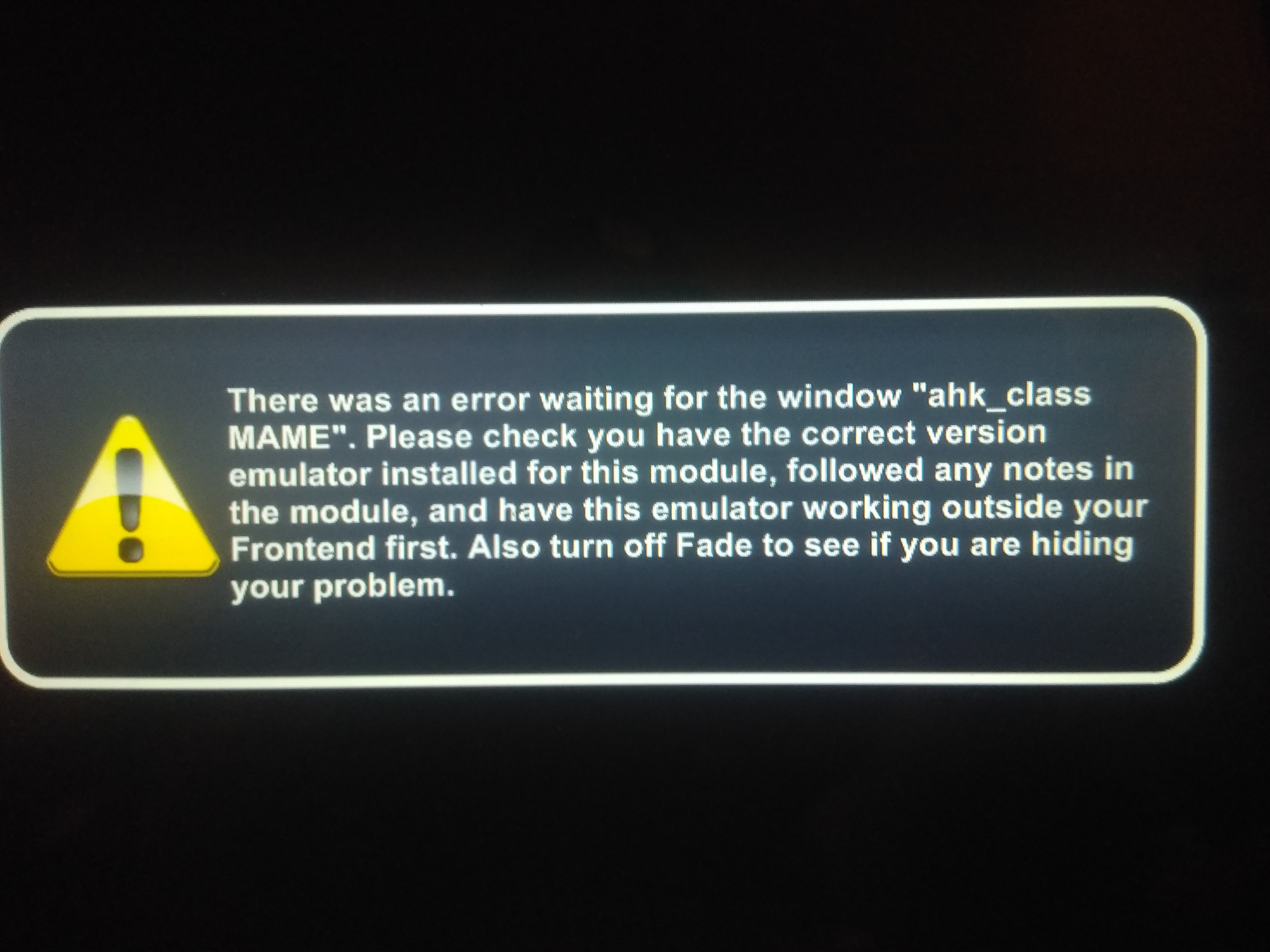

1969kappa Posted August 18, 2019 Posted August 18, 2019 Desperate man here been trying to get MAME running on hyperspin and RL I have followed a few guides with no luck I followed the one on Games room solutions word for word and I keep getting same results(see pic) I have even put new Hdd and booted windows 7 no luck back to windows 10 no luck then back to windows 7 if I had hair I would be pulling it out I get hyperspin running with videos and all that but when I click on a game just a long pause the the black box of death as I call it now pops up would be eternally grateful to the man/woman/child alien anyone who can help thanks in advance for anyone who views this post and thanks even more for responses. oh sorry running mame 0.212 and merged rom set 0.212 HyperSin 1.5.1 and rocketlauncher 1.2.0
Creezz67 Posted August 21, 2019 Posted August 21, 2019 On 8/18/2019 at 2:15 PM, 1969kappa said: Desperate man here been trying to get MAME running on hyperspin and RL I have followed a few guides with no luck I followed the one on Games room solutions word for word and I keep getting same results(see pic) I have even put new Hdd and booted windows 7 no luck back to windows 10 no luck then back to windows 7 if I had hair I would be pulling it out I get hyperspin running with videos and all that but when I click on a game just a long pause the the black box of death as I call it now pops up would be eternally grateful to the man/woman/child alien anyone who can help thanks in advance for anyone who views this post and thanks even more for responses. oh sorry running mame 0.212 and merged rom set 0.212 HyperSin 1.5.1 and rocketlauncher 1.2.0 In main settings, try setting "skip checks" in Rocketlauncher to "Rom Extension", as you are using a merged romset. Make sure 7z is set to false.
1969kappa Posted August 21, 2019 Author Posted August 21, 2019 I will give it go cheers and let you know and being cheeky if I downloaded Merged CHD's and software list ROMS merged and rom set where do these all go It's a bit head wrecking for a 50 year old man
alcoatjez Posted August 23, 2019 Posted August 23, 2019 It doesn't matter where you put the them. Just make sure that in the MAME => Emulators tab in RLUI both directories are added as ROM paths. Together with the advice from cataclysm67 you should get it working

Polemicist Posted September 28, 2019 Posted September 28, 2019 Ok... Just on a side note without watching the guides etc I got mine working entirely by using the standard 32 bit version of MAME and going into the global settings for the emulator and turning on legacy mode. I got the exact same error as you did. Now it runs perfectly. I will have to work out which legacy mode check box is the one that did it as I turned on 3 of the buggers at least... LOL And now I'm going through and figuring out how to clean up the mame.xml so that I don't have all the mahjong, fruit machine and adult games... *sighs* gonna be at this a while.
alcoatjez Posted September 28, 2019 Posted September 28, 2019 15 hours ago, Polemicist said: And now I'm going through and figuring out how to clean up the mame.xml so that I don't have all the mahjong, fruit machine and adult games... *sighs* gonna be at this a while. Just use phulshof's excellent MAME databases and rename the one you like to MAME.xml and you're all set
gigapig Posted September 28, 2019 Posted September 28, 2019 15 hours ago, Polemicist said: And now I'm going through and figuring out how to clean up the mame.xml so that I don't have all the mahjong, fruit machine and adult games... *sighs* gonna be at this a while. You could use one from here, Phulsof includes many many xmls.
