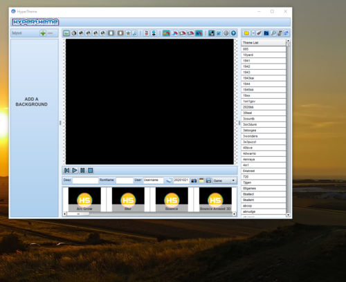

Shippo Posted October 21, 2020 Posted October 21, 2020 This fix fixed Hyperspin for me but not Hypertheme sadly. HyperHQ is also working. anyone knows a fix for this ?
Creezz67 Posted October 21, 2020 Posted October 21, 2020 5 hours ago, Shippo said: This fix fixed Hyperspin for me but not Hypertheme sadly. HyperHQ is also working. anyone knows a fix for this ? HyperTheme also works fine with this. Check you have it in the same folder as Hyperspin.exe
Shippo Posted October 21, 2020 Posted October 21, 2020 @Creezz67Â sadly no this doesnt work. I have it in the same folder as Hyperspin.exe and the dll File. Hypertheme doesnt open

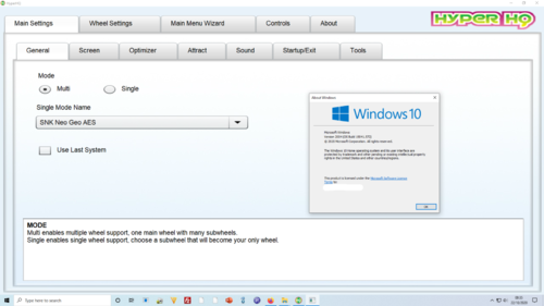

gigapig Posted October 21, 2020 Posted October 21, 2020 2 hours ago, Shippo said: @Creezz67Â sadly no this doesnt work. I have it in the same folder as Hyperspin.exe and the dll File. Hypertheme doesnt open I can confirm it does open with version 1.5.1.0 Â EDIT: However HyperHQ does not.
Creezz67 Posted October 22, 2020 Posted October 22, 2020 11 hours ago, gigapig said: I can confirm it does open with version 1.5.1.0 Â EDIT: However HyperHQ does not. FYI, HyperHQ also works perfectly on 1.5.1 on 2004 update, Windows 10 Home 64bit and also Windows 10 Pro 64bit
