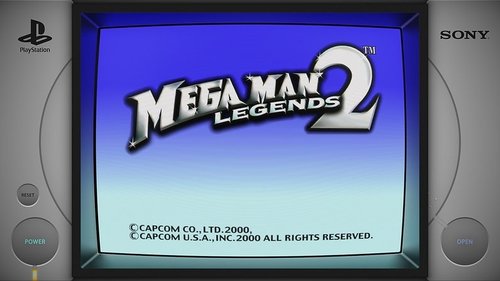

Spawk Posted February 12, 2022 Posted February 12, 2022 If there was a switch, it's news to me! If all things are equal, I use RA for everything I possibly can. There are still a few problematic cores though. Daphne is lacking sound in some games and I can't figure out how to set controls for example. The PS2 core is also just not as good as the stand alone performance wise. I guess whether or not you're "into" shaders is a big factor in which emulators you prefer. Maybe longtime users of "Reshade" don't mind using stand alone? But nothing is as easy as RA, and the HSM Mega Reflection Bezel is the best thing to happen to retro gaming since the invention of the FE itself! Still pictures don't really do it justice, have a look at the reflections in motion: There are literally hundreds of parameters to play with as well. You can make it look like pretty much anything you want. Seriously versatile.

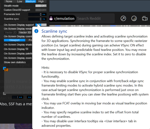

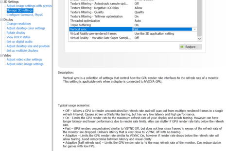

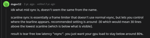

Aorin Posted March 13, 2022 Posted March 13, 2022 On 3/12/2022 at 9:27 PM, dark13 said: Generally input lag on RA is worse compared to standalone emulators, especially if you are not using Vulkan. GPU hard sync helps under gl/glcore but it takes cpu power and totally breaks timings on some cores. Basically RA is worse BUT run ahead makes it better The problem with input lag is generated by vsync, i'd really like to try a gsync or freesync rig... Expand I disabled V-Sync for basically everything, including PC Games. What made me do it was the Sonic 1 and 2 decompilation projects, alongisde Sonic 3 A.I.R, I noticed input lag in those and decided to disable V-Sync, but then, tearing occurred as I use a 1080p60 TV. I remembered checking this reddit post about getting lowering input lag on the SSF emulator and tried setting different numbers in those games and I noticed the gameplay improved a lot and the tearing was mostly unnoticeable, it would require a bit more try and error and maybe there's a way to get the best of both, meaning, getting rid of V-Sync that includes input lag and tearing at the same time. I also activated this option On 3/12/2022 at 9:27 PM, dark13 said: GPU hard sync helps under gl/glcore but it takes cpu power and totally breaks timings on some cores. Basically RA is worse BUT run ahead makes it better Expand Yeah, the way it works is not as direct as standalone emulators and those hard sync and latency options need fine tuning, sometimes even per game as some has greater native input lag than others. It's still hard to set each system individually back to standalone emulators, for me at least, but if I was constrained to a 4:3 CRT setup or cabinet, I'd totally go for standalones. I'm copying a bit from the reddit thread I mentioned, I believe you're familiar with what RTSS means, but in any case, it's RivaTunner Statistics Server, it comes bundled with MSI Afterburner. "So the input lag with SSF is insane (using latest test version) if you use vsync, but I tried using the scan line sync option from RTSS 7.2.0 (using -30 setting), and it appears to work very well. I disabled vsync in SSF and used full screen mode and now the input lag feels less than beetle saturn + vulkan. Playing games like Mega Man X4 is actually possible." With that, you can basically reduce input lag comparable to free sync monitors and "hide" the tearing, but requires fine tuning. Aorin
