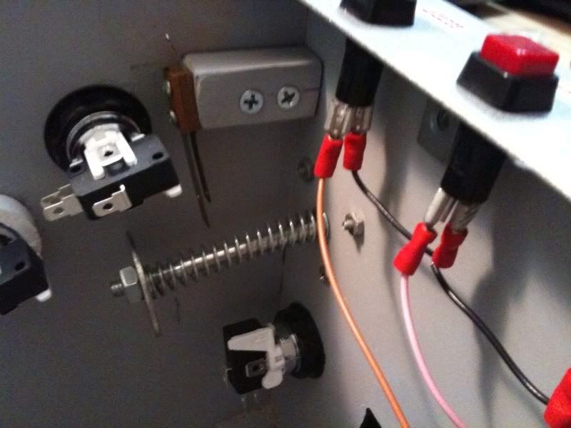

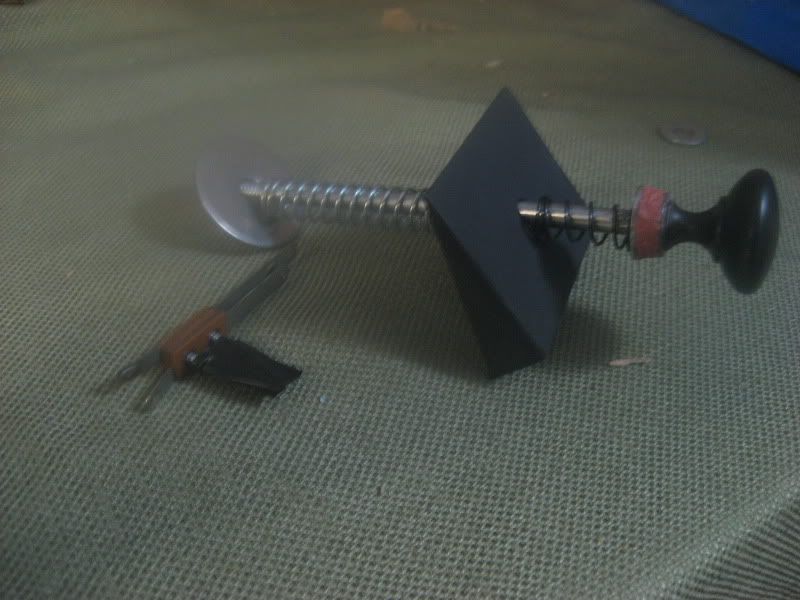

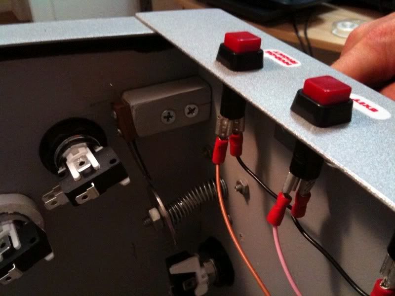

Dazz Posted October 10, 2011 Posted October 10, 2011 I'm pretty sure I'm one of the only people that's using an Optical Plunger.
blur Posted October 10, 2011 Posted October 10, 2011 You said some time ago that your first model broke and there was no components on the market any more. Did you made another one? How is it recognized by vp, as a z axis or you need some visual basic code in the table? My paper cab core.vbs with better nudge FPLaunch with exit menu, instructions, flyer VP with support for analog nudge and plunger with any gamepad www.submania.hr www.phoenixmarine.hr rent-a-boat-rab.com bootsvermietung-rab.com
Dazz Posted October 10, 2011 Posted October 10, 2011 You said some time ago that your first model broke and there was no components on the market any more. Did you made another one?How is it recognized by vp, ss a z axis or you need some visual basic code in the table? No, my first model still works... It's just the components that were used are obsolete and I haven't been able to really determine the new components. It just works like a normal NO microswitch. It's only an on/off switch, but there are no physically touching parts.
