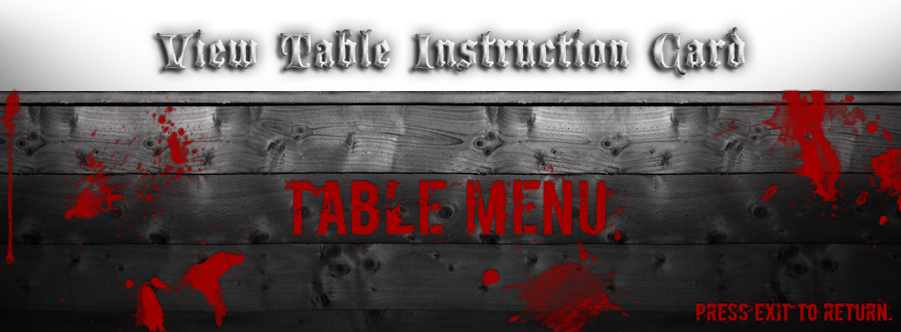

freezy Posted November 25, 2012 Author Posted November 25, 2012 Fiddled around with "menu branding". I suppose you guys can guess what the theme of the pin will be However, does anyone know how overload the principal Exit/Shutdown menu? Those images aren't in my HyperPin/Media/HyperPin/Images folder. Any hints appreciated!
freezy Posted November 25, 2012 Author Posted November 25, 2012 The pics you made are put into: C:\HyperPin\Media\HyperPin\Images and with that "overrule" the standard menu. Yeah those I got, but what about the Exit/Shutdown/Back menu when you start up HyperPin? Nothing like this in the folder you've mentioned.

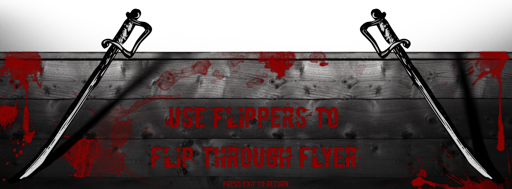

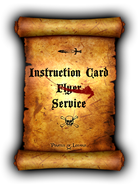

freezy Posted November 25, 2012 Author Posted November 25, 2012 Thanks! Here's a first version of the apron (sized it down from 600dpi): So, how about the HyperPin exit menu?

freezy Posted November 26, 2012 Author Posted November 26, 2012 ---Quote (Originally by freezy)--- The exit menu when you press ESC in HyperPin ---End Quote--- In this version of Hyperpin you *DON'T* use ESC, but you got to remap to "E" (reed the topic!!!) And perhaps the names of your self made pictures have to be the same names of the pictures in the package. Okay. Again. I'm not talking about the loading screens or the menu screens before/when playing a table. I'm talking about the menu screen that is displayed when you are in HyperPin while quitting HyperPin, if that's ESC or E or whatever mapping is completely irrelevant. My mind is completely capable of making a reference between a file name and an image, but the problem is that those images aren't there, hence no reference. And if it's still not clear, I'm not talking about the images I've posted. So again, my question: For those specific (three) menu screens (not the others!), is there any other place, or are they compiled into HyperPin? And if so, is there a way to overload them?
mikekim Posted November 26, 2012 Posted November 26, 2012 As far as im aware they are hard coded into the program. Sent from my mind, using the psychic friends network..
freezy Posted November 26, 2012 Author Posted November 26, 2012 Thanks Mike. And if I'm not mistaken, HyperPin isn't open source, right? And it wouldn't look at a magical place for potentially overloading images.. Cheers!
Aurich Posted November 26, 2012 Posted November 26, 2012 It's possible there's a "secret" image name that you can use to override it, like you can with the wheel image. That doesn't have an image in the folder either, but if you put "underlay.png" in there it works.
freezy Posted November 26, 2012 Author Posted November 26, 2012 Oh, nice. I'll open hexedit and have a look at the binary then Cheers!
freezy Posted November 26, 2012 Author Posted November 26, 2012 This is actually kinda fun. I really like painting blood stains Didn't figure out how to replace the root exit menu though. Maybe I'll have some blind tries tomorrow...

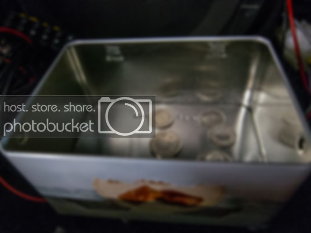

freezy Posted December 5, 2012 Author Posted December 5, 2012 Updated the first post with the link to the SKP file. Finally a few details ended up differently than the original plan, mainly the monitor suspensions. Maybe I'll update the plan and model to reflect the real deal one day. Recently I added the cable for the electronic coin rejector, and it works. Really nice, you just put a coin into the holder on the backside and it'll verify all coins against that coin. Then I ordered some magnets (love that site!) and glued some to a bunch of spare PCB feet: Now the "treasure chest" perfectly glues into the cab and is easily removable. But no, the cab is not quite yet finished. Basically, what needs to be done is: Get the damn PBW accelerometer working (probably gonna ditch it for the U-HID+G) Get the artwork finished and printed Software tweaking. Once a table started it's good, but FP makes HP freeze on exit and even some VP tables just freeze or go into super-slow-mode. Seems like a real PITA. But still, very playable!
DeeGor Posted December 5, 2012 Posted December 5, 2012 Nice idea with the coin bucket. I may end up doing that as well. Awesome job with your build Freezy.
Aurich Posted December 5, 2012 Posted December 5, 2012 I'm using magnets to hold in my coin bucket too (a mini loaf pan) but I was going to just glue them straight to the bottom of the cab. Not sure if I have the clearance to raise them up on PCB feet, but that's a clever idea, makes things easier if you need to remove them for any reason.

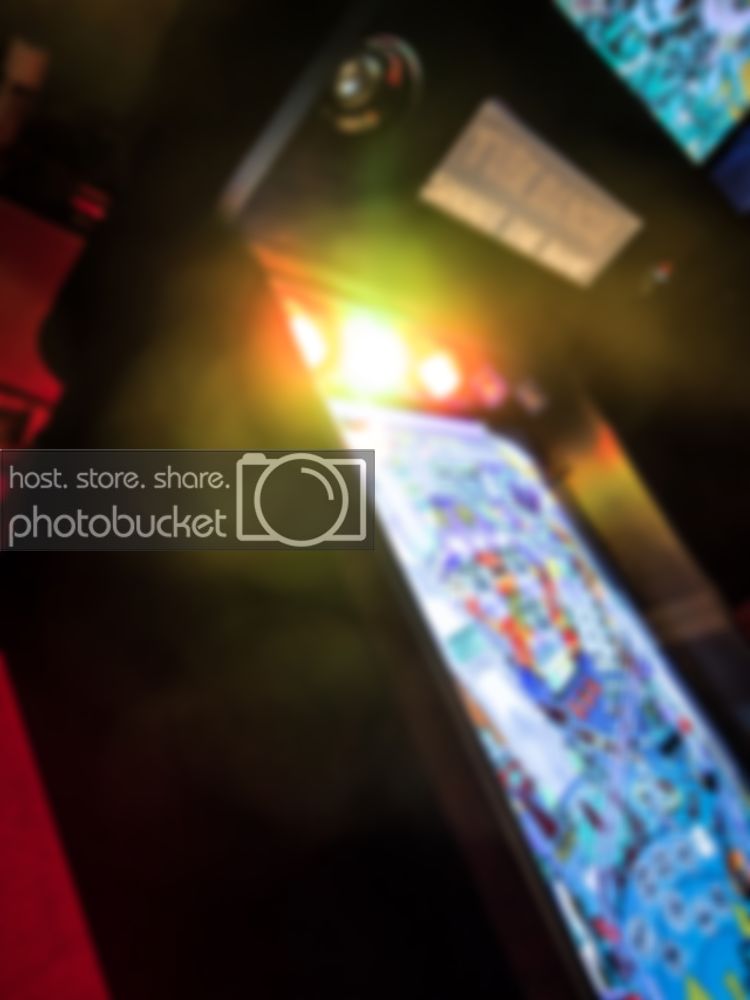

kizam33 Posted December 5, 2012 Posted December 5, 2012 nice work, how do you like the flashers by the screen? do they bug you while you're playing ?
freezy Posted December 5, 2012 Author Posted December 5, 2012 nice work, how do you like the flashers by the screen? do they bug you while you're playing ? Wouldn't want to miss them!

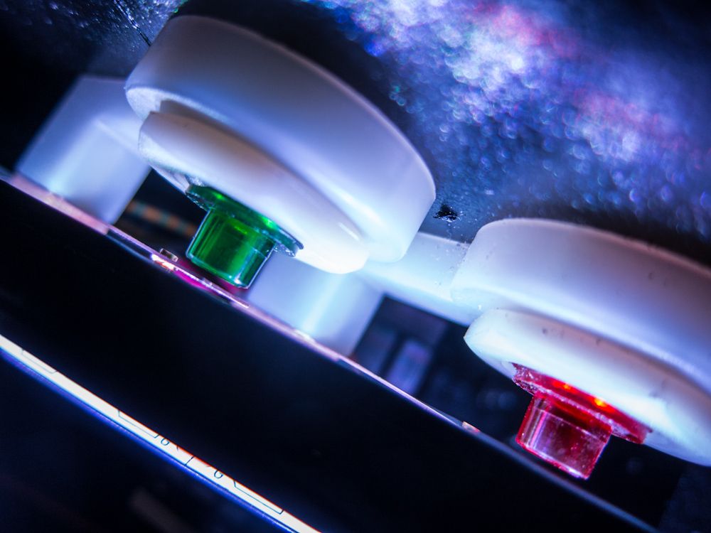

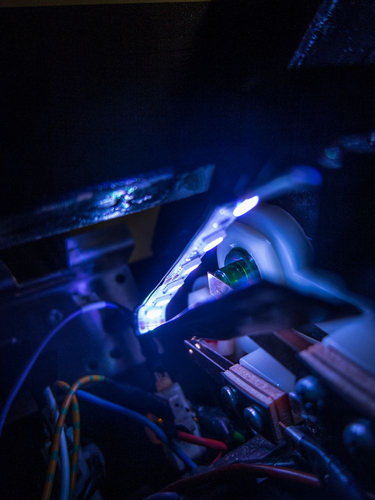

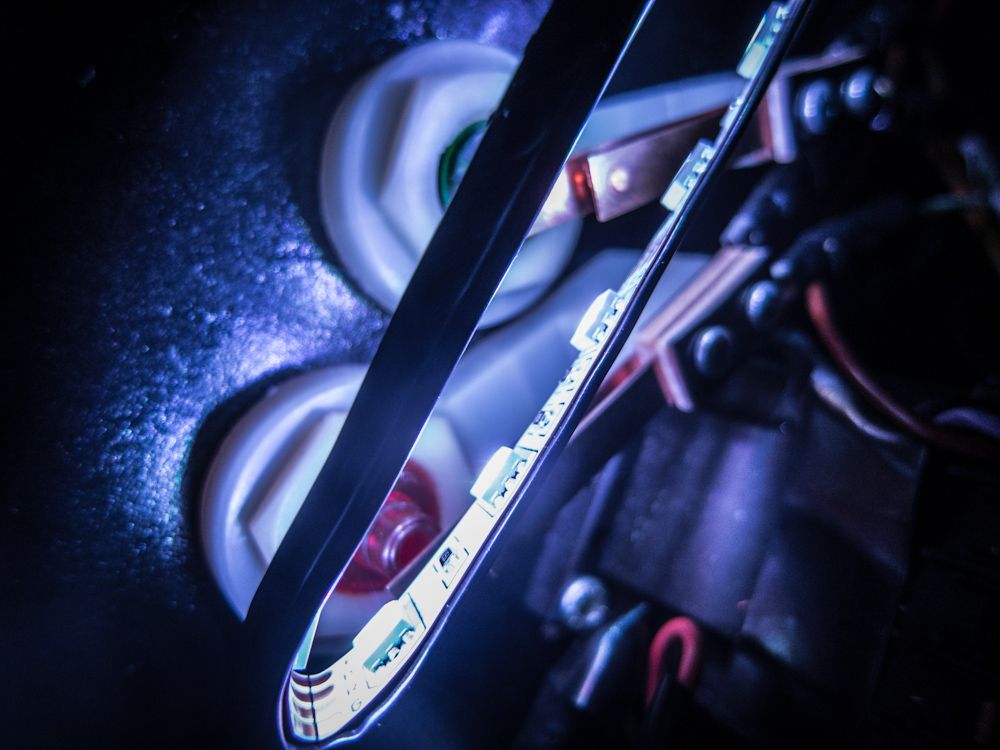

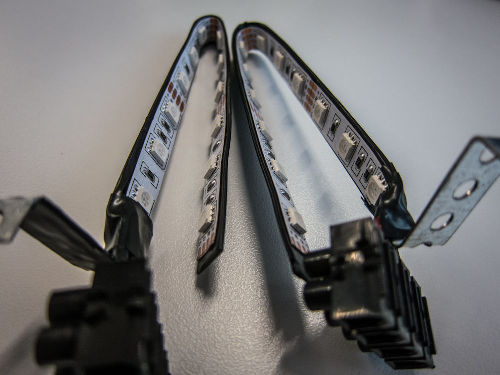

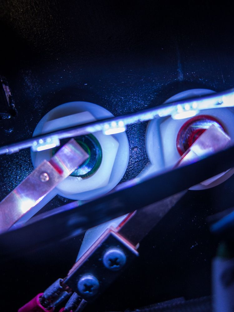

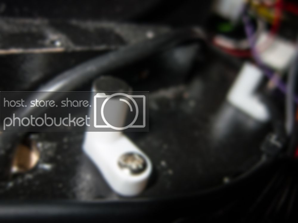

freezy Posted December 14, 2012 Author Posted December 14, 2012 So this week I got a new set of flipper buttons. Couldn't find white translucent pairs at 1-7/8", so I went for a pair of green and a pair of red transparent buttons. Mounted them and the play nice! Now about the illumination behind. I actually still have no idea how people illuminate their flipper buttons, because the leaf thingie and screw nut cover nearly everything of the button and just on top is the contact, so the light has to come from the sides somehow. Since I had still rests of the RGB LED strip, I've improvised some kind of lamp: So they're supposed to surround the back of the flipper buttons. Success was moderate. The red button is lightish while the green looks more solid than illuminated. Will try to put some aluminium foil around those clamps to put more light on the buttons. Then I got a UHID-G and an IPAC VE. Perfect timing since the Mot-Ion kit just went belly up. Either I'm unlucky or this is some incredibly bad piece of hardware, calibration nightmares aside. The IPAC works as expected like a charm. With the UHID-G I played around a little. I calibrated it while mounted in the cab by shaking the cab during the Windows game controller calibration thing. Then I used the UHID config tool to move the cross into the center. In VP I'm at 300% gain and 30% dead zone. Still have to nudge quite hard to see an effect and there seems to be a delay. If anyone else has tips, let me know, otherwise I'll try some more. Also, since more and more tables went into "slow-motion mode", I've downgraded the Nvidia driver and that seems to have solved that problem (WTF?). There was also some progress with the artwork, I hope that I'll be able to show something next week
Aurich Posted December 14, 2012 Posted December 14, 2012 I'm using these for my flippers: http://groovygamegear.com/webstore/index.php?main_page=product_info&cPath=73&products_id=238&zenid=hbf3sfe1jtsanthcmd6pi08lh6
mikekim Posted December 14, 2012 Posted December 14, 2012 I'm using these for my flippers:http://groovygamegear.com/webstore/index.php?main_page=product_info&cPath=73&products_id=238&zenid=hbf3sfe1jtsanthcmd6pi08lh6 I have a couple of sets of those (both true-leaf and micro leaf)and to me they just dont feel the same as proper leaf springs.. guess its just down to personal preference. Sent from my mind, using the psychic friends network..
freezy Posted December 14, 2012 Author Posted December 14, 2012 Thanks for the info, guys. Now you're mentioning it, I've seen those from groovegamegear, but for those I would need to re-drill. Also I'm quite fond of the way they play (however I must admit I've never tested the other ones). It's already better than nothing, they're just not as bright as the other arcade buttons. Let's see if the aluminium foil can boost the light a bit more. BTW, this is my 100th post! Can I post pics without being moderated now?
