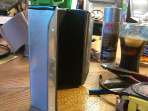

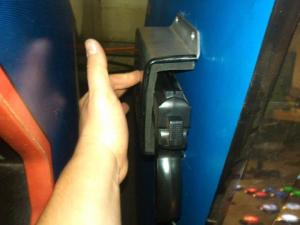

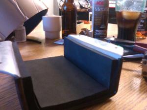

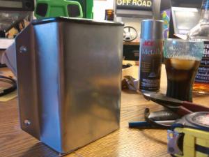

sparky1821 Posted August 30, 2012 Posted August 30, 2012 Here is an example of our first complete gun holster for my Hyperspin arcade cab! It was a 2 month design/concept build This is a piece of 1/4 aluminum bent to specifications, trimmed, and mounting holes drilled 3/8's neoprene foam rubber with adhesive backing added to the inside area to protect the plastic of the gun 1/4 pneumatic air tubing, cut and molded to the front to protect the gun while it rests against the holster painted with chrome paint If anyone is interested, Im thinking about mass producing these, and selling them for somewhere in the neighborhood of $95.00 bucks for a set of two, (price subject to change) post here if you would be interested! Thanks for the suppot Sparky

sparky1821 Posted August 30, 2012 Author Posted August 30, 2012 I totally understand the price seeming high, We've been doing some estimating...and unfortunately were at about 38 bucks just for the materials...not including the 3 hours to put them all together ...
djvj Posted August 30, 2012 Posted August 30, 2012 I understand, but they do look hand made from the pics you posted. So to charge such a high amount, for what is essentially a bent piece of metal with some padding stuck on, seems a bit inflated. The pics you posted, the metal looks scratched, and the edge molding isn't even on straight. I would think if you are going to charge almost $100 for something, it would look amazing and not home made. "Computer games don't affect kids; I mean if Pac-Man affected us as kids, we'd all be running around in darkened rooms, munching magic pills and listening to repetitive electronic music."RocketLauncher's Official Home If you appreciate my work:My Apps:Window LoggerIdle Volume AdjusterExplorerRestorerRom Folder CleanerModule UpdaterMy Guides:How To Mod Guncons with Aimtrak

7m-gtte Posted August 30, 2012 Posted August 30, 2012 Also you probably don't want gun holders that let the gun rub against the side of the arcade.

sparky1821 Posted August 30, 2012 Author Posted August 30, 2012 Triple the price of happ holsters??? Check your math they want 60-120 bucks for 2 holsters, i know the price is high for some, that's fine, no one has to buy these, I thought I would just be nice and offer to build some if anyone was interested, and this is just the first prototype, future ones will be more spot on, I'm surprised by the high level of thread crapping, Im not set on making anymore anyways unless the materials and labor are paid for, I'm more than happy just making two for me
sparky1821 Posted August 30, 2012 Author Posted August 30, 2012 And even though these will be painted again to fix the minor blemishes, I think some of the "homemade" looks of it are what make it stand out in a positive way, just my opinion, I don't want everything on my cab to be cookie cutter machine made and I think these are a nice personal touch
Drkdweller Posted August 30, 2012 Posted August 30, 2012 ok checked math, you were right. I forgot it was a "pair". With my comment i was just pointing out that, when you DIY you have that personal acomplishment feeling or as you ike to put it "I think some of the "homemade" looks of it are what make it stand out in a positive way", hell there's parts on my cab that people look at and are like WTF? i reply it gives character, im pround of the bumps and scratches. However, maiking something for someone else, there going to want perfection. That being said, since there is no personal gratification, if your going to buy something why not buy the cheaper, It may not have quality but looks good premade item. I ment no disrespect, sorry if i crapped on you.

Fursphere Posted August 30, 2012 Posted August 30, 2012 You should have them stamped instead of bent. In China. I used to get stuff done a lot more complex than that a hell of a lot cheaper - from a local guy in Hayward, CA. Including powder coating and silk screening. Although adding chrome to anything is stupid expensive these days.

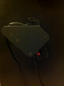

rdhanded2 Posted August 30, 2012 Posted August 30, 2012 pongo334 said: Here is a crappy pic of my Gun holster.[ATTACH=CONFIG]19916[/ATTACH] Nice. What did you use? My Tekken 3 pedestal conversionBasement Bar / Arcade

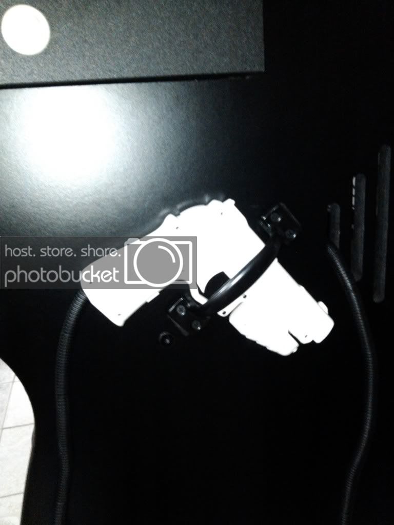

Trnzaddict Posted August 30, 2012 Posted August 30, 2012 Here are mine. Black shed door handles @ Home Depot. 5 bucks. I am......Machine
rdhanded2 Posted August 31, 2012 Posted August 31, 2012 We might have a winner there!! Cheap and looks good. My Tekken 3 pedestal conversionBasement Bar / Arcade
djvj Posted August 31, 2012 Posted August 31, 2012 There ya go, that is the price I like and works! "Computer games don't affect kids; I mean if Pac-Man affected us as kids, we'd all be running around in darkened rooms, munching magic pills and listening to repetitive electronic music."RocketLauncher's Official Home If you appreciate my work:My Apps:Window LoggerIdle Volume AdjusterExplorerRestorerRom Folder CleanerModule UpdaterMy Guides:How To Mod Guncons with Aimtrak

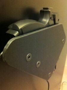

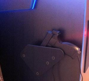

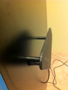

pongo334 Posted August 31, 2012 Posted August 31, 2012 rdhanded2 said: Nice. What did you use? A piece of textured HDPE from MaMaster-Carr (9785T112 $10) it will do two. Some tapered bolts and some rubber tubing. the tubing goes over the bolts to protect the gun. and they double as a standoff. Here are some more pics.
Circo Posted August 31, 2012 Posted August 31, 2012 pongo334 said: A piece of textured HDPE from MaMaster-Carr (9785T112 $10) it will do two. Some tapered bolts and some rubber tubing. the tubing goes over the bolts to protect the gun. and they double as a standoff. Here are some more pics. [ATTACH=CONFIG]19922[/ATTACH][ATTACH=CONFIG]19923[/ATTACH][ATTACH=CONFIG]19924[/ATTACH] That right there is a beautiful solution! ___________________________________ HyperSpin Website Admin Team Also Visit EmuMovies.com
Fursphere Posted September 2, 2012 Posted September 2, 2012 Circo said: That right there is a beautiful solution! Looks like you can't "Grab" the handle though, to pull the gun out of the holster. Its a very nice way to store the guns, but looks a tad cumbersome to get them tou.
