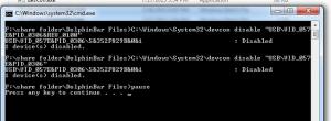

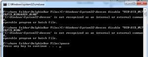

epayson85 Posted July 17, 2015 Share Posted July 17, 2015 amazing... works perfectly! Thank you! Link to comment Share on other sites More sharing options...
epayson85 Posted July 17, 2015 Share Posted July 17, 2015 ok I spoke a little too soon haha so it works if I run it outside of hyperspin / hyperlaunch. However, when I use it in hyperspin it doesn't work. I could see that the batch was running so I added a pause to it so I could see what the command line was saying. For some reason it runs differently when being run from hyper launch. I attached a working.jpg which is running it manually and a not working.jpg which is when hyper launch runs it. I honestly cant figure out why hyperlaunch would be causing this. Any ideas? Link to comment Share on other sites More sharing options...
epayson85 Posted July 17, 2015 Share Posted July 17, 2015 ok I got it. Still don't understand why... but I got it lol. I got ride of the "C:\windows\system32\" from the batch files so it now runs devcon from the root directory. Now it runs just fine and the games are launching perfectly. I don't know if devcon still needs to be in system32 folder as well or not but I am leaving it there haha. Link to comment Share on other sites More sharing options...
