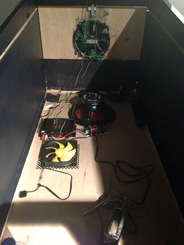

Aurich Posted December 18, 2012 Author Posted December 18, 2012 Hi Aurich,I did not know that we can split the sound in VP. Is it something you do in the settings? Yeah, any version from 9.14 on works, don't need a daily build or anything. Keep in mind that means you need two amps etc, it's utterly separate. So what I'm doing is routing the cabinet sounds from VP to a little enclosed 8" sub box and a couple 4" mids under the TV, and then the ROM sounds to a 10" sub in the back of the cab and the 4" speakers in the DMD panel. Both powered by little cheap Chinese amps. So cheap the crossovers don't work for the sub, so I hardwired in my own. You can see one of the amps, the crossover, and the 10" sub in the back here:

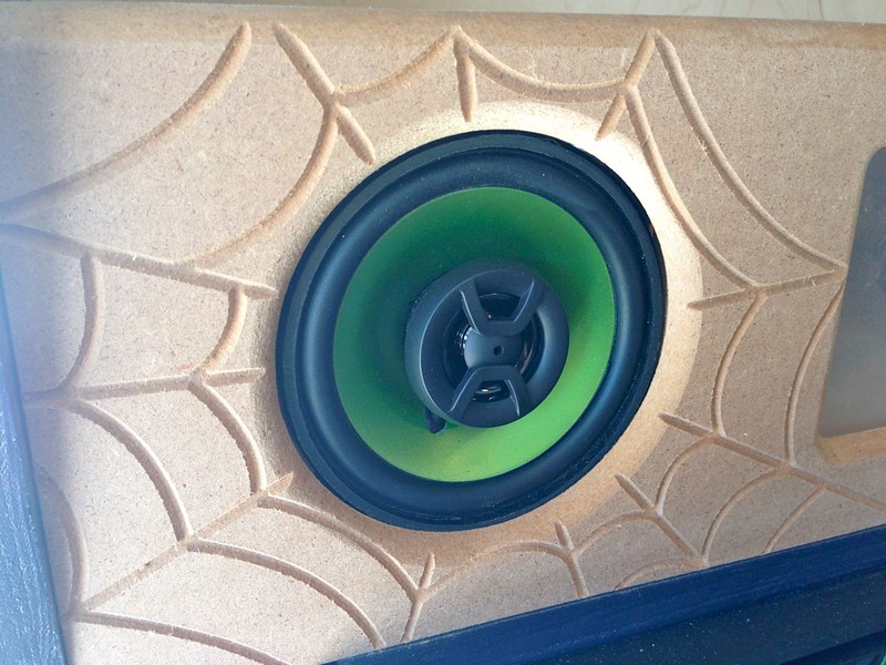

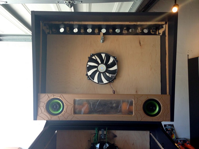

Aurich Posted December 19, 2012 Author Posted December 19, 2012 No worries, let me know if you have questions. Got a package today from mameman! (The speakers are just lying in place with weights behind them to hold them up if they look a little off.) Already put down a first coat of Rustoleum primer, will start sanding and cleaning up the MDF fuzzies once that's nice and dry before I put on the basecoat. Then it's time to start masking and playing with some candy airbrush paint.

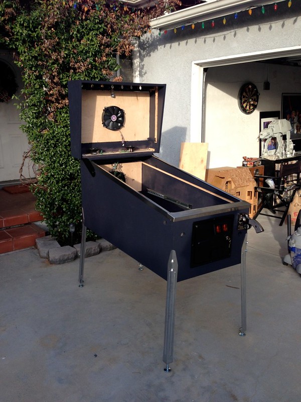

Aurich Posted December 23, 2012 Author Posted December 23, 2012 So, down a DMD temporarily, but some progress anyways:

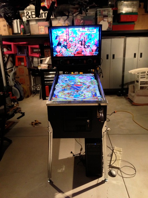

Aurich Posted December 27, 2012 Author Posted December 27, 2012 Got zebulon's latest booster boards, going to drown my DMD sorrows in wiring. Also, will try to not fry anything in the process!
Aurich Posted January 14, 2013 Author Posted January 14, 2013 Still wiring, no real photo updates, but zebulon's booster boards are awesome, and his customer service is really excellent too. Highly recommended! I'm in the middle of painting the spiderwebs on the DMD panel too. Work and real life have just invaded all my build time lately. Plus the garage is much colder now, which saps my motivation to work at night!
