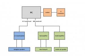

Pinball999 Posted January 7, 2014 Author Posted January 7, 2014 So.. there has been a bit of progress on the Shaker side. I've received two 4 ohms bass shakers (Bass Bump III) last week and made a quick test with a normal amp. First impression, it's great to feel the ball falling on the playfield from the ramps or bouncing on the lanes bumpers. I was like a child discovering a new toy.. And it works perfectly in parallele with my contactors. But.. the Bass Bump act like a speaker, and therefore reproduce all sounds in a pretty bad quality if not properly filtered by a sub amp. So I'm now waiting for this to be delivered: http://www.amazon.de/gp/product/B009GKBJHI/ref=oh_details_o00_s00_i00?ie=UTF8&psc=1 More info to come!
Pinball999 Posted January 10, 2014 Author Posted January 10, 2014 Everything is installed! Here is more or less the content of a message I've posted on VPF: I've finally managed to correctly install my bass pumps III in the cab and played a few tables. At the moment, the mechanical sounds are splitted and sent a small amp connected to a good HC center speaker, and to a subwoofer amplifier connected to the bass Pumps III. This allows to adjust the volume and the "shakes" separately. If the effect is great on some tables (like T2 or Cirqus Votaire), you have to be prepared to spend a lot of time tweaking all the tables with sounds with too much low frequencies (TAF Gold, or T3 i.e.). For these last tables, the shakers are kicking too much and make the all cab rattling. For the plus: -Better immersion on tables with good mechanical sounds (you can really feel the ball bumping everywhere) -Could replace the contactors if you don't want to use both (my preference goes to the contactors though) -Works great in parallel with contactors as the feeling between the systems is different. For the cons: -A lot of tweaking in perspective to find the best sounds -If used too strong, the shakers can cover the contactors and you can't perceive anymore which one of them is triggered. What I'm planning to do is to make a selection of all the sounds working best in my tables, and import them to the problematic ones. I will also use an audio software to adjust these sounds to my liking and get the best frequencies to work with the shakers. Alternative and quick options are: Switching the sub amp off in case the bass are too strong Use the feature in VP to deactivate some sounds (like bumpers or slingshots for instance). The contactors would be there to still hear and feel these sounds. Another thing on the to do list is to learn how to add ball rolling sound to the tables where it's missing. Once you have tested it, you don't want to go back I would love to hear from other users with this kind of setup, especially if someone can compare two types of shakers like in the link below. And here is a small schematic of the setup:

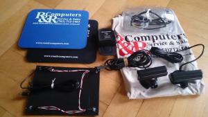

Pinball999 Posted January 18, 2014 Author Posted January 18, 2014 Got the HT kit from Randr. Time to install it and play with some FP tables!

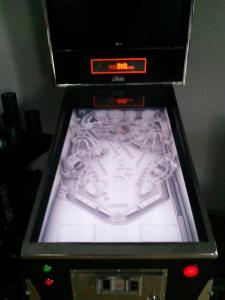

Pinball999 Posted January 19, 2014 Author Posted January 19, 2014 After a quick setup: Thanks to Ravarcade for bringing BAM to us. Hopefully, it will be used later in other pin simulations!
mouse Posted January 20, 2014 Posted January 20, 2014 That video looks soooooo real!!! I have kept a Kinect stashed in the closet for exactly the intent of running BAM.
Pinball999 Posted January 22, 2014 Author Posted January 22, 2014 mouse said: That video looks soooooo real!!! I have kept a Kinect stashed in the closet for exactly the intent of running BAM. Please keep in mind that you will achieve better results with the PS3 cams. But it should help you to get a good idea of the feature.

Pinball999 Posted February 5, 2014 Author Posted February 5, 2014 Hi potts43, You can get all details on the BAM's official web page. But basically, it will be: PS3 cams, Kinect or Wiimotes A calibration board A powered led to attach to a cap or glasses. But randr can also provide you with everything you need for a very good price: http://www.vpforums.org/index.php?showtopic=25606&page=1
