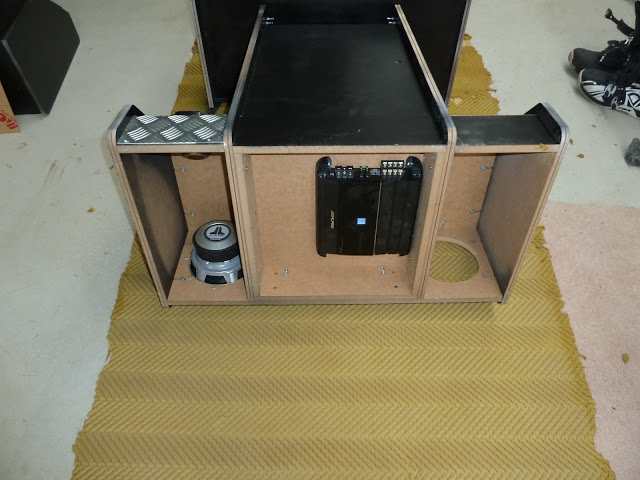

Got a bit more done last night. Mounted the amp and one of the subs to start.

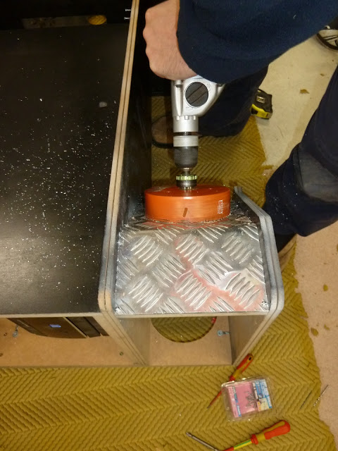

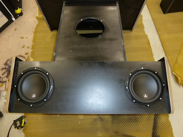

Then I worked on the right hand checker plate, speaker and sub.
Changed from Alpine to JL subs. The 10's were a little too big for the cabinet so got some 8 inch JL's instead.
Anyone want to buy a couple of Alpine 10's ? :D
