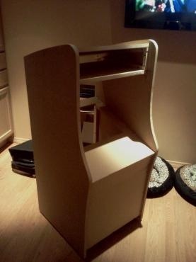

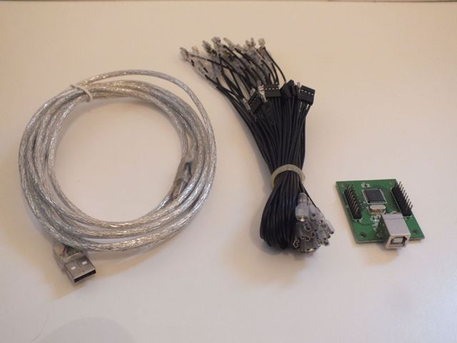

monkeychunkuk Posted December 30, 2012 Posted December 30, 2012 Soo like many others ive got the cab building bug. As the new years start I'm going to start my second project,this time I'm going to build a scaled down full size cab like this Im going go with custom Star Wars theme And i hope to avoid the mistake's from my first build,like fitting better buttons and thicker Mdf so i can fit T-molding and instead of painting the wood I'm going to laminate it and apply vinyls to showing parts. Im also going to do a full shell with no trace of windows,oh and im fitting the reset buttons on the back i keep turning my machine off by mistake As always i need advice, Im always on the look out for cheap motherboard bundles and Hard drives So please post your links Where can i get hold of cheap non wide screen monitors in the uk? Can anyone recommend a cheap amp? to use with a set of speakers i have. Has anyone fitted one of these instead of ipac? Any problems? Link here http://www.ultracabs.co.uk/usb-2-joystick--22-button-arcade-control-kit-71-p.asp Anyone got any cool star wars themes Going spare ; ) (Cough cough Mike)

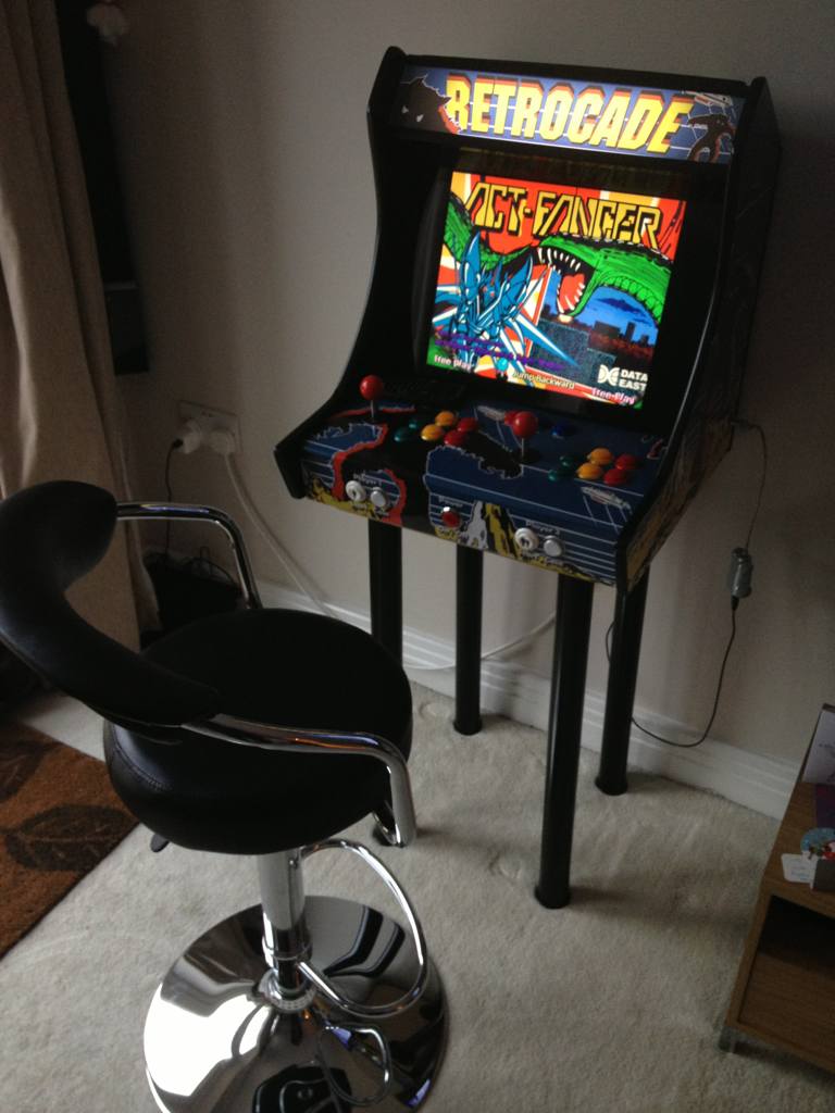

monkeychunkuk Posted December 30, 2012 Author Posted December 30, 2012 jq_quint said: I'll be interested to see how this progresses. Its great your making comparisons to what improvements you will make since your last build, it will certainly help novice builders like myself... where possible state what the exact improvements are i.e instead of these buttons (link) i'm opting for these....like i said big help to someone like myself... Anyway back to the build, so is this a sit down and play unit being scaled down monkey? Kinda im just going to add a bottom half to the template i have for my bartop as you can see its sits on a little table i made, it will be nice not to have to fight for space in the new cab

monkeychunkuk Posted December 30, 2012 Author Posted December 30, 2012 mikekim said: how about a Lego Star Wars theme??? - give me some dimensions and I'll have a play.. Hmmm to be honest i wasnt keen on the idea but thinking about thats sounds great!! The cp and marque are the same dimensions as the Retrocade,to save cash I'm going black on the side art!! But i may change my mind ; ) Side art will be 19inch wide 48 inches tall The only real difference is the front panel/kick board which will be 19inch wide 30inch tall Would love to see anything you doodle ; )

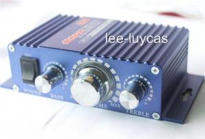

monkeychunkuk Posted December 31, 2012 Author Posted December 31, 2012 Anyone used one of these amps off ebay
mameshane Posted December 31, 2012 Posted December 31, 2012 monkeychunkuk said: Anyone used one of these amps off ebay[ATTACH]22765[/ATTACH] i have just ordered an almost identical one from this site havent got it yet will let you know how it goes once i get it. My Cab.. 1-UP ARCADE new hyperspin irc details.. come hang out!
Chidy Posted December 31, 2012 Posted December 31, 2012 Looking forward to this! I've used that same encoder a few times now and it seems to do the job just fine, however it can be tricky mapping exit keys inside modules/ini files as opposed to the iPac.

monkeychunkuk Posted January 1, 2013 Author Posted January 1, 2013 Chidy said: Looking forward to this! I've used that same encoder a few times now and it seems to do the job just fine, however it can be tricky mapping exit keys inside modules/ini files as opposed to the iPac. Hmmm thank you for the feed back not sure i need the hassle of messing around with it when the ipac was easy to use
RidicRick Posted January 1, 2013 Posted January 1, 2013 Im steering away from the ipac now and starting to go with something very similar to what you have there from Paradisearcadeshop called Xin Mo's. Found here. They are much quicker to hook up since all the wiring comes with, super easy and programming the buttons has been perfect also. I still like the ipac, but these little controller boards have been working awesome for me. monkeychunkuk said: Has anyone fitted one of these instead of ipac? Any problems? Link here http://www.ultracabs.co.uk/usb-2-joystick--22-button-arcade-control-kit-71-p.asp Anyone got any cool star wars themes Going spare ; ) (Cough cough Mike)
monkeychunkuk Posted January 1, 2013 Author Posted January 1, 2013 Great price to,thanks fir the feedback,if the ipac uses a program, what do you use to set these up?
richie_jones Posted January 1, 2013 Posted January 1, 2013 mameshane said: i have just ordered an almost identical one from this sitehavent got it yet will let you know how it goes once i get it. I have something very similar, you may have to ground the casing to your motherboard if you suffer from interference...
mameshane Posted January 1, 2013 Posted January 1, 2013 richie_jones said: I have something very similar, you may have to ground the casing to your motherboard if you suffer from interference... How do I do that? My Cab.. 1-UP ARCADE new hyperspin irc details.. come hang out!
richie_jones Posted January 1, 2013 Posted January 1, 2013 Make up a wire with a crimped hole connector on each end, remove a mounting screw from your motherboard and screw back down with one end of your wire under. Scratch some paint off the amp mounting point and clamp the other end under the amp mount screw, basically connecting the amp casing to ground...sry for the crap explanation..
monkeychunkuk Posted January 1, 2013 Author Posted January 1, 2013 richie_jones said: Make up a wire with a crimped hole connector on each end, remove a mounting screw from your motherboard and screw back down with one end of your wire under. Scratch some paint off the amp mounting point and clamp the other end under the amp mount screw, basically connecting the amp casing to ground...sry for the crap explanation.. Great advice i had that problem with my retrocade,i wonder if the volume controls can be relocated to the outside of a cab ?
