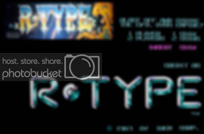

gargoyle67 Posted January 23, 2016 Posted January 23, 2016 I'm looking for the current one "wheel art" then when I'm playing the game on mame to display the marquee of the game aka this> then this> Obviously closing the first one before displaying the second one. Thanks.

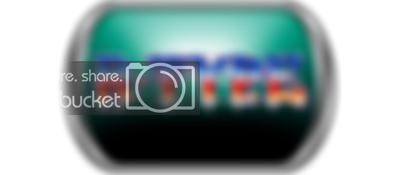

gargoyle67 Posted January 23, 2016 Posted January 23, 2016 I've got the Marquee topper working but I want it to display only when playing the rom\game, it runs at the same time as the wheel art though.My Hypermarquee details are >E:\HyperSpin\Emulators\[system]\marquees\[FileName].png
sevenseal Posted January 24, 2016 Posted January 24, 2016 I've got the Marquee topper working but I want it to display only when playing the rom\game, it runs at the same time as the wheel art though.My Hypermarquee details are >E:\HyperSpin\Emulators\[system]\marquees\[FileName].png in eds on event tab, select only 4

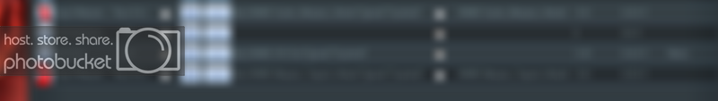

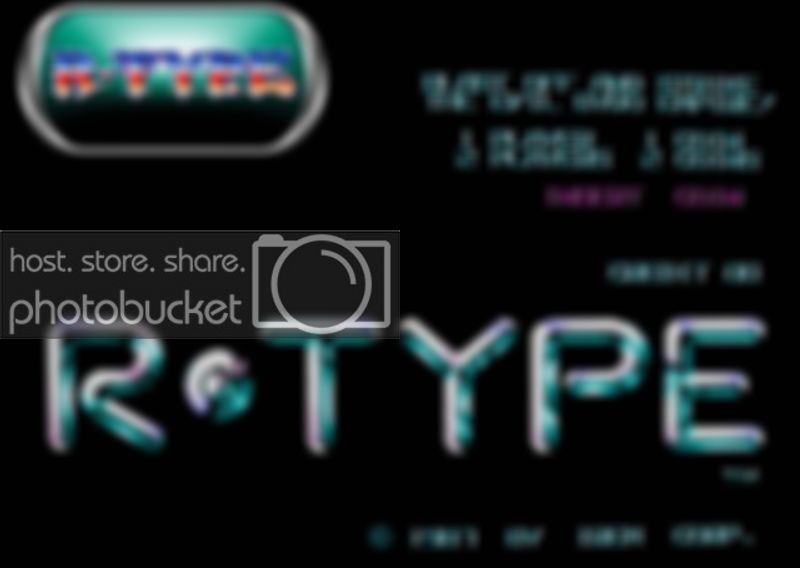

gargoyle67 Posted January 24, 2016 Posted January 24, 2016 I've not been able to close my wheel image when the game starts, I've tried adding a 4 on the close filter ? as suggested but I still get this in game> This is what I'm trying to get in game when running both pipes> And then close the above topper art when the game shuts down to hyperspins wheel art. If I run both pipes both images appear. My eds settings (disregard the disable checks> Ty.
sevenseal Posted January 24, 2016 Posted January 24, 2016 I've not been able to close my wheel image when the game starts, I've tried adding a 4 on the close filter ? as suggested but I still get this in game> This is what I'm trying to get in game when running both pipes> And then close the above topper art when the game shuts down to hyperspins wheel art. If I run both pipes both images appear. My eds settings (disregard the disable checks> Ty. 4 = game exit3 = game launch look at pdf close to look at what event trigger you want to use your event filter on eds is when to open something your close filter on eds is when to exit something just to note it is bad to have the same event number in each because it cancel each other

gargoyle67 Posted January 25, 2016 Posted January 25, 2016 Opps sorry that was a pic before I added the 3 , Here is the current non working one which I also added a 2 to close on frontend close as the 3 won't close.(ignore disable check).
sevenseal Posted January 25, 2016 Posted January 25, 2016 Opps sorry that was a pic before I added the 3 , Here is the current non working one which I also added a 2 to close on frontend close as the 3 won't close.(ignore disable check). if you want your hi2text to work right you need add "MAME-Goyles-HitoText" to your PID as well. if you are using it, you must set your app to hypermarquee as well if thats your plan for your mame artwork one, change your IPC method, it is now pipe(cli) instead it needs to be pipe, only pipe will be used anything relating to hypermarquee
