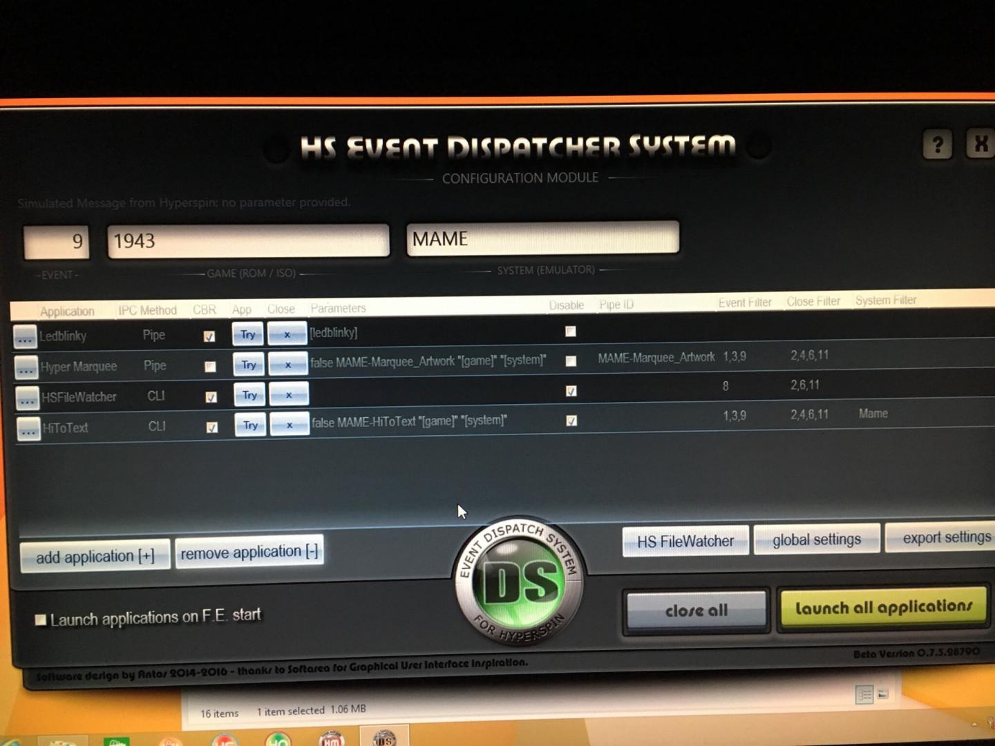

danwelsh Posted May 14, 2016 Posted May 14, 2016 This is what I have is this right? I'm lovin my arcade
danwelsh Posted May 14, 2016 Posted May 14, 2016 Never mind guys, figured it out, needed parameters on my close filter I'm lovin my arcade
danwelsh Posted May 14, 2016 Posted May 14, 2016 Okay guys, i have one problem with my Hypermarquee and i think i still have something not right....when i run hyperspin everything seems to run correctly but when i exit the frontend there's anywhere from 6-9 instances of Hypermarquee still running.....i tried checking off CLR on ledblinky and hypermarquee in EDS and that didn't fix it and the strange thing is when i try it just with the eds gui it only opens up once with the hypermarqee but when i click try on the ledblinky it opens a bunch of times.......could this be a problem with my .net framework? I have installed the recommended version 4.5.1 or is it my parameters are wrong.... i'm stumped and need help. I'm lovin my arcade
sevenseal Posted May 14, 2016 Posted May 14, 2016 Okay guys, i have one problem with my Hypermarquee and i think i still have something not right....when i run hyperspin everything seems to run correctly but when i exit the frontend there's anywhere from 6-9 instances of Hypermarquee still running.....i tried checking off CLR on ledblinky and hypermarquee in EDS and that didn't fix it and the strange thing is when i try it just with the eds gui it only opens up once with the hypermarqee but when i click try on the ledblinky it opens a bunch of times.......could this be a problem with my .net framework? I have installed the recommended version 4.5.1 or is it my parameters are wrong.... i'm stumped and need help.cbr is only for cli type programs, it really bad to use with pipe.you need to check if you have ledblinky enable on your rocketlauncher if you use it, or any other applicate that steal focus of hyperspin.... please attach your config file inorder to help trouble shot this? dont paste code on a post, we need the file as is?

sevenseal Posted May 16, 2016 Posted May 16, 2016 I'm telling you it wouldn't allow me to attach the file.....it says i am not permitted to attach this file type, there is no where i could see that said i could attach "other"......and the other file i attached was .xml not .config, i am good at following instructions and it just would not allow me to attach it, i'm sorry.....and if it takes you a long time so be it, i pretty much give up messing with the settings for hours..... you have eds calling itself, which you shouldnt be doing. when you see ledblinky? that it referring to real ledblinky if you use it if you seen recent post, i have stated that EDS function as a passthrough for LEDBlinky and when you use the wildcard [LEDBLINKY] in the parameter entry it gives what is meant for the application you set it for. in addition, when using [LEDBLINKY] requires no open events nor close filters, must be set blank you are overloading eds by calling eds in itself, repeating cycle. until it crashes i dont think you have your HyperHQ for hyperspin setup to run eds, its need to be pointing to your eds directory with of the module that need to be renamed to LEDblinky.exe. if you have extension hidden you just need to rename it as LedBlinky. with extension hidden many make the mistake of rename the module as ledblinky.exe.exe, dont do that you might have to update the exe of hypermarquee to the latest, if you what that to function correctly? if you wanted to attached the config file, you could of rename the extension to EDS_Setting.config to EDS_Setting.config.xml and it would have uploaded fine, if all failed you could have upload to any cloud service and provided a link for it.

danwelsh Posted May 16, 2016 Posted May 16, 2016 Okay.....so now that i understand this a bit better after reading it about 6 more times.......i don't have real Ledblinky so i don't use it at all so it's diabled in the event integrator......that got rid of it opening itself a bunch of times then crashing as sevenseal said, it works well but when i close hyperspin one instance remains open and Hypermarquee stays open displaying the MAME main menu marquee until i manually close it.......my close filters are 2,4,6,11 I'm lovin my arcade
Antos Posted May 16, 2016 Author Posted May 16, 2016 Okay.....so now that i understand this a bit better after reading it about 6 more times.......i don't have real Ledblinky so i don't use it at all so it's diabled in the event integrator......that got rid of it opening itself a bunch of times then crashing as sevenseal said, it works well but when i close hyperspin one instance remains open and Hypermarquee stays open displaying the MAME main menu marquee until i manually close it.......my close filters are 2,4,6,11 Thanks to the guy who comes from the same place as Sydney Crosby for reading the docs! For HyperMarquee not closing, your close filters seems ok. Is there only one HM instance that keeps open each time? cheers, HyperMarquee & Event Dispatch System
danwelsh Posted May 16, 2016 Posted May 16, 2016 Thanks to the guy who comes from the same place as Sydney Crosby for reading the docs! For HyperMarquee not closing, your close filters seems ok. Is there only one HM instance that keeps open each time? cheers, yes, just the one stays open.... I'm lovin my arcade
