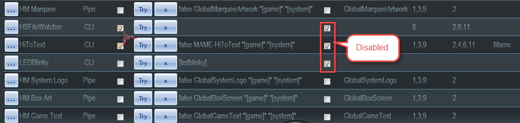

erkrystof Posted June 4, 2016 Posted June 4, 2016 Yup, nothing but 2 in close filter. Only have the HyperMarquee launchers enabled as below: In the pastebin I posted above, only the GlobalGameText was enabled.
sevenseal Posted June 4, 2016 Posted June 4, 2016 Yup, nothing but 2 in close filter. Only have the HyperMarquee launchers enabled as below: In the pastebin I posted above, only the GlobalGameText was enabled. changed any results?nice catch of a glitch though
erkrystof Posted June 4, 2016 Posted June 4, 2016 Hi, Sevenseal. That's what I had before I logged the issue. I haven't changed anything. Close Filter was always on 2.
sevenseal Posted June 4, 2016 Posted June 4, 2016 Hi, Sevenseal. That's what I had before I logged the issue. I haven't changed anything. Close Filter was always on 2. oh okay, just was wondering if it was still occuring while the close filter remain as a 2 only, didnt realize you already done so.

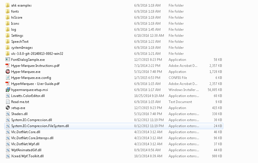

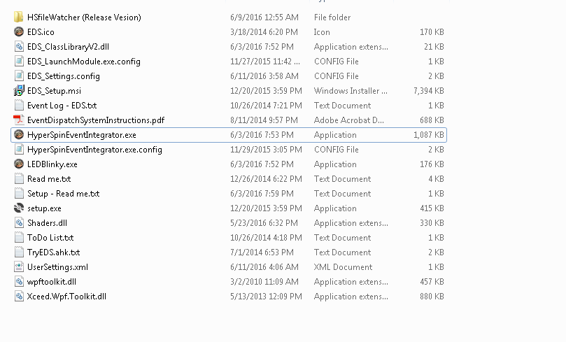

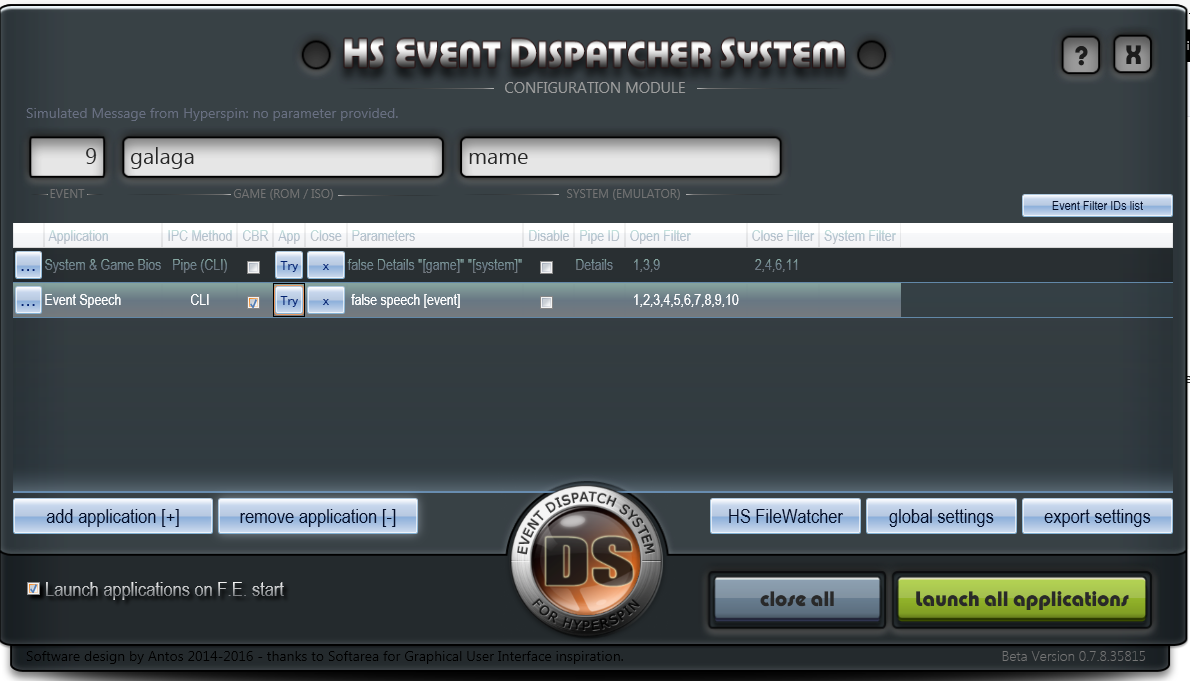

ninja2bceen Posted June 11, 2016 Posted June 11, 2016 howdy, please don't troll on me as I'm really trying to make hyperspeech work here. Noted hyperspeech is dead and not working and eds is a viable solution so that I can get a welcome to hyperspin message, system bios, game bios, and a hyperspin exit message I'm having a real hard time setting this up though. Can you tell me what I'm doing wrong? I've attached my eds and hypermarquee folder. Note I'm only trying to get hyperspeech working, I don't have a second monitor or anything like that within hyperhq (settings.ini) [LEDBlinky] Active=true Path=E:\Arcade-PC\hyperspin\zips\tools\EDS\ main menu ini file for hyperspeech bios E:\Arcade-PC\hyperspin\RocketLauncher\Data\Game Info *attached is my speechtext folder contents and my mainmenu ini for bios *attached are my config files Please don't just send me to another tutorial. I have spent several hours trying to get this running without success. Maybe its a file rename? maybe its something totally unrelated. I have hypermarquee, ledblinky and eds running as admin programs. I'm on windows 7 thanks for taking the time for reviewing my issue. where did I go wrong? hyperspeech.zip configs.zip Advance the cause to 100%. http://hyperbase.hyperspin-fe.com/ Planet Geekdom, Subscribe for Tutorials! https://www.youtube.com/channel/UCdcby-s2GwriaOHGmVC2vGA?sub_confirmation=1&app=desktop

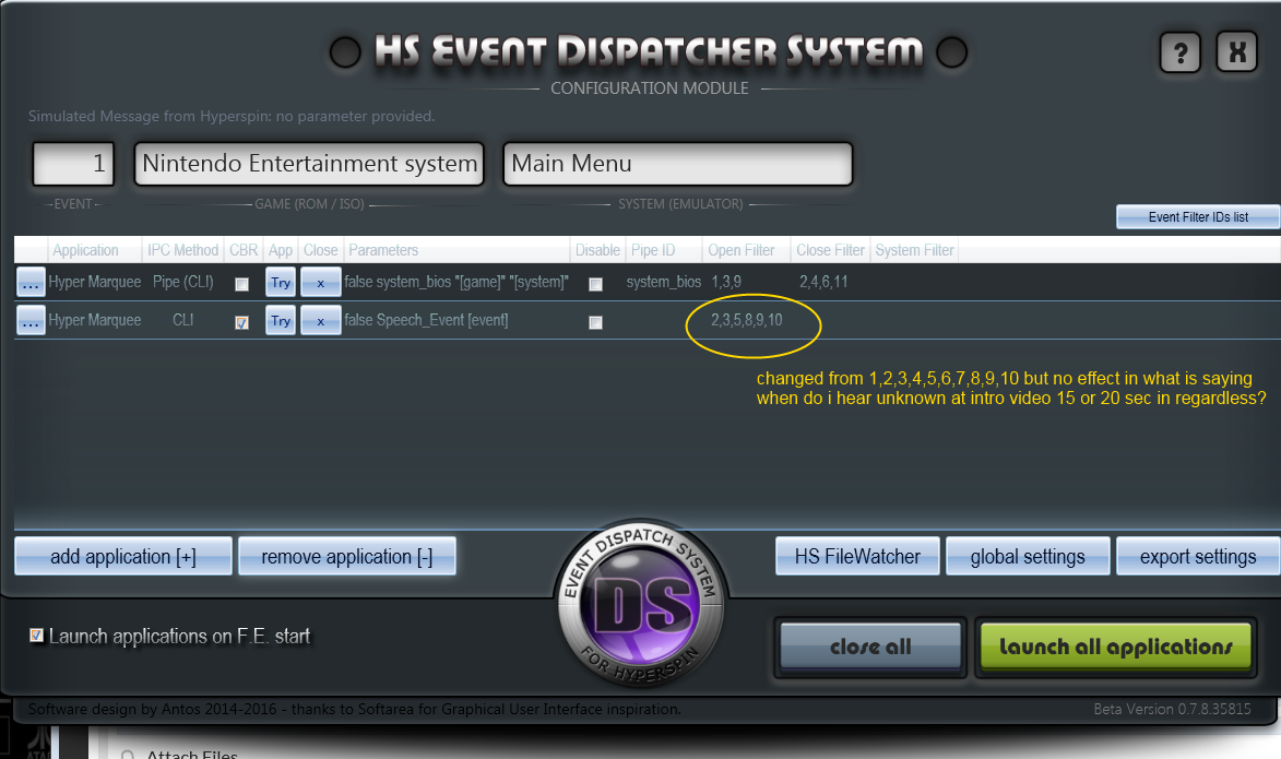

ninja2bceen Posted June 11, 2016 Posted June 11, 2016 so its how do we say working but not perfect yet. Its really busy right now and the greeting plays as soon as the intro video starts. I'm thinking about adding a system bio to hypersearchs wheel and always start on hypersearchs wheel so the greeting happens after the intro video I'm having a hard time with filtering what folders i want hyperspeech to read. Right now the game bios speak at the same time as some silliness like her saying select a game. I'd like to just turn those fillers off so i just hear the system bios and game bios, game start and game end, and hyperspin end. I believe the following folders are the ones that i want to keep. How do i turn the other ones off? Here was my attempt Lastly, i notice that about 20 seconds in my intro video from hyperspin i here her say "unknown" How do i turn that off so unknown is not said? Thanks so much for team viewing with me for about 2 hours attached is the basic set up for hyperspeech to work. obviously you will have to change the paths and hopefully it gets others up so we can figure the rest of this out to make it less chatty all over the place EDS.rar Hyper Marquee.rar Advance the cause to 100%. http://hyperbase.hyperspin-fe.com/ Planet Geekdom, Subscribe for Tutorials! https://www.youtube.com/channel/UCdcby-s2GwriaOHGmVC2vGA?sub_confirmation=1&app=desktop

ninja2bceen Posted June 11, 2016 Posted June 11, 2016 so its how do we say working but not perfect yet. Its really busy right now and the greeting plays as soon as the intro video starts. I'm thinking about adding a system bio to hypersearchs wheel and always start on hypersearchs wheel so the greeting happens after the intro video I'm having a hard time with filtering what folders i want hyperspeech to read. Right now the game bios speak at the same time as some silliness like her saying select a game. I'd like to just turn those fillers off so i just hear the system bios and game bios, game start and game end, and hyperspin end. I believe the following folders are the ones that i want to keep. How do i turn the other ones off? Here was my attempt Lastly, i notice that about 20 seconds in my intro video from hyperspin i here her say "unknown" How do i turn that off so unknown is not said? Thanks so much for team viewing with me for about 2 hours attached is the basic set up for hyperspeech to work. obviously you will have to change the paths and hopefully it gets others up so we can figure the rest of this out to make it less chatty all over the place antos do you know how I can get eds and hypermarqee to skip some of the folders? I thought I would just have to modify the numbers circled right? Advance the cause to 100%. http://hyperbase.hyperspin-fe.com/ Planet Geekdom, Subscribe for Tutorials! https://www.youtube.com/channel/UCdcby-s2GwriaOHGmVC2vGA?sub_confirmation=1&app=desktop
Antos Posted June 11, 2016 Author Posted June 11, 2016 antos do you know how I can get eds and hypermarqee to skip some of the folders? I thought I would just have to modify the numbers circled right? Simply omit the specific event in EDS open event. I.e. folders are based on events. 1 folder = 1 event. HyperMarquee & Event Dispatch System
