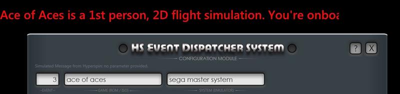

The description is only shown when using "ace of aces", when using the correct hyper-list name "ace of aces (europe)" it won't show any description or info from the gameinfo.ini files.
lol it was working when right before the session ended
have you tried the whole thing when hyperspin is running?
hyperspin will output the right name to eds...

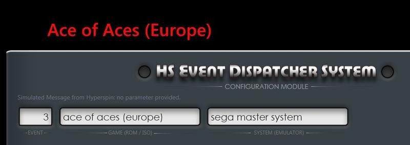

as I've stated lots of times above, this doesn't work as the filename is different in sega master system.xml and other consoles VS game info.ini from hyperlaunch
Incorrect filename according to hyperlist but in gameinfo.ini it's correct
Correct filename according to hyperlist but incorrect in gameinfo.ini
[ATTACH=CONFIG]52784[/ATTACH]
[ATTACH=CONFIG]52783[/ATTACH]

hi dino,
current right now.
only system that work perfectly with description feature under your hyperspin frontend is Mame. just to inform purpose, other system do not extract description information correctly due to lack of consistent name matching with "hyperlist database" (hyperspin) and "gameinfo database" (hyperlaunch)... any game with language markers in their title will not match and scrape the description information in error..
example of this in
system: sega master system
game: ace of aces
appears in hyperlist database: ace of aces (europe)
appears in gameinfo database: ace of aces
"ace of aces (europe)" /= "ace of aces"
so info does not appear correctly.
at this current time, there is not a simple solution to this..
to troubleshoot this issue to make work; will lead your database out of sync of your media labels and as well not sync up with hypersync live to scrap your media for updates.
currently Antos and I (mainly antos to be honest) are working to aim to fix this.
suggestion todo?
standby until the fix arrives or directed other wise of a method of a course to approach the matter.
remember this is beta software, not a full release.
so please be understanding and continue to enjoy the tryout as many have enjoy it so far already. we are aware of the issue
