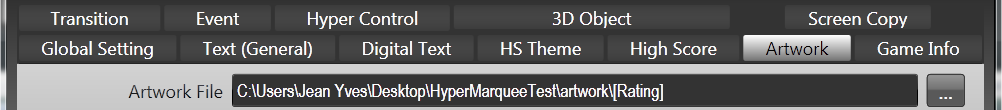

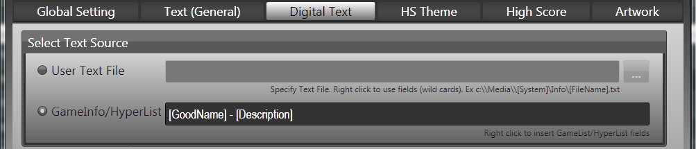

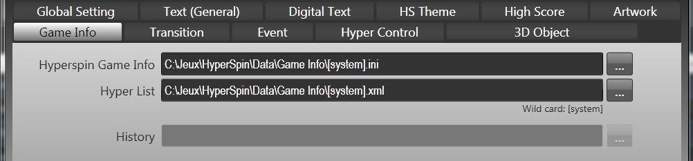

Antos Posted March 7, 2015 Author Posted March 7, 2015 Happy Saturday! Ad hoc TIP time. For the ones who like to communicate information (Text, Image & Video) to gamers about the current selected game, this is easy using external sources of information. HyperMarquee is compatible with HyperList & GameInfo. They provide the possibility to display text and images based on game tombstone data using fields (wild cards) like; [GoodName], [Company], [Year], [GameType], [Language], [NumPlayers], [series] & [Rating]. 1. Configure HM by pointing to the proper source files 1.1 - Game Info within HyperLaunch! [system.ini] https://code.google.com/p/hyperlaunch-3/source/browse/#git%2FData%2FGame%20Info 1.2 - HyperList! [system.xml] hyperlist.hyperspin-fe.com 2. Use the fields (wild cards) within your favorite media! As Text As Image Maximize your possibilities! HyperMarquee & Event Dispatch System

Antos Posted March 10, 2015 Author Posted March 10, 2015 Question...from my previous post, I was showing off my new "billboard" marquee design. With it's current configuration, I can show one primary image and 5 alternate images. And as far as I know, that's all you can do. Is there any way now or in future releases to display random images from a specified folder? Yes absolutely, you can display random artworks that pertain to a folder. use the [RandomFile] field/wildcard in the Artwok section. C:\Users\Desktop\HyperMarqueeTest\artwork\[RandomFile] Check cycle and the duration. HyperMarquee & Event Dispatch System
lildivaaa Posted March 12, 2015 Posted March 12, 2015 Yes absolutely, you can display random artworks that pertain to a folder.use the [RandomFile] field/wildcard in the Artwok section. C:\Users\Desktop\HyperMarqueeTest\artwork\[RandomFile] Check cycle and the duration. Ok, got it. That works beautifully. Now, another question... So, I now have this random artwork running...starting up as the front end starts and stays running. What I want to do is for it to STOP running once I select a game to play. THEN, start up again once I stop the game and come back to the HyperSpin menus. I've tried a few different combinations of event id's, but can't get it to perform this behavior. Any ideas??
