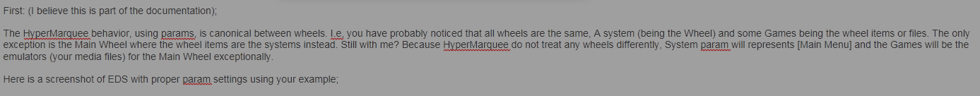

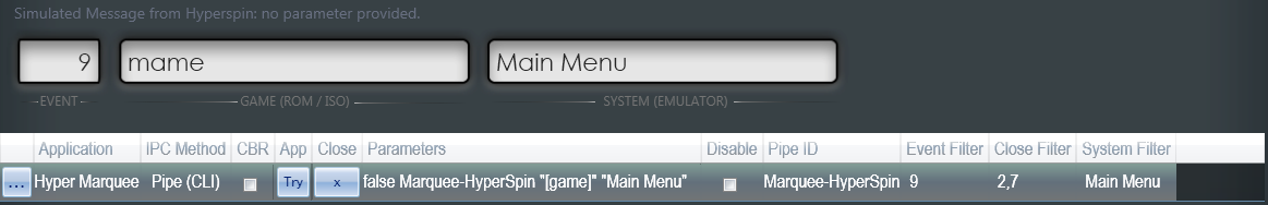

Antos Posted July 9, 2015 Author Posted July 9, 2015 Hello, I have some time to try to help a little. First I would like to take one problem at the time. Choose 1 that you beleive is priority one for you, and we will try to beat it to death. Please note that English is not my mother tongue, that may lead to ask weird questions, or worst, weird answers... lol. Lets take your Item 1. I am looking at it with the latest EDS config that you have posted... HyperMarquee & Event Dispatch System
Antos Posted July 9, 2015 Author Posted July 9, 2015 See images... sorry my browser crashed, but I have been able to do a screen capture and not loose my post... Let me know if you understand my explanation.. I will be happy to provide more details or clarifications if needed. HyperMarquee & Event Dispatch System
