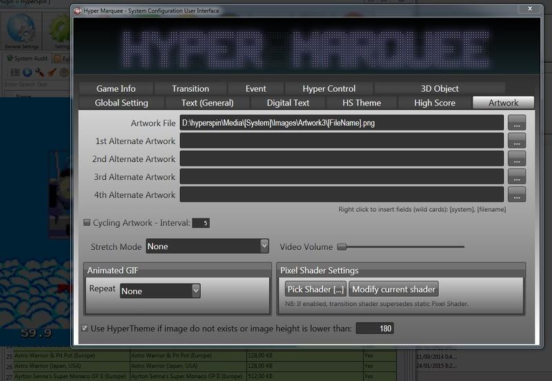

sevenseal Posted March 13, 2015 Posted March 13, 2015 Hi.I sent you a request on skype as well as an email. I'm looking for some help please. I still can't get all of my system artwork to display on the marquee. About half of them work. While I'm in the EDS configuration utility I'm successfully able to display the mame logo for example. But it doesn't work while in hyperspin. Please help me out. Thanks Junky you been accepted, I will be able to help sometime on friday 9am to 330pm
dinodino Posted March 13, 2015 Posted March 13, 2015 For the record, I don't see a way to retract my vote, but if I could I would definitely change it from "evaluating it" to "loving it"! Another thanks for all your efforts in developing and supporting this... it makes all the difference. dinodino
Imagamejunky Posted March 14, 2015 Posted March 14, 2015 Today Sevenseal spent over an hour with me helping me figure out why Hypermarquee wasn't showing all of my artwork. It turned out that the newest version of HSFilewatcher was incompatible with windows 8.1. Once we downgraded to the older version then all was well. I also had to make sure that all of my systems had working videos because HSFilewatcher watches the videos before making a marquee change. I can't stress enough to all of you what a great guy Sevenseal is. He was very helpful. Thank you man!!! Junky The Gamejunky Cab: http://www.hyperspin-fe.com/topic/7191-project-gamejunky-cab/ My new youtube channel: https://www.youtube.com/channel/UC85zq3VgibnPTOkielbyRegInstagram: https://instagram.com/imagamejunky/

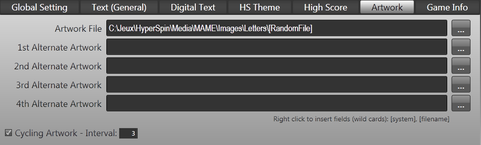

dinodino Posted March 15, 2015 Posted March 15, 2015 Yes absolutely, you can display random artworks that pertain to a folder.use the [RandomFile] field/wildcard in the Artwok section. C:\Users\Desktop\HyperMarqueeTest\artwork\[RandomFile] Check cycle and the duration. Is there a way to display all the artwork in a folder sequentially/alphabetically instead of randomly?
Antos Posted March 15, 2015 Author Posted March 15, 2015 Is there a way to display all the artwork in a folder sequentially/alphabetically instead of randomly? Not that I can think of right now. This is something that can be considered within a next version, please just give me your favorite scenario (circumstances) where this upgrade can be useful for you. Any specific needs? HyperMarquee & Event Dispatch System

lildivaaa Posted March 17, 2015 Posted March 17, 2015 2. Random: I ran some deeper tests on this and everything seems to be ok on my side. I just tested it with the latest HM version with the HS Images/Letters folder. It includes 39 files. Here are my two first results;1st try: Q,6,L,V,O,0,Y,A,4,I,D,8... 2nd try: 8,2,H,C,6,L,F,U,P,1,Y,T,S... here are my settings; [ATTACH=CONFIG]52108[/ATTACH] Antos, Ok...I went through and recreated your scenario for the random images. I have 14 images, I renamed them 1 through 14. Then took a sample of a typical random rotation that I'm seeing. Here are the results: 4, 9, 11, 4, 9, 4, 9, 7, 4, 9, 14, 12, 4, 10, 14, 5, 10, 7, 14, 5, 14 As you can see, I'm seeing way too much repetitiveness. What are your thoughts on this?
sevenseal Posted March 17, 2015 Posted March 17, 2015 Antos,Ok...I went through and recreated your scenario for the random images. I have 14 images, I renamed them 1 through 14. Then took a sample of a typical random rotation that I'm seeing. Here are the results: 4, 9, 11, 4, 9, 4, 9, 7, 4, 9, 14, 12, 4, 10, 14, 5, 10, 7, 14, 5, 14 As you can see, I'm seeing way too much repetitiveness. What are your thoughts on this? it could be all related to the format type of the images you are using. if you used the wildcard and you put a .png at the end of you directory.... it will only show png file... you might have other format like jpeg, bmp..... just a comment that I am suggesting.. that does make a different
lildivaaa Posted March 17, 2015 Posted March 17, 2015 it could be all related to the format type of the images you are using. if you used the wildcard and you put a .png at the end of you directory.... it will only show png file... you might have other format like jpeg, bmp..... just a comment that I am suggesting.. that does make a different I do appreciate your input on this. But, all my images are in PNG format. I don't use any other format. Antos was able to run the same, similar test and get completely random results...exactly as it should. But as you can tell from my testing, using his method...I get more repetitive images that random.
dinodino Posted March 17, 2015 Posted March 17, 2015 Sure,As of now, there are two ways to achieve this that I can think of. 1. Just use the background artwork that you can parameterize within the 'Global Setting' section. When there is no background theme displayed, then the background of your choice will be displayed. 2. Place another instance under the theme instance with a transparent background for the theme. Then when there is no theme background available, you will see artwork(s) behind your theme as a background image. I tested option 1, it worked pretty well for me. Here is a screenshot. [ATTACH=CONFIG]52006[/ATTACH] Let me know if this works well for you. Never realized the functionality was already there! I had a chance to try option 1 today and it works great. Thanks a lot for the info!
Antos Posted March 17, 2015 Author Posted March 17, 2015 Antos,Ok...I went through and recreated your scenario for the random images. I have 14 images, I renamed them 1 through 14. Then took a sample of a typical random rotation that I'm seeing. Here are the results: 4, 9, 11, 4, 9, 4, 9, 7, 4, 9, 14, 12, 4, 10, 14, 5, 10, 7, 14, 5, 14 As you can see, I'm seeing way too much repetitiveness. What are your thoughts on this? I will help, this pattern seems odd to me indeed. Even if the sample is very narrow to conclude anything. Few questions; - Are you using EDS, (Pipe or CLI)? I may suspect something strange with Pipe, not sure. - Can-you do some more testing using the CLI mode only? - Please send me your images in a zip file if possible? This may not change anything, but I like to do test within the exact same environment. - Is the problem occurs at the first attempt or after few calls? - Please post me your EDS & HM settings. HyperMarquee & Event Dispatch System
