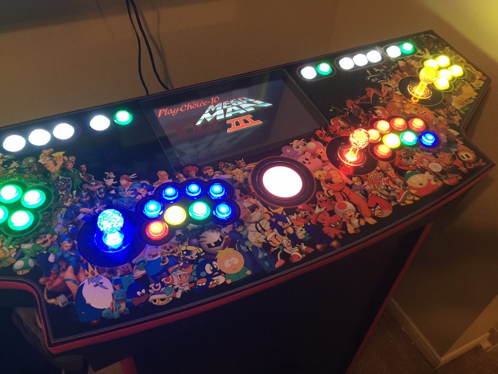

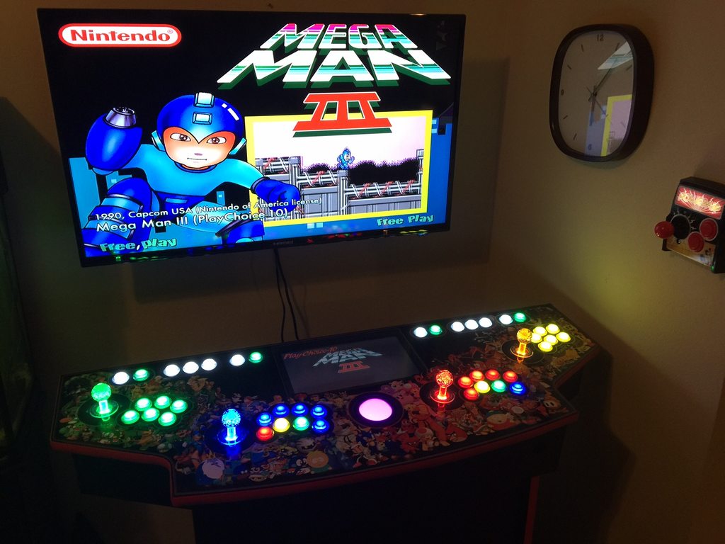

Xerobull Posted December 1, 2015 Posted December 1, 2015 New Issue: Since I updated to the new version of EDS, MM won't transition to different marquees as I move from emulator to scroll through games. It does show the appropriate game once I select it, just not cycling through the games as I move through wheels. It also continues to play previous video if there is no video available for the selected game. Thoughts? By the way, here's MM running on my setup. Just one layer in these pics:
sevenseal Posted December 1, 2015 Posted December 1, 2015 New Issue: Since I updated to the new version of EDS, MM won't transition to different marquees as I move from emulator to scroll through games. It does show the appropriate game once I select it, just not cycling through the games as I move through wheels. It also continues to play previous video if there is no video available for the selected game. Thoughts? By the way, here's MM running on my setup. Just one layer in these pics: go into global setting in eds, change 2000 to 1000see if that better for your taste, if it doesnt go for 4000
Antos Posted December 1, 2015 Author Posted December 1, 2015 Very nice setup. Sevenseal and I did 30 minutes of testing yesturday. I also spent 1 hour of home test today. Didn't find anything wrong yet. Hoping that you have installed the new version correctly. But, in any case, we will support you to make it work, or if there is a bug, I will fix it. The latest EDS version is a major upgrade, so it can have bugs or strange behavior, but its for the best once all bugs will be removed. Let's work it out together. Cheers. ** This post belongs to EDS thread, let's continue within the proper forum. HyperMarquee & Event Dispatch System
Xerobull Posted December 2, 2015 Posted December 2, 2015 go into global setting in eds, change 2000 to 1000 see if that better for your taste, if it doesnt go for 4000 Tried this- still having the issue. HM will cycle through different marquees on the TOP wheel, which is emulators. Once I select an emulator, it is 'stuck' on the emulator marquee while I cycle through individual games. However, it DOES display the transition effect as I scroll through games, it just doesn't show the proper marquee. Once Select and start a game, it properly shows the marquee. Ideas?
sevenseal Posted December 2, 2015 Posted December 2, 2015 Tried this- still having the issue. HM will cycle through different marquees on the TOP wheel, which is emulators. Once I select an emulator, it is 'stuck' on the emulator marquee while I cycle through individual games. However, it DOES display the transition effect as I scroll through games, it just doesn't show the proper marquee. Once Select and start a game, it properly shows the marquee. Ideas? missing artwork, i would double check your media file labels match your database
Xerobull Posted December 2, 2015 Posted December 2, 2015 missing artwork, i would double check your media file labels match your database That doesn't seem right- the proper marquee (image) launches once I select a game. It also works when I type in a game in EDS and click 'Try'.
