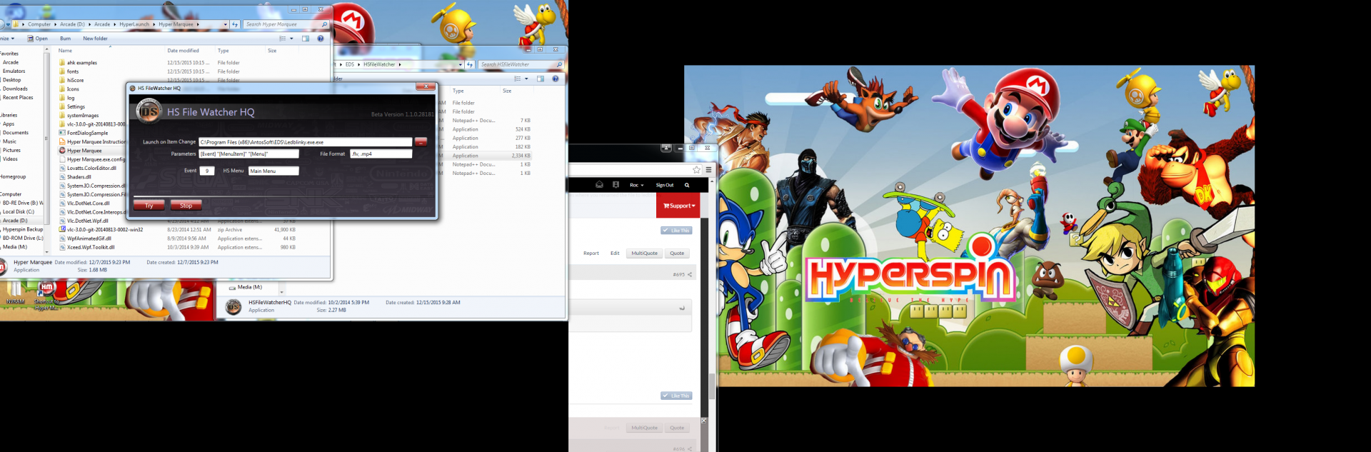

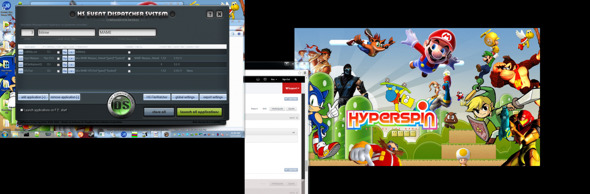

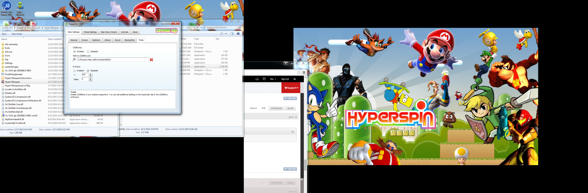

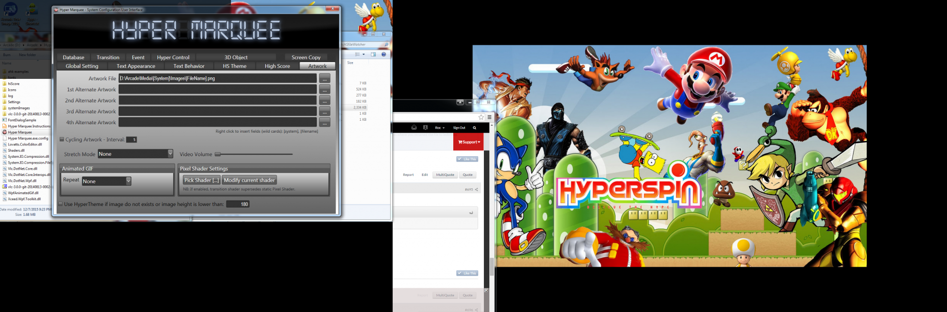

Roc Posted December 15, 2015 Posted December 15, 2015 2 options, 1. Paste an image of your eds fe and hypermarquee artwork tab, or 2. Paste your eds settings and your HM settings We need to see what you are doing...
Reefboi16 Posted December 15, 2015 Posted December 15, 2015 First thing I see is check the box on bottom that's says Launch Applications on FE start. This will basically launched your applications when your front end is launched. Next is your file should not be named .exe.exe that causes an issue. Only ".exe" Also, If your running the latest version of EDS I would chance from PIPE (cli) to PIPE runs a lot smother. Fix those couole things and report back as to what happens.
Roc Posted December 15, 2015 Posted December 15, 2015 First thing I see is check the box on bottom that's says Launch Applications on FE start. This will basically launched your applications when your front end is launched. Next is your file should not be named .exe.exe that causes an issue. Only ".exe" Also, If your running the latest version of EDS I would chance from PIPE (cli) to PIPE runs a lot smother. Fix those couole things and report back as to what happens. Made the changes and still a no go. The hyper marquee comes up on the screen but no images
Roc Posted December 15, 2015 Posted December 15, 2015 First thing I see is check the box on bottom that's says Launch Applications on FE start. This will basically launched your applications when your front end is launched. Next is your file should not be named .exe.exe that causes an issue. Only ".exe" Also, If your running the latest version of EDS I would chance from PIPE (cli) to PIPE runs a lot smother. Fix those couole things and report back as to what happens. I'm running EDS 7.4
