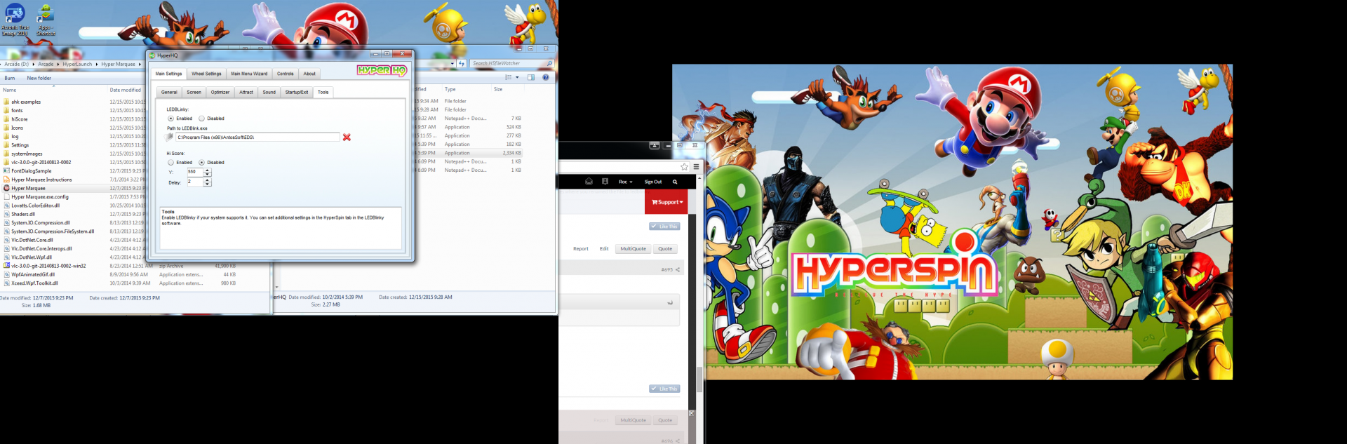

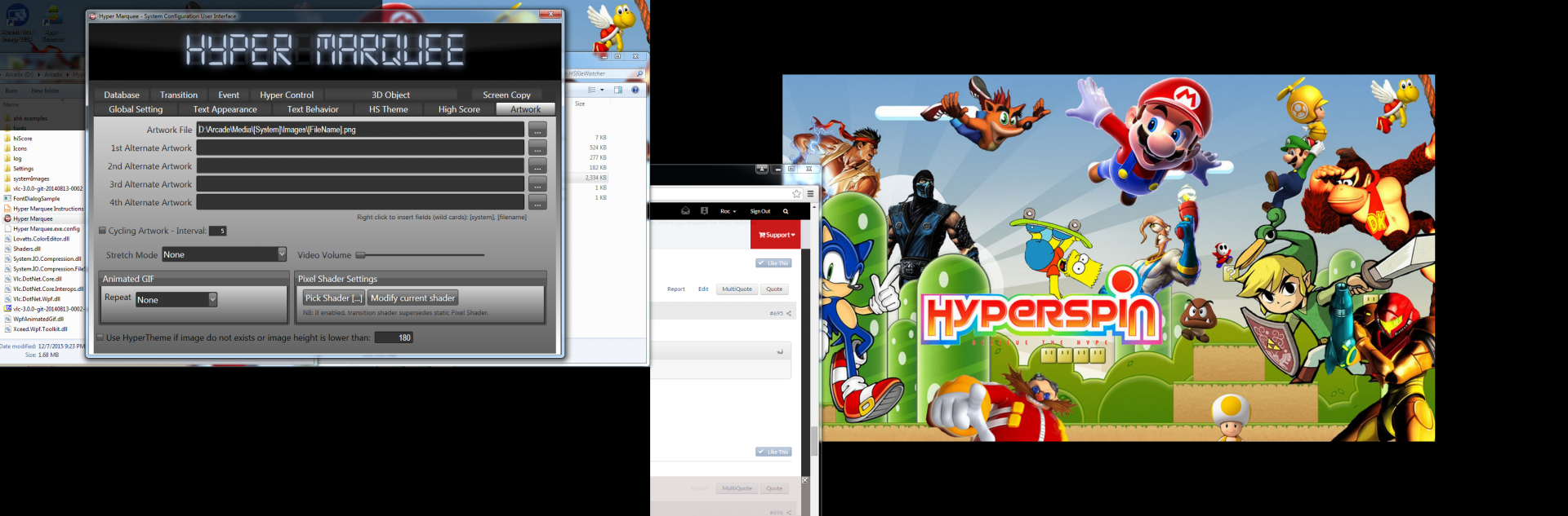

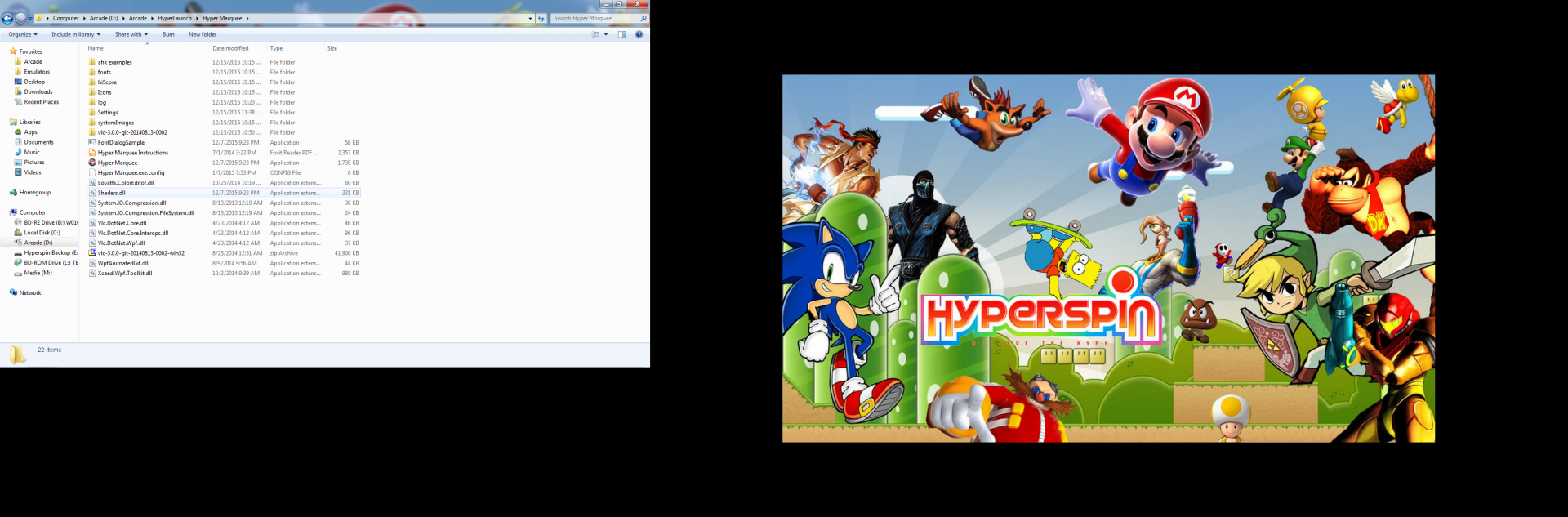

Reefboi16 Posted December 15, 2015 Posted December 15, 2015 Ok now that it's coming up there is a problem with how your hyper marquee is set up. Can you post a pic of your event tab in the marquee settings, the artwork tab, and the folder your marquee is saved in? Also is your media actually in a folder called arcade and not HyperSpin?

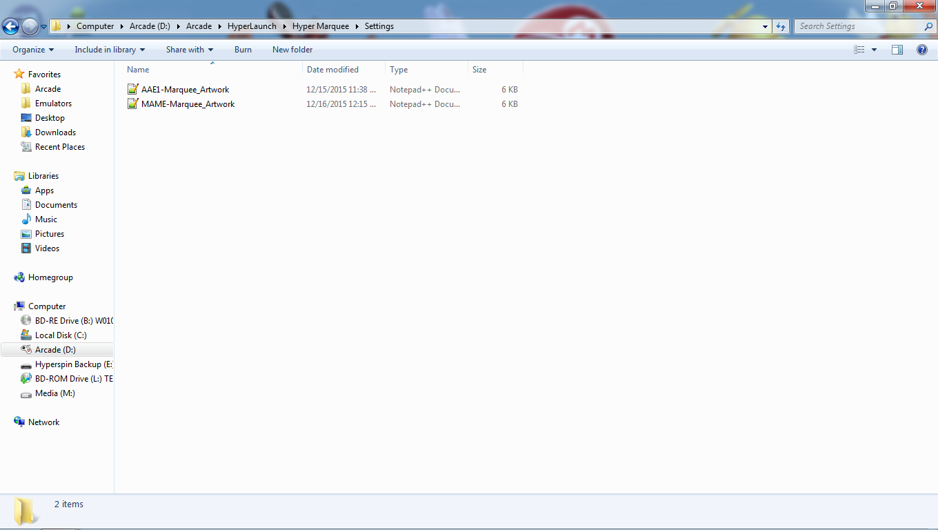

Reefboi16 Posted December 15, 2015 Posted December 15, 2015 under your marquee folder click on your settings folder and grab a screen shot of that.

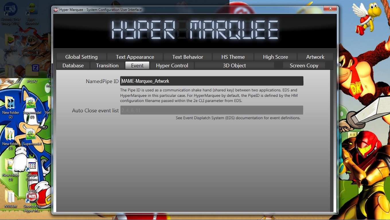

Reefboi16 Posted December 15, 2015 Posted December 15, 2015 Also hit the Event tab for us on your Hypermarquee settings and grab a shot of that. Its your third screen shot I believe.A little tip. To stop your computer from grabbing a screen shot of all your displays and windows if you click on the windows you want a screen shot of then press down and hold alt and hit your Print Screen key and it will grab a shot of only your active screen.
Reefboi16 Posted December 15, 2015 Posted December 15, 2015 does the artwork display when you click the "TRY" on EDS?

Reefboi16 Posted December 15, 2015 Posted December 15, 2015 I don't think this is a big deal but to clear confusion change those two files from notepad++ files back to XML. When i get home i will open up my marquee and eds and help figure this out. Just be patient and we will get it. If Antos reaches out to you on the filehelper side maybe that's your issue. Again I don't use the filechecker i have hyperspin 1.4. You would get rid of the head ache of having to set that up to allow this awesome program to work. You have set the path correctly to your marquee from eds correct? you don't have more than one instance of hypermarquee.exe anywhere?

xzotic Posted December 16, 2015 Posted December 16, 2015 I'm going to update to update my hyperspin That's good. Also one consideration and something else you can try: 1. Ignore the Try button not working in EDS for the moment I had a similar issue that may or may not be related but HM still worked outside of the EDS GUI (and you have now achieved that) 2. In your Artwork File path name change the path to: "D:\Arcade\Media\Mame\Images\[Filename].png My HM's would not work unless I specifically put the Mame directory rather than [system] in the path. I logged the issue here but it was dismissed as being something at my end. So not saying that it is your problem but it's worth a try and if nothing else it means the path is pointing exactly to your folder where your artwork is. Obviously this won't work longer term if you are using multiple emulators but it may help troubleshoot your issue.

Roc Posted December 16, 2015 Posted December 16, 2015 That's good. Also one consideration and something else you can try: 1. Ignore the Try button not working in EDS for the moment I had a similar issue that may or may not be related but HM still worked outside of the EDS GUI (and you have now achieved that) 2. In your Artwork File path name change the path to: "D:\Arcade\Media\Mame\Images\[Filename].png My HM's would not work unless I specifically put the Mame directory rather than [system] in the path. I logged the issue here but it was dismissed as being something at my end. So not saying that it is your problem but it's worth a try and if nothing else it means the path is pointing exactly to your folder where your artwork is. Obviously this won't work longer term if you are using multiple emulators but it may help troubleshoot your issue. It worked when I left mame the instead of changing it to system. I checked open when front end start but it stayed close
xzotic Posted December 17, 2015 Posted December 17, 2015 It worked when I left mame the instead of changing it to system. I checked open when front end start but it stayed close OK, so you are saying it now works when you hardcode MAME in the path rather than use System? Are you also saying that even though it works in Hyper Marquee it now doesn't open from EDS when you have checked the "Open when front end starts" option in EDS? Can you confirm you updated to the most recent Hyperspin 1.4? Can you also confirm that you disabled HSFileWatcher in EDS (if you did update Hyperspin)? Perhaps repost a screenshot of your EDS config so we know what is currently configured.
