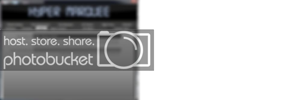

Antos Posted December 23, 2015 Author Posted December 23, 2015 Ok so here it is. As you see the Atari marquee is opening over the supernintendo marquee. Behind the SNES marquee there are several others. They keep opening when it gets to a certain number everything starts acting funny they never close, even if I select the CBR.A teamviewer session with sevenseal is always awesome.As far I can tell , here are my suggestions, - Make sure that you have provided full access to all files within EDS folder. - Use Pipe as the IPC of choice. - If your cheched the box launch on event 1, make sure that you are not calling event 1 several times. Unlikely, but just checking. - Dont't be affraid to test within EDS fe based on HS log. Plus, one tip, to remove the right botton corner handle, check out edit mode. Please let me. know what cause your problem. But I can ensure you it is not a bug. Cheers, HyperMarquee & Event Dispatch System
sevenseal Posted December 24, 2015 Posted December 24, 2015 A teamviewer session with sevenseal is always awesome. As far I can tell , here are my suggestions, - Make sure that you have provided full access to all files within EDS folder. - Use Pipe as the IPC of choice. - If your cheched the box launch on event 1, make sure that you are not calling event 1 several times. Unlikely, but just checking. - Dont't be affraid to test within EDS fe based on HS log. Plus, one tip, to remove the right botton corner handle, check out edit mode. Please let me. know what cause your problem. But I can ensure you it is not a bug. Cheers, from what i can tell from the image is the pid is not set correctly either on hm side or eds side, could be both
Reefboi16 Posted December 25, 2015 Posted December 25, 2015 Sorry guys been very busy with family this time of year. I will check on all that has been suggested As soon as I can I'll give it one last go then if I can't figure it out I will do a teamviewer session. Like to learn to help myself and others in the future. Thanks to you guys and Happy Holidays.
Antos Posted December 27, 2015 Author Posted December 27, 2015 from what i can tell from the image is the pid is not set correctly either on hm side or eds side, could be both If you mean NamedPipe (PipeID), yes you are right, there are good chances. That often happens when users duplicate a config file to save time (instead of starting from scratch) and rename the file without updating the NamePipeID under HyperMarquee Event Tab. To avoid this risky behavior from users, I have created HyperMarquee new version (0.4.9 not online yet) that allows to leave the HM Named Pipe ID blank. Without getting into technical details, by default, leaving it blank, HM will dynamically use the config file name as the named Pipe passed by EDS instead of hardcoding it in HM. No changes will be required under EDS and HM will be backward compatible. HyperMarquee & Event Dispatch System
Reefboi16 Posted December 31, 2015 Posted December 31, 2015 Ok guys finally got some time to work on my HM/EDS I have sam PipeID on both HM and EDS
Reefboi16 Posted December 31, 2015 Posted December 31, 2015 BTW its all disabled I was testing some new artwork on my wheels and didn't want HM to open.
Reefboi16 Posted December 31, 2015 Posted December 31, 2015 Just double checked everything. Made sure all characters/spaces matched. Then launched them manually they worked fine then when I launched HS It did it again, but this time I noticed that it is only the system Marquees that are opening instances on top of instances. Once I go into a system and scroll through the games those close and re-open just fine without the "stacking" issue.

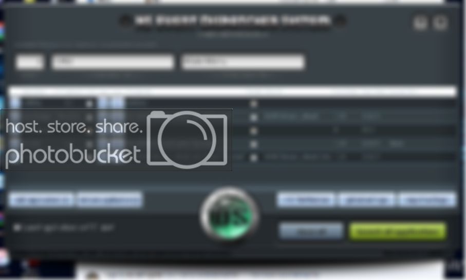

sevenseal Posted January 1, 2016 Posted January 1, 2016 Ok guys finally got some time to work on my HM/EDS I have sam PipeID on both HM and EDS still was suggest to use just pipe as your ipc method...you were told several time to reframe from selecting pipe (cli)... you are bound to have issue. if you fail to listen from the support you have been given then you are on your own to deal with it. i will stop helpping from my position if you continue to do so fyi, directly eds issue, from screenshot of setting
Reefboi16 Posted January 1, 2016 Posted January 1, 2016 Oops sorry that was the wrong screen shot that is from my old set up dunno how that happened
Reefboi16 Posted January 1, 2016 Posted January 1, 2016 I'm not home at the moment but they are all PIPE I selected the wrong picture upon upload.
