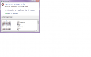

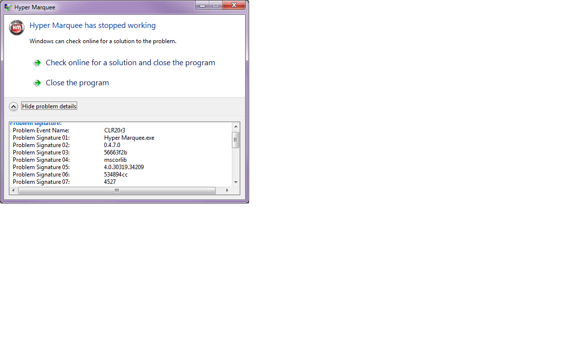

imagebuff Posted December 18, 2015 Posted December 18, 2015 Just getting started with HM.. Love it. I'm using the latest beta with Win7 64bit. A single instance of HM runs fine. I'm able to display mame marquees. When I try to manually start a 2nd instance of HM by simply clicking on the executable it crashes. Anything I need to be doing differently?
sevenseal Posted December 18, 2015 Posted December 18, 2015 Just getting started with HM.. Love it. I'm using the latest beta with Win7 64bit. A single instance of HM runs fine. I'm able to display mame marquees. When I try to manually start a 2nd instance of HM by simply clicking on the executable it crashes. Anything I need to be doing differently?what is the second instance?do you have .net framework 4.5.1 or above install?
imagebuff Posted December 18, 2015 Posted December 18, 2015 what is the second instance? do you have .net framework 4.5.1 or above install? Yes, I have .net framework 4.5.2 installed. The 2nd instance is just the second HM window. I can launch HM by clicking on the .exe and I get a single window which works fine. When I try to then launch another HM window (2nd instance) by clicking on the .exe it crashes. Per the manual I should be able to have multiple HM windows with different content running at the same time, correct? I only can launch one. I hope I'm doing something wrong here and there is something special I need to do to have multiple concurrent HM windows.
Antos Posted December 18, 2015 Author Posted December 18, 2015 Yes, I have .net framework 4.5.2 installed. The 2nd instance is just the second HM window. I can launch HM by clicking on the .exe and I get a single window which works fine. When I try to then launch another HM window (2nd instance) by clicking on the .exe it crashes. Per the manual I should be able to have multiple HM windows with different content running at the same time, correct? I only can launch one. I hope I'm doing something wrong here and there is something special I need to do to have multiple concurrent HM windows. I am doing test right now, I believe that something append with I compiled HM under Windows 10. I understand that you may not be able to run 2 instances by clicking the HM.exe, fear not . I will look at this, although, that is not a real problem for you. Please edit each instances 1 at the time and run them all together using EDS. This will work perfectly well. I will look a the 'bug' this week end. Quick question, when you say, it crashes, do you mean it do not launch .exe the second time or Windows throw an error at you? Please provide a screenshot if so. Thanks, let me know. HyperMarquee & Event Dispatch System

imagebuff Posted December 19, 2015 Posted December 19, 2015 . Quick question, when you say, it crashes, do you mean it do not launch .exe the second time or Windows throw an error at you? Please provide a screenshot if so. Thanks, let me know. It crashes soon after clicking on the .exe. No HM interface or window whatsoever. The crash message that pops up is attached to message #730.
imagebuff Posted December 19, 2015 Posted December 19, 2015 To my understanding, he is not even able to reach that point. As soon as he clicking on the exe, nothing shows up... Correct. Nothing shows up but a windows crash window.
Antos Posted December 19, 2015 Author Posted December 19, 2015 NEWS UPDATE - 2015/12/19 The beta version 0.4.8 is now available for download. (this is a beta evaluation version for testers only) Installation: Copy and replace HyperMarquee.exe and Shaders.dll within your main HyperMarquee folder. Attention: Make a backup of HyperMarquee folder before testing!! New functionalities within Beta Version 0.4.8: Bug fixed when using Shaders (Now 15 Transition Shaders are back + More stability) Bug fixed when launching multiple instances with no parameters passed (HyperMarquee.exe, see post #732). - Reported by imagebuff Thanks to all testers and partners! Please and let me know, Cheers, HyperMarquee & Event Dispatch System

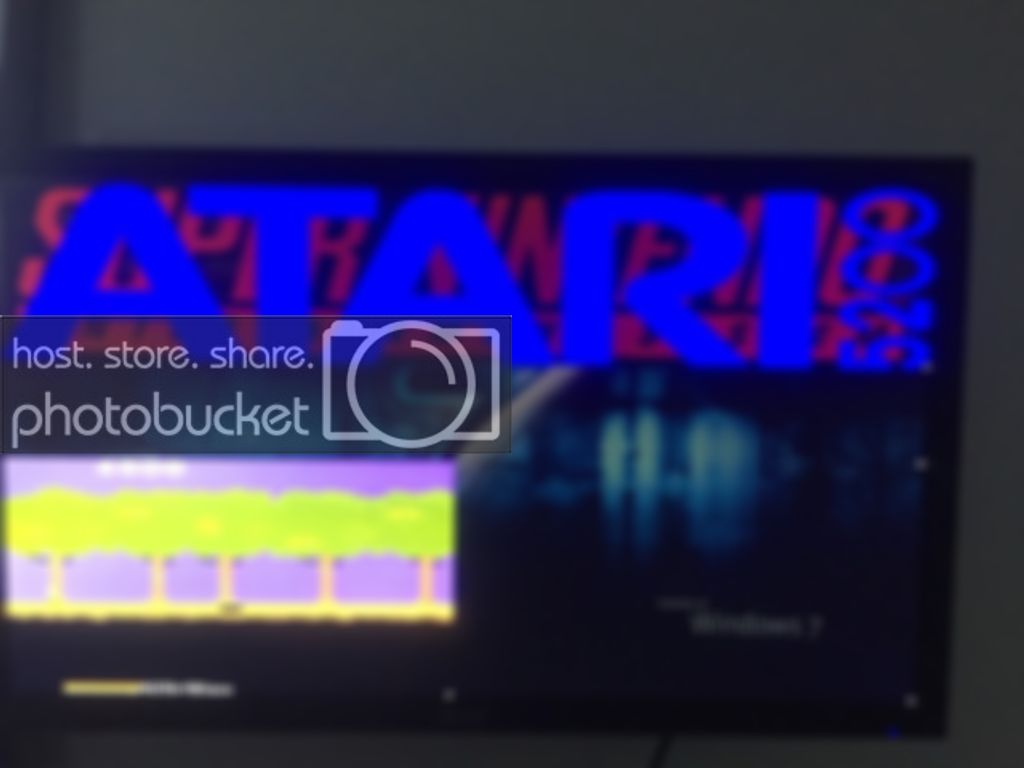

Reefboi16 Posted December 23, 2015 Posted December 23, 2015 Any way to get my marquee to not keep opening one on top of another? I have already tried installing HM and EDS freshly with no luck. It's only the marquee doing it. Video,game info, and other art does not do this.
sevenseal Posted December 23, 2015 Posted December 23, 2015 Any way to get my marquee to not keep opening one on top of another? I have already tried installing HM and EDS freshly with no luck. It's only the marquee doing it. Video,game info, and other art does not do this.do you have eds for that hypermarquee type set to pipe?
Reefboi16 Posted December 23, 2015 Posted December 23, 2015 Yes it is. Should I move over to Eds thread? I believe all my HM settings are good because everything opens fine it's the stacking that messes it up.
sevenseal Posted December 23, 2015 Posted December 23, 2015 Yes it is. Should I move over to Eds thread? I believe all my HM settings are good because everything opens fine it's the stacking that messes it up.what exactly do you mean by stacking, can you put a screenshot of the issue that you are describing?
Reefboi16 Posted December 23, 2015 Posted December 23, 2015 Ok so here it is. As you see the Atari marquee is opening over the supernintendo marquee. Behind the SNES marquee there are several others. They keep opening when it gets to a certain number everything starts acting funny they never close, even if I select the CBR.
sevenseal Posted December 23, 2015 Posted December 23, 2015 Ok so here it is. As you see the Atari marquee is opening over the supernintendo marquee. Behind the SNES marquee there are several others. They keep opening when it gets to a certain number everything starts acting funny they never close, even if I select the CBR. would you be interested in doing a teamviewer session to deal with this issue?
