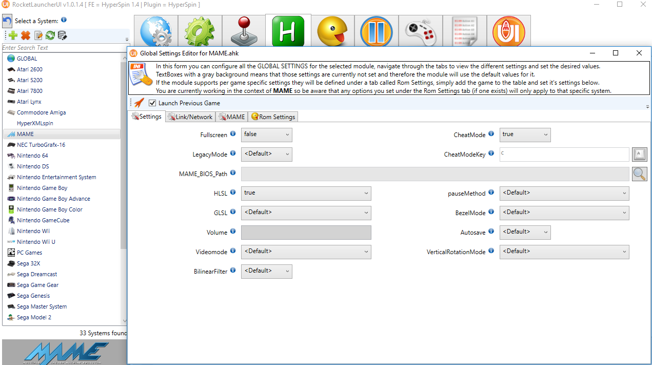

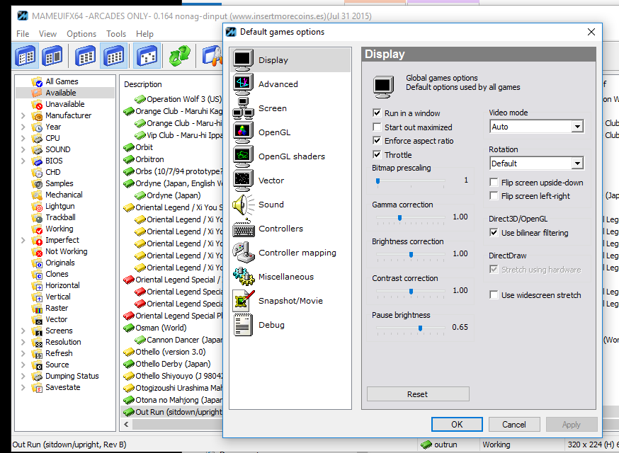

sevenseal Posted November 29, 2016 Posted November 29, 2016 what video mode is mame on, gl? d3d, and what hlsl setting are you using... using hlsl setting can force fullscreenthe picture is set to auto, which is not the samething set as one or the other
CarloCGC Posted November 29, 2016 Posted November 29, 2016 I think Mame is set to Auto on video mode and HLSL is set to enabled. I am happy for you to check remotely.

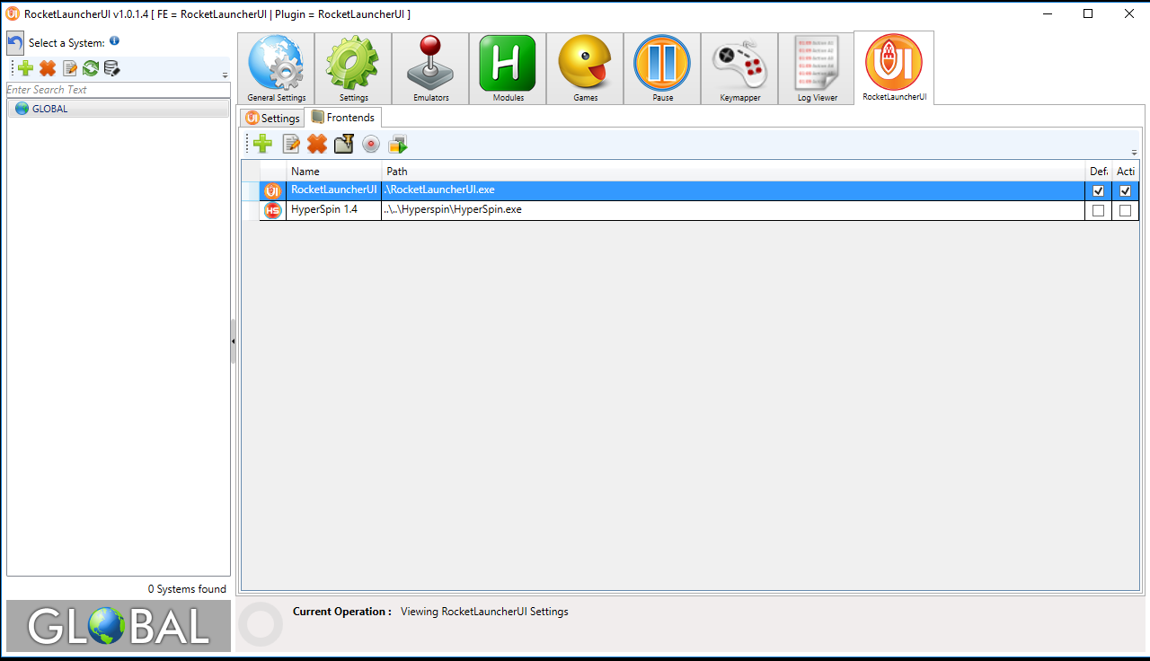

sevenseal Posted November 30, 2016 Posted November 30, 2016 Ive taken another look at my RL and HS setup and both are installed to the root of drive F: in their own folders F:\RocketLauncher\RocketLauncher.exe F:\Hyperspin\HyperSpin.exe Is this correct? or is it not what you meant? Here is a video of EDS forcing my cursor to the corner: Thanks again Sevenseal. [emoji4] http://www.rlauncher.com/wiki/index.php?title=RocketLauncher_Troubleshooting#I_just_setup_RocketLauncher_and_my_Front_End_does_not_show_up_in_RocketLauncherUI_and.2For_all_my_systems_are_not_therefor rl default frontenddoes it do that when you dont use gui because when you run your hs it does not use gui program?
CarloCGC Posted November 30, 2016 Posted November 30, 2016 Do you mean when using RL as the front end like this:

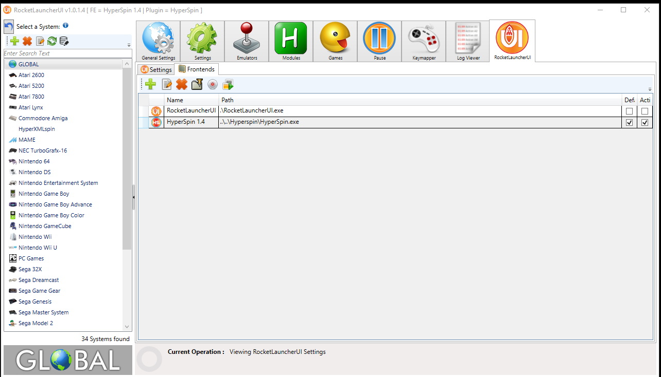

sevenseal Posted November 30, 2016 Posted November 30, 2016 Do you mean when using RL as the front end like this: your default should be hs not rlui
CarloCGC Posted November 30, 2016 Posted November 30, 2016 It is usually. i have just changed it because i thought that was what you meant This is how it normally is:
