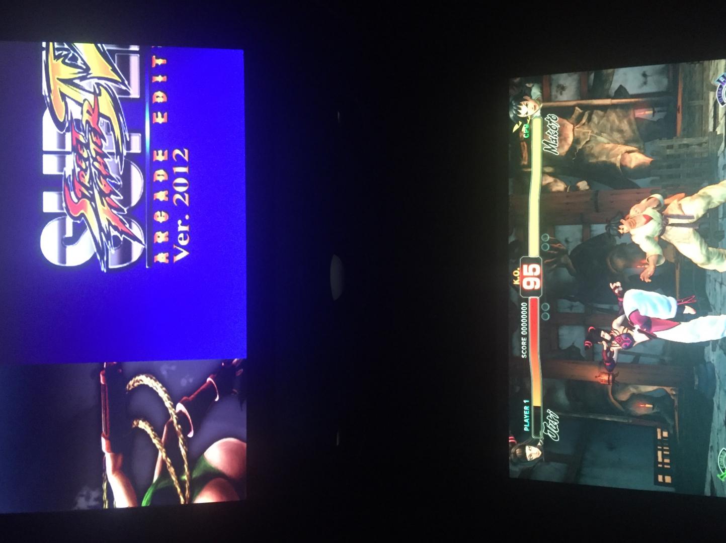

danwelsh Posted July 19, 2016 Posted July 19, 2016 Hi guys, I'm hoping you can help me with this problem.....my marquees display fine with mame but not so good with some ttx games, is there a way to correct this? Solved this- had to change my windows resolution to match the game I'm lovin my arcade
danwelsh Posted July 19, 2016 Posted July 19, 2016 Hi guys, I'm hoping you can help me with this problem.....my marquees display fine with mame but not so good with some ttx games, is there a way to correct this? I'm lovin my arcade
shitoken Posted July 19, 2016 Posted July 19, 2016 Hi guys, I'm hoping you can help me with this problem.....my marquees display fine with mame but not so good with some ttx games, is there a way to correct this? Hi Danwelsh , are you having any problems with some of the ttx games screen goes black if having 2 screens?
danwelsh Posted July 19, 2016 Posted July 19, 2016 Hi Danwelsh , are you having any problems with some of the ttx games screen goes black if having 2 screens? No just the marquee is misplaced on the top screen like the picture shows, the only ttx games that I can get to work right now are those with the typex_loader, the xb_loader ttx games will not work for me I'm lovin my arcade
sevenseal Posted July 19, 2016 Posted July 19, 2016 Hi guys, I'm hoping you can help me with this problem.....my marquees display fine with mame but not so good with some ttx games, is there a way to correct this?many ttx run in fullscreen mode by defualt... it help to know that to have multiple display setup you need to run all your programs in windows mode.fullscreen is normally dedicated to one screen only, exception on some modern programs
danwelsh Posted July 19, 2016 Posted July 19, 2016 Hi guys, I'm hoping you can help me with this problem.....my marquees display fine with mame but not so good with some ttx games, is there a way to correct this? Solved this- had to change the windows resolution to match the game I'm lovin my arcade
danwelsh Posted July 19, 2016 Posted July 19, 2016 many ttx run in fullscreen mode by defualt... it help to know that to have multiple display setup you need to run all your programs in windows mode. fullscreen is normally dedicated to one screen only, exception on some modern programs I had my resolution set at 1680x1050 sevenseal, changed it to match sfiv resolution and it fixed it although I had to reposition all of my marquees again....would it be better to run in windowed mode? I'm lovin my arcade
sevenseal Posted July 19, 2016 Posted July 19, 2016 I had my resolution set at 1680x1050 sevenseal, changed it to match sfiv resolution and it fixed it although I had to reposition all of my marquees again....would it be better to run in windowed mode?if you want to deal with more than one display, it best that you do windows modefullscreen forces same resolution throughout all display
