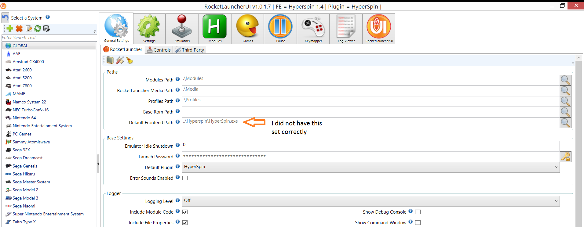

danwelsh Posted September 10, 2016 Posted September 10, 2016 Well looks like I'm still having the problem with my setup Antos and Sevenseal, HS won't regain focus without hitting escape for as many instances I have running of HM before it regains focus.....I really want to use this program but can't use it like it is. I thought it was because of HLSL settings in mame but same problem persists. I hope you guys can help me resolve this. I'm lovin my arcade
sevenseal Posted September 10, 2016 Posted September 10, 2016 Well looks like I'm still having the problem with my setup Antos and Sevenseal, HS won't regain focus without hitting escape for as many instances I have running of HM before it regains focus.....I really want to use this program but can't use it like it is. I thought it was because of HLSL settings in mame but same problem persists. I hope you guys can help me resolve this.are you using d3d or opengl on mame?
Antos Posted September 10, 2016 Author Posted September 10, 2016 Well looks like I'm still having the problem with my setup Antos and Sevenseal, HS won't regain focus without hitting escape for as many instances I have running of HM before it regains focus.....I really want to use this program but can't use it like it is. I thought it was because of HLSL settings in mame but same problem persists. I hope you guys can help me resolve this. Please tell us more about your dual display. I.e. your windows virtual screen locations. Does your second display is virtually top, left, right compare to your main one? HyperMarquee & Event Dispatch System
danwelsh Posted September 10, 2016 Posted September 10, 2016 Persistance pays off.....I found the problem guys, my frontend wasnt set correctly in RL, finally I can use this awesome program again I'm lovin my arcade
