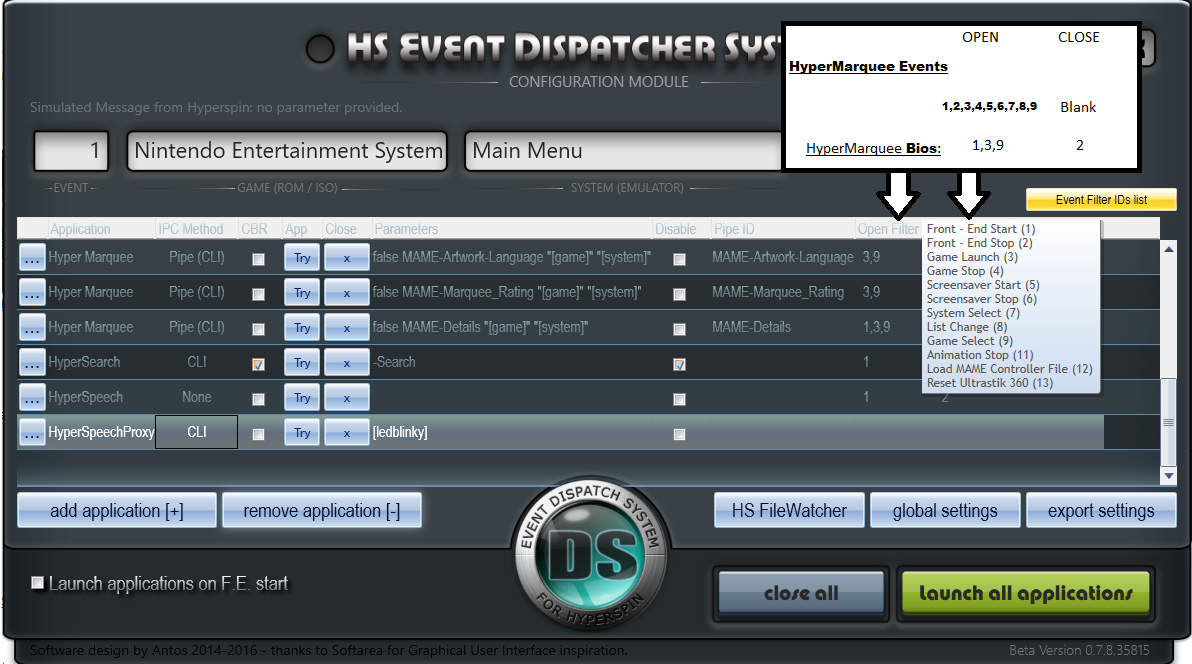

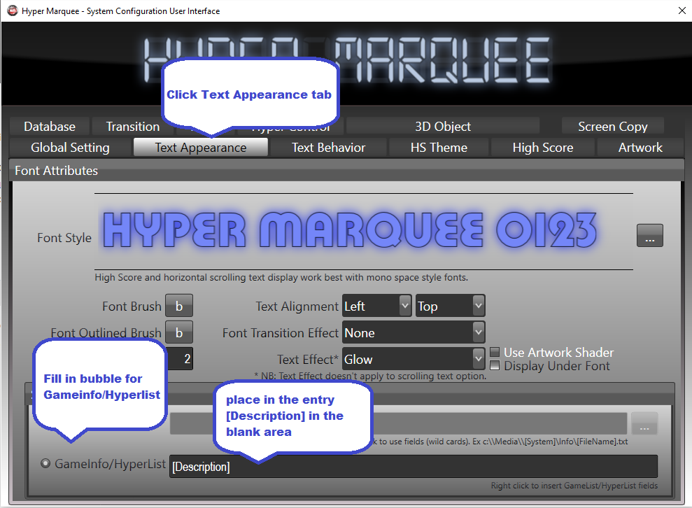

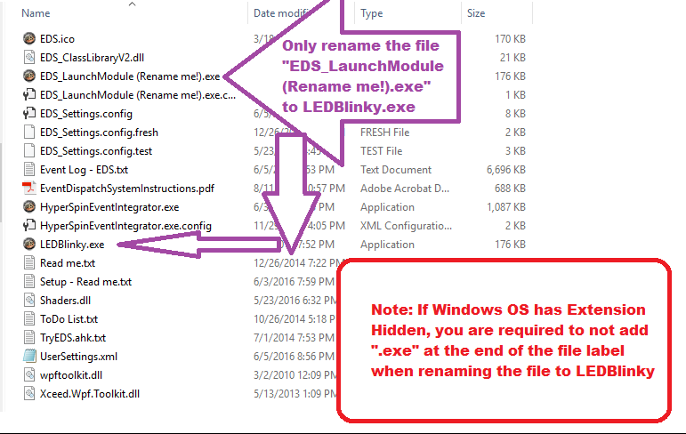

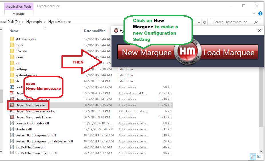

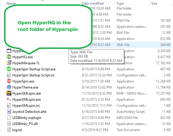

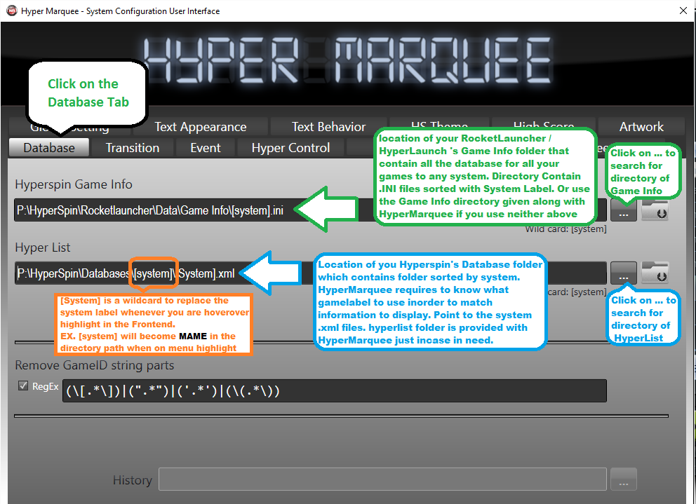

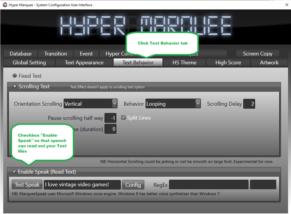

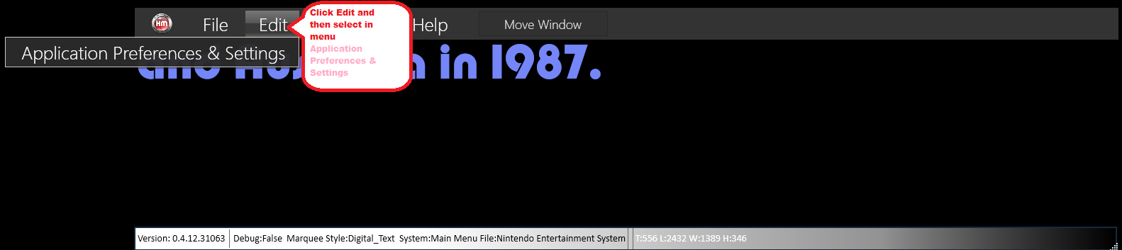

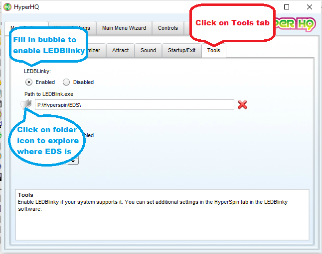

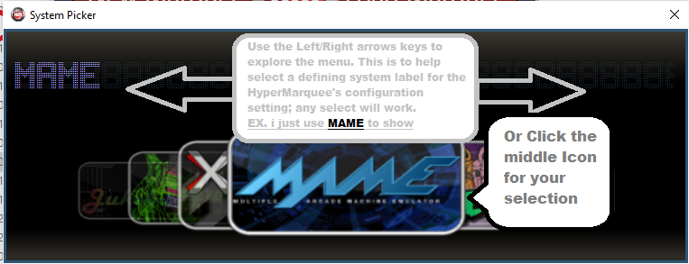

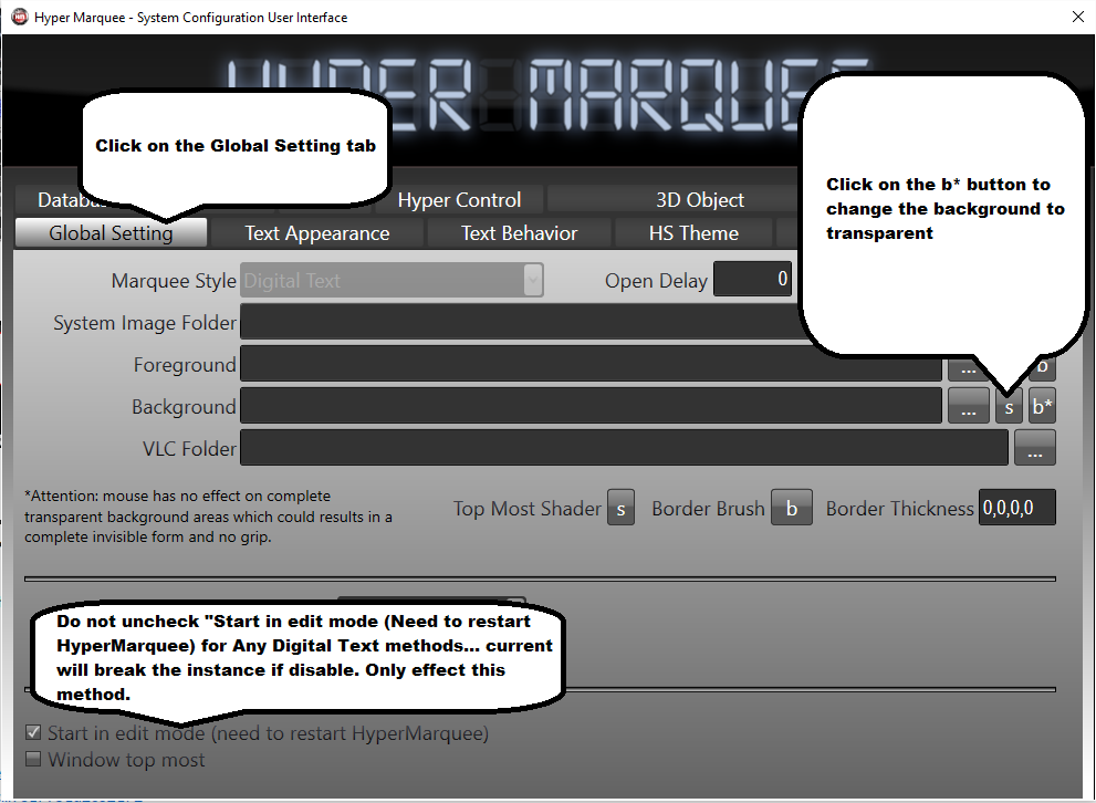

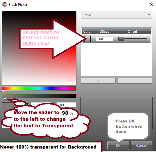

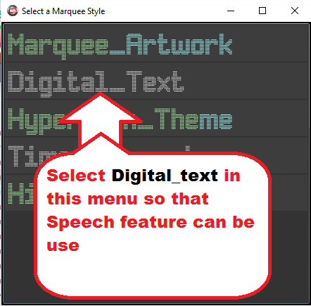

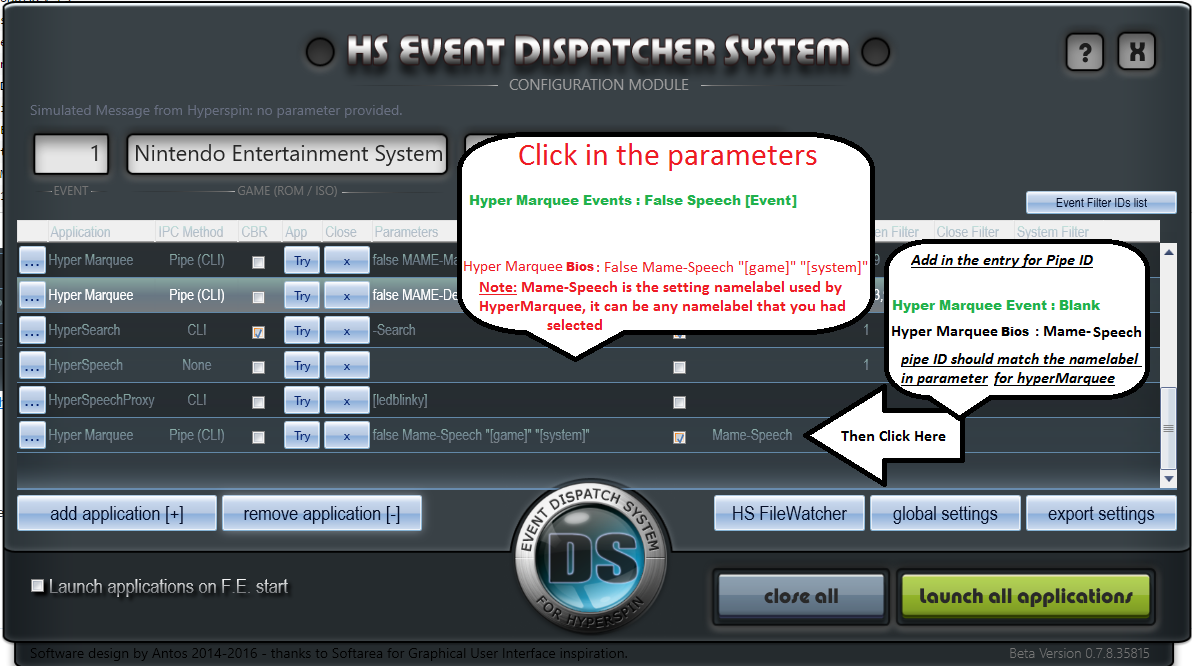

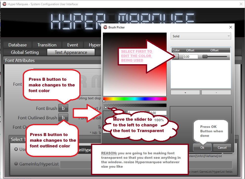

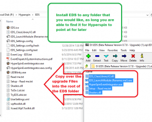

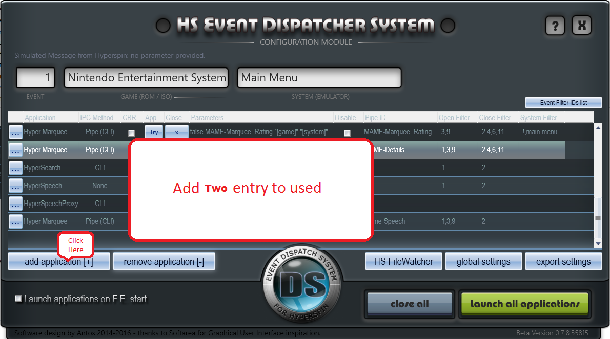

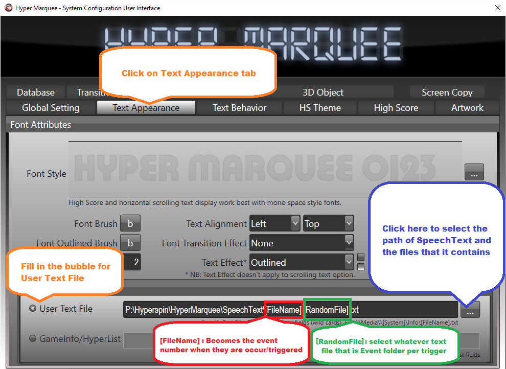

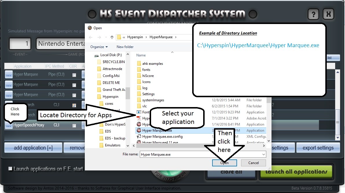

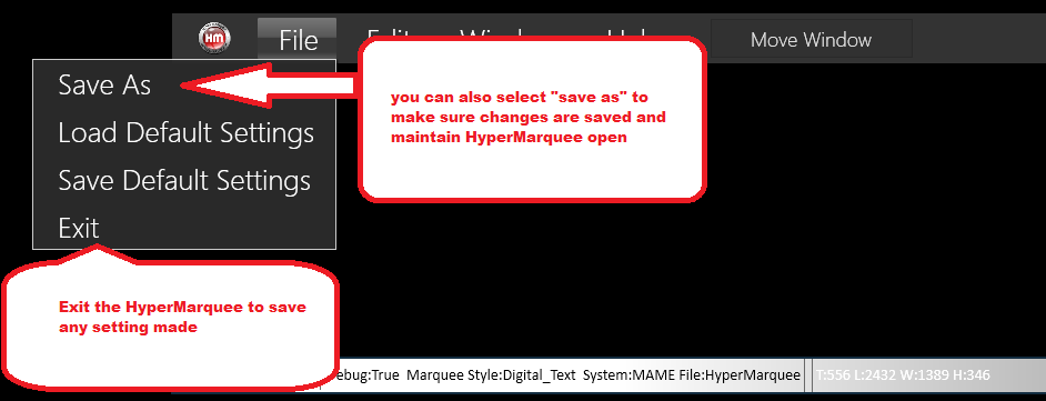

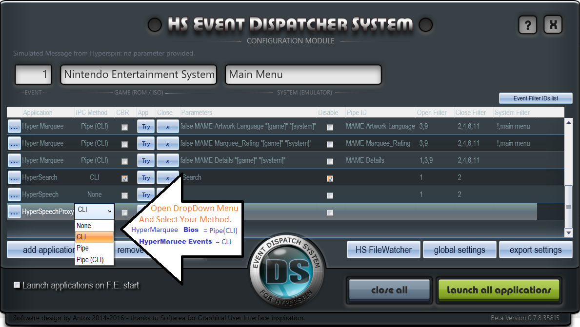

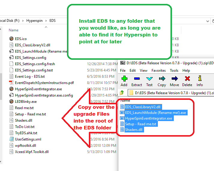

sevenseal Posted June 4, 2016 Posted June 4, 2016 HyperMarquee & EDS Speech Tutorial Guide 06/05/2016 - Antos had done the work to replace HyperSpeech with HyperMarquee/EDS THIS GUIDE IS MEANT TO HELP YOU NAVIGATE THROUGH THE MENU AND SHOW YOU WHERE TO PRESS BUTTONS/CHECKMARK OPITIONS, ONLY FOLLOW THE BUBBLE MESSAGE DIRECTIONS TO COMPLETE EACH TASK, THE BUBBLE MESSAGE ARE THE MAIN FOCUS OF THE SETUP. WARNING SCREENSHOTS ARE EXAMPLES OF MENU AREAS, NOT MEANT TO BE EXACT SETUP COPY. Proof of Concept Add Main Menu.ini to Rocketlauncher\Data\Game Info\This was the data that was adapted over from HyperSpeech to HyperMarqueethis file here is the System's Bios that is used on the Main Menu when highlight over each systemif you have more updated system bios for current system, please feel free to share with me so that i can update it. or you can update yourself if you edit the ini fileLast updated on 06/09/2016Main Menu.zipInstall in the Root folder of HyperMarqueeThis folder contains all the messages for each event that occurs in Hyperspin, so it will speech just like Hyperspeech.SpeechText.zip INSTALLING and SETUP EDS with HYPERSPIN STEP 1: STEP 2: STEP 3: STEP 4: To Setup EDS with Hyperspin, please refer to Manual that is provide with the EDS install.http://www.hyperspin-fe.com/files/file/7391-hyperspin-event-dispatch-system-eds/if you need help or support please go the EDS's Threadhttp://www.hyperspin-fe.com/topic/9006-hyperspin-event-dispatch-system-eds/ SETTING RESULT FOR = EDS's Speech for Bios and Events Configure EDSSTEP 1:STEP 2: YOU WILL BE SELECTING BOTH APP ENTRY AS HYPERMARQUEE STEP 3:STEP 4:STEP 5:ALL done for EDS Now to HyperMarquee SETTING FOR = Hypermarquee's Speech for System & Game BiosTo Setup HyperMarquee with EDS, please refer to Manual that is provide with the HyperMarquee install.http://www.hyperspin-fe.com/files/file/7397-hypermarquee/if you need help or support please go the HyperMarquee's Threadhttp://www.hyperspin-fe.com/topic/9012-hypermarquee/STEP 1:STEP 2:STEP 3:STEP 4:STEP 5: STEP 6: STEP 7:STEP 8: STEP 9: SETTING FOR = Hypermarquee's Speech for Events Speech STEP 1 to STEP 6: Repeat from hypermarquee system and game bios STEP 7: STEP 8: STEP 9: STEP 10: STEP 11: DONATION:Antos: https://www.paypal.com/ca/cgi-bin/webscr?cmd=_flow&SESSION=Eg4O-6Pswp8pbC-nX_k-t-KISdBI2vbpcgFmLIKShYRC383cNL0N7DNUQde&dispatch=5885d80a13c0db1f8e263663d3faee8dcce3e160f5b9538489e17951d2c62172Sevenseal: https://www.paypal.com/us/cgi-bin/webscr?cmd=_flow&SESSION=xv8xt4wUB-Ju8ct4waQDQv56QHCWZsuptN5_U0jNCBDWxHYkfhOm9DzbNzm&dispatch=5885d80a13c0db1f8e263663d3faee8dcce3e160f5b9538489e17951d2c62172
