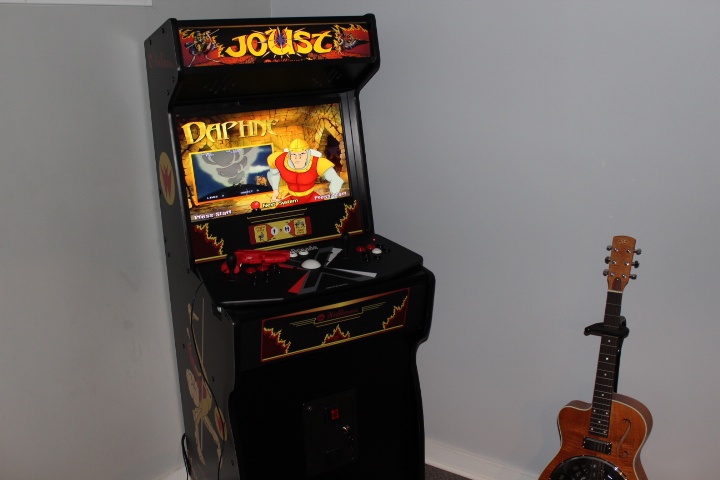

classicradios Posted December 21, 2013 Posted December 21, 2013 Whoa!!! wait a minute, I just ran HyperSpin.exe as Administrator and all speech works! The Main Wheel systems, Bios,etc all working. I'll try the .sdb fix and report back. Stay tuned.... Nope, the .sdb doesn't work on HyperSpin.exe either. I still have to right click HyperSpin.exe and "Run as Administrator" to get speech to work on main wheel systems/bios. Maybe it's a Windows 8 thing? Here's the Arcade I've been setting up
