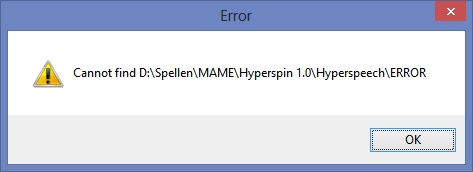

BlackPredator72 Posted January 31, 2013 Posted January 31, 2013 Thanx for the new version but when I try to start HyperSpeech.exe manually (or in HyperSpin) I'll get the following error : When I put back the old HyperSpeech.exe in the new HyperSpeech folder I don't get the error. My Gamercard
bb_neo Posted January 31, 2013 Posted January 31, 2013 Same here :-( Only a different path but is end with HyperSpeech\ERROR
BoOgieman Posted January 31, 2013 Author Posted January 31, 2013 Thanx for the new version but when I try to start HyperSpeech.exe manually (or in HyperSpin) I'll get the following error :[ATTACH=CONFIG]23649[/ATTACH] When I put back the old HyperSpeech.exe in the new HyperSpeech folder I don't get the error. Sorry mate, I think I upped a wrong version by mistake, I also get the error also with that exe from the FTP... I've uploaded the one that was running all afternoon on my desktop... Please check again HyperSpeech - Text-To-Speech Voice Addon for HyperSpin
