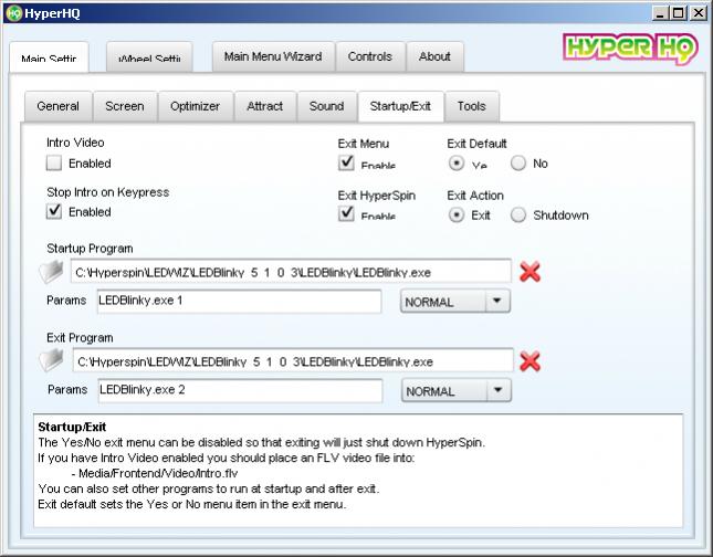

Natdiamond Posted June 17, 2014 Posted June 17, 2014 Hyperspeech is great. Ivona Amy sounds great with it. I turned off reading the bios as I thought it was a bit too much. I like it when it just says the system names and the game names and the chatter in between. I am having an issue with hyperspeech + ledblinky + XBMC. With just ledblinky enabled, all the systems work and blink. But if I want it to dance to the music with XBMC I have to use this setting in hyperHQ: Now, when I do that, then start HS. the led's blink for a bit. then shut down until I enter a system and go back to the main wheel. Then they don't stop working again. Not a huge deal because this setting makes XBMC lights dance when I use that. HOWEVER, once I point LEDBLINKY to hyperspeech to activate it. the XBMC lights don't dance anymore. All other ledblinky functions work the same. So something with the fact that I have hyperHQ set to run XBMC on it's own from the wheel is not communicating with hyperspeech?
