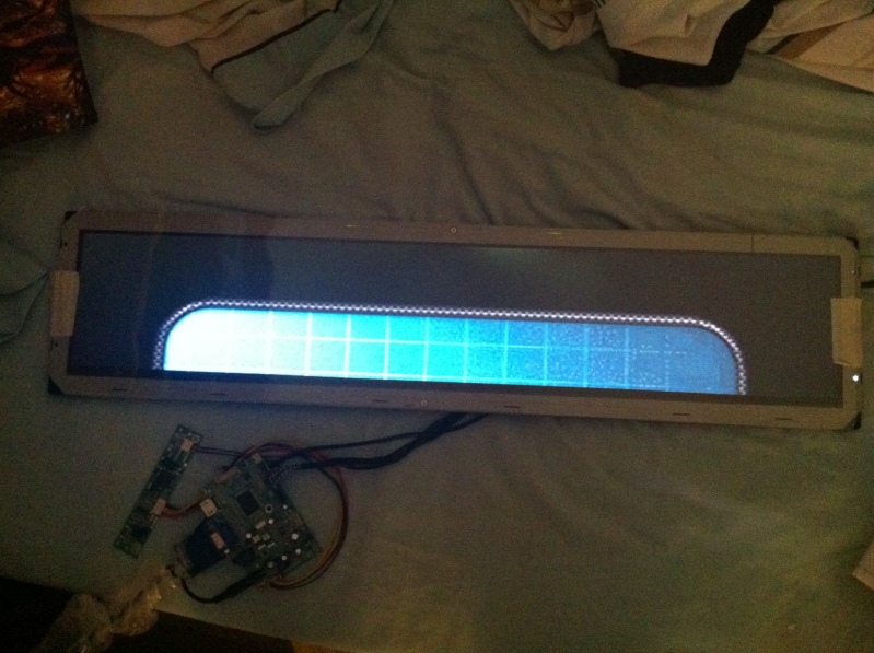

I've been speaking with Vitrolight about their stretched bar LCDSs. They have a 16:3 1920x360 screen that would be perfect, but they can only offer it in proper full screen if it's over USB. HDMI/DVI will result in 2/3 of the screen cut off.
I don't have any experience with USB screens. Would it work exactly the same in Windows and with this program?

I have a flag in the program for the Vitro displays. It will account for it only showing the 1/3 screen.

Turns out that with the Vitrolight display, if you get it with any standard display input like HDMI/DVI it will only display as 1/3 of the image, but if you get it with VGA they offer a USB decoder that will correctly display in full screen. I'm putting an order in so will let you how it turns out.

Is this a vitrolite display? Set "showtopthirdofmarquee" to true and see if that works.
Info on HyperspinHelper Software: http://hyperspinhelper.wordpress.com. Allows you to enable two additional displays as a Marquee and a controls help screen as well as map UltraStik 360 controls. Works exclusively with Hyperspin.
monitor is "vitrolight".
Change set, same problem.
Did you restart the program after changing the settings? I don't know that it will fix it but it definitely shouldn't look the same with that setting.

Glad we got it working. That looks fantastic! Now you are making me want to get one of those displays.
