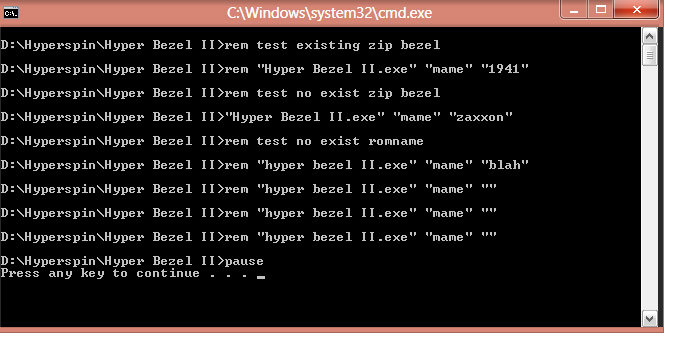

Pyramid_Head Posted March 1, 2013 Posted March 1, 2013 It doesn't seem to do anything. Here is a screen shot of the test window (test is set to true) When I hit continue it closes. I know it's something I'm doing wrong. Sometimes I misread shit and fuck it up LOL
chillinwater Posted March 1, 2013 Author Posted March 1, 2013 then I can only guess that you have these settings like this: disable_vertical=true disable_horizontal=true Game\Theme\Favorites\Genre - List Creation * FatMatch File Renaming for HyperNewbies. Like Me! https://hyperspin-fe.com/forums/topic/259-setting-up-un-official-systems-with-hyperspin/?do=findComment&comment=31034
chillinwater Posted March 1, 2013 Author Posted March 1, 2013 make disable horizontal=true leave the other alone let me get you on chat sending a request Game\Theme\Favorites\Genre - List Creation * FatMatch File Renaming for HyperNewbies. Like Me! https://hyperspin-fe.com/forums/topic/259-setting-up-un-official-systems-with-hyperspin/?do=findComment&comment=31034
Pyramid_Head Posted March 1, 2013 Posted March 1, 2013 Same thing. I'm not sure what's going on man lol.
chillinwater Posted March 1, 2013 Author Posted March 1, 2013 did you re-download the .exe and settings II.ini ?? I cant chat with you for some reason Game\Theme\Favorites\Genre - List Creation * FatMatch File Renaming for HyperNewbies. Like Me! https://hyperspin-fe.com/forums/topic/259-setting-up-un-official-systems-with-hyperspin/?do=findComment&comment=31034
