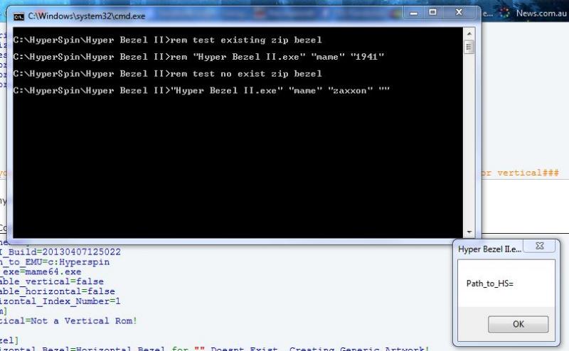

Looks like a great program however I cannot get this to work.
I believe I have followed the steps in the first post. I have copied the _Generic_Bezel folder over to C:\Hyperspin\Emulators\Mame\Artwork
This is my settingsII file but please note that the path actually does have the back slashes. This is what it looks like in my txt editor - Path_to_EMU=c:\Hyperspin\
Not sure why it is not showing up below.
#\\\Hyper_Bezel_Settings\\\#
[General]
Test=true

This is my log file:
[General]
HBII_Build=20130407125022
emu_exe=mame64.exe
disable_vertical=false
disable_horizontal=false
Horizontal_Index_Number=1
[Rom]
Vertical=Not a Vertical Rom!
[bezel]
Horizontal_Bezel=Horizontal Bezel for "" Doesn't Exist, Creating Generic Artwork!
[Horizontal_Index_1]
Horizontal_Lay_File=horizontal43mrdo.lay
Files_In_List=6
Random Number=3

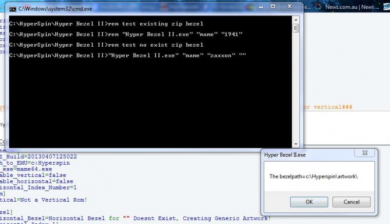

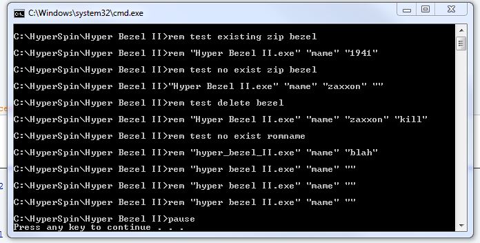

Here are some screen grabs when running the test:
Basically the only thing I have seen happen is the "Zaxxon" folder being created but nothing in it in the c:\Hyperspin\Artwork folder but nothing else.
If you need more info just ask and any help would be appreciated.

You need to put test to false in the settings II file before it will show in mame while your running hyperspin.
A boy stuck in a mans body

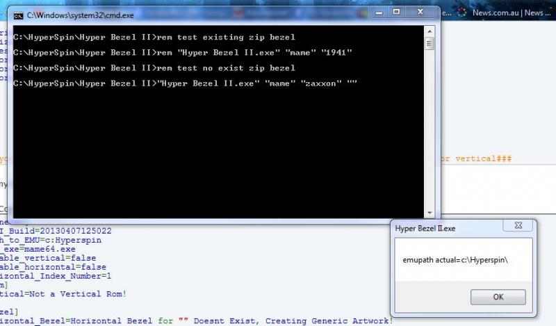

Okay... did that but still nothing. When I run Hyperbezel II nothing happens. A HBII icon flashes up briefly in the system icon tray on the lower right of my PC and then disappears and nothing actually happens. This is strange?!

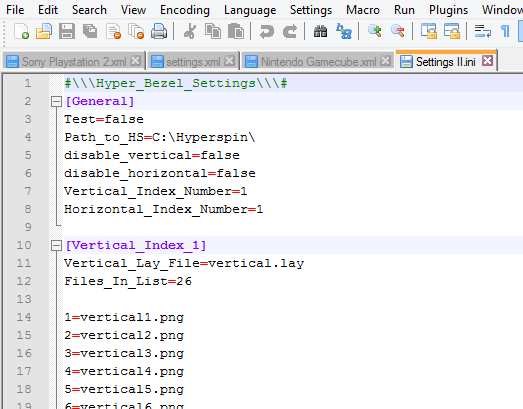

Edit: I've noticed in the original instructions and your SettingsII.ini that it says:
Path_to_HS=C:\Hyperspin\
but mine says:
Path_to_EMU=C:\Hyperspin\
What's the go with that?.... also....
Does the exe=mame64.exe need the full path of the executable or have I done that right? I believe this is the only thing I changed in the .ini file.
I'm not home right now. So couldn't tell u about the path stuff. But also I'm using I version older then what is out I believe. I'm going to probably uninstall it cause I'm using hyperspin helper and the don't work nice together. When I get home I can walk u through it all the way.
Sorry about the confusion. I meant to post the last two messages on my thread and accidentally posted them here. My deepest apologies.
Info on HyperspinHelper Software: http://hyperspinhelper.wordpress.com. Allows you to enable two additional displays as a Marquee and a controls help screen as well as map UltraStik 360 controls. Works exclusively with Hyperspin.
Sorry...real life and all that!!!
This is my fault...
I didn't update the instructions on the first post but the path...
With a recent update to make HBII work with all FE's the path is now Path to the emu . I.e. c:\hyperspin\emulators\mame\
Or wherever your mame is...Sorry about that!!!
The change occurred post#122 http://www.hyperspin-fe.com/forum/showthread.php?23879-New-App!-Hyper-Bezel-II&p=232054&viewfull=1#post232054
"Your" Path_to_ EMU =c:\Hyperspin\
is wrong!!
I'll be catching up with real life stuff this week so I can update first post and get back to the next update.....till then!!!!
@orbital,lol np!!!
Oh and turn test off and post the log.txt in the Hyper Bezel II folder :)
Thanks! Here is my Log after changing it to C:\Hyperspin\Emulators\Mame\
[General]
Path_to_EMU=c:\Hyperspin\Emulators\Mame\
emu_exe=mame64.exe
[Rom]
[bezel]
Files_In_List=6
Random Number=6

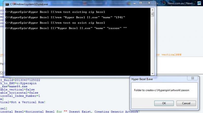

The test now creates a Zaxxon folder in Mame\Artwork but when I disable test andrun it, it doesn't create any for my roms. How does it actually look for the roms to filter through?
My roms are stored like this C:\Hyperspin\Emulators\Mame\Roms
Did you copy the folder \_generic_bezels\
from \Hyper Bezel II\_generic_bezels\
to your
mame\artwork\_generic_bezels\
folder?
It doesn't look for your roms per say, it looks for existing (zipped artwork...romname.zip) in the artwork folder.
If it finds some it closes and does nothing.
It does read which roms are valid as vertical or horizontal in "horizontal_roms.ini" and "vertical_roms.ini".
It only creates (1) bezel at a time and only when you run it.

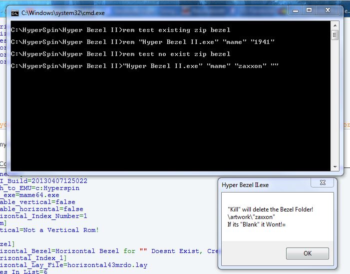

Also, make sure your not using "kill" in your test...
it deletes the folder almost immediately so you wouldnt even see it.
Lastly...
I notice in your settings II.ini you have (2) vertical_index1 sections...remove one of those.
The "log.txt" should show a romname in there somewhere.
