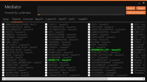

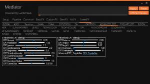

gigapig Posted December 18, 2015 Posted December 18, 2015 I just remembered I can't test it because my 770 GPU has gone back to MSI and Demul 0.7a seems only to have the DX11 plugin. Here's what I know anyway. When you start up the Reshade Mediator it probably asks for you to point to the program you want to Shade. Once done it will try to guess which API it's using and with Demul it may guess at DX9 but you can change it to DX10/11. Finish the Wizard. You can click on your shader and here I have up Sweetfx and here you can make adjustments. I think when I added this to Sega Model 2, turning curvature on broke it. Here in the Pipeline I have Advance-CRT and Vignette select. Once you have made you changes I usually click "Apply" and then I go back to the "Setup" tab and click " Permanent Push To Application" You can click the Lazy.net button also and download profiles, but it doesn't help much with Emulators. Let us know how you get on.

scoodidabop Posted December 21, 2015 Posted December 21, 2015 Thanks for the description Giga. Can confirm that curvature does indeed break Sega Model 3. Forgot about vignetting! I should add that. Here's a couple problems I've encountered. First off I can't seem to figure out how to save different settings for different emulators. If I want to add curvature to Demul, for example, I can't because curvature then carries over to Model 3, which breaks it. So hopefully there's a workaround there. Secondly, I've noticed on Demul that the different games run at different resolutions, making the scanlines look good sometimes, while other times they suffer from banding. It's really obtrusive when going from MvC2 (looking good) to Virtua Fighter 4 (looking awful).

guyverjay Posted January 14, 2016 Posted January 14, 2016 I just remembered I can't test it because my 770 GPU has gone back to MSI and Demul 0.7a seems only to have the DX11 plugin. Here's what I know anyway. When you start up the Reshade Mediator it probably asks for you to point to the program you want to Shade. Once done it will try to guess which API it's using and with Demul it may guess at DX9 but you can change it to DX10/11. Finish the Wizard. You can click on your shader and here I have up Sweetfx and here you can make adjustments. I think when I added this to Sega Model 2, turning curvature on broke it. Image 6.jpg Here in the Pipeline I have Advance-CRT and Vignette select. Image 5.jpg Once you have made you changes I usually click "Apply" and then I go back to the "Setup" tab and click " Permanent Push To Application" You can click the Lazy.net button also and download profiles, but it doesn't help much with Emulators. Let us know how you get on. Tried this doesn't look very good :-(
gigapig Posted January 14, 2016 Posted January 14, 2016 Tried his doesn't look very good :-( No, I agree. Your better off using the shaders that come with demul.
