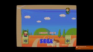

gigapig Posted September 15, 2016 Posted September 15, 2016 Hi guys, Sorry to drag up an old thread.I have had a load of issues getting HLSL so I decided to give GLSL a go. I've successfully enabled the Geom HQ shader and it looks fab on the few games I've tested it on. I'm not, however, seeing any rounded corners etc. I've only applied the shader by editing a single line in the MAME.ini (video opengl / and also referencing the Geom HQ shader). It looks like you can reference multiple shaders in the .ini... so, should I be applying some other effects here to get the rounded screen/corners/bloom/other effects etc? Cheers guys - appreciate it ras Do you have a screen shot? It is kind of subtle on mame compared with the RetroArch version. You would probably adjust it in the shader file.

ras2a Posted September 15, 2016 Posted September 15, 2016 Thanks a lot, guys. Changing the settings in the shader files themselves makes sense! Gigapig, yours looks AMAZING!! Can you share your settings?
gigapig Posted September 15, 2016 Posted September 15, 2016 Thanks a lot, guys. Changing the settings in the shader files themselves makes sense! Gigapig, yours looks AMAZING!! Can you share your settings? There's not much to share other than the glsl folder, I can post that of course. I'm using bgfx at the moment but switched back to opengl for that screen shot.

ras2a Posted September 16, 2016 Posted September 16, 2016 Hi Giga, that's brilliant! I'll get this tried out over the weekend (unfortunately, I'm working late tonight so won't be at home to test). I already have "CRT Geom HQ" configured at the moment, but the shader isn't displaying the 'rounded corners' you posted earlier in your screenshot. I suspect that, at some stage, you've edited the shader file directly to get that CRT 'look'. I'll back up my MAME folder and replace my GLSL folder with yours, updating the .ini files as you've instructed. Really appreciate all your help, mate ras
