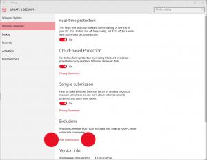

what2be Posted September 1, 2015 Posted September 1, 2015 I looked and WIn Defender is turned off and couldn't see how to add an exception. In windows 10 they call it a exclusion, which is the same thing. Which version of windows are you running? On windows 10 it should look like this: https://www.dropbox.com/s/w52sv4dp3m0vvsf/Screenshot%202015-08-31%2023.40.21.png?dl=0
potts43 Posted September 1, 2015 Posted September 1, 2015 Win 7....just couldn't see an option to add an excision. Clicked on lots of options...
gigapig Posted September 1, 2015 Posted September 1, 2015 Win 7....just couldn't see an option to add an excision. Clicked on lots of options... That's the W10 settings, may not be the same as W7
potts43 Posted September 1, 2015 Posted September 1, 2015 That doesn't look like the page I ended up on. What was the path to it?
Metalzoic Posted September 1, 2015 Author Posted September 1, 2015 I think he showed a Win 10 screen there, mine looks absolutely nothing like that either. I'm running Win 7 64 and it says that Windows Defender was replaced by Windows Security Essentials. My Defender was turned off as well and I added the exclusion to Security Essentials. So add it to whatever anti-virus you're using.
