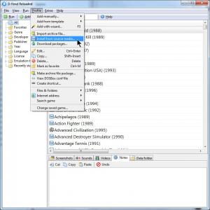

dsync89 Posted July 18, 2015 Posted July 18, 2015 Things would be easier if you use FrontEnd such as D-Fend Reloaded. Yes it might sounds weird to call another Front-End within a Front-End, but D-Fend reloaded definitely will help you create those config files with ease in the long run.

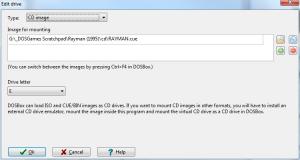

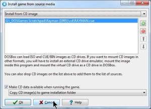

dsync89 Posted July 18, 2015 Posted July 18, 2015 So then I just boot the cfg file? Any tutorials on this? I have not had to make any config files for this yet. I was using Dfend reloaded but it cannot boot iso files and calls an error when it tries after opening dosbox Yes essentially what you need to configure in RocketLauncher is simply setup the ROM to point to D-Fend Reloaded config folder. As for booting the ISO, make sure you added the mounting drive to the script first, which is done automatically if you use the D-Fend Reloaded UI. There is also no need to use Daemon Tools Lite or any Virtual CD tools to mount the ISO. As with all DOS games that requires CD, make sure you first install the game program using the wizard: Let me know if it is still unclear and I'll be more than happy to help you out. More love for the MS-DOS :-)

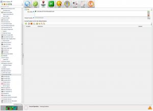

mccorkled Posted July 18, 2015 Author Posted July 18, 2015 I did not install the game using dfend because it is already installed with dosbox. The game works fine when I play it but I am still having trouble getting it to load automatically. I made the config file and put this in it... imgmount d Z:\Hyperspin\Emulators\Microsoft MS-DOS\ROMS\Stonekeep\Stonekeep.iso -t isoc:cd stonkeepsk When I try to load the game in hyperspin I get this error I then added in the emulator information into RLUI and now I am getting this error. Aeon Nox XIII Themes Minted Cases w/ Reflection : Minted Cases : Minted XMLs
