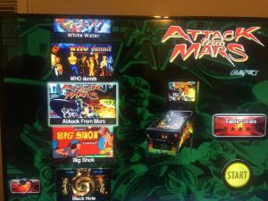

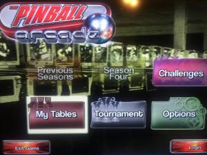

newgames46 Posted October 18, 2016 Posted October 18, 2016 Thanks for the help but it did not work, if I select false (do you have all games)it just stays at the start screen and nothing else and if I select true it goes down to my tables and just stays there.. I just guess it's my old version but what's weird like I said earlier is when I use the ahk in gigapig hyperspin build it works up to ( on if true is selected) the Harley table then on haunted house it goes back to Harley then about 5 tables later (I think) later it gets back to the correct table..strange I guess but the strange thing to me is false seems not to work at all.
Metalzoic Posted October 18, 2016 Author Posted October 18, 2016 Thanks for the help but it did not work, if I select false (do you have all games)it just stays at the start screen and nothing else and if I select true it goes down to my tables and just stays there.. OK we'll just fix it the hard way. I just guess it's my old version but what's weird like I said earlier is when I use the ahk in gigapig hyperspin build it works up to ( on if true is selected) the Harley table then on haunted house it goes back to Harley then about 5 tables later (I think) later it gets back to the correct table..strange I guess but the strange thing to me is false seems not to work at all. That's not weird at all. Like I said earlier that's normal and shows it's working. And the reason false doesn't work at all is because you're trying to use ane an old version the module isn't built for. Here's the other way to fix it since that AHK didn't work. delete the custom one I sent you and go back to using the original (but keep a backup copy of it). Now open the module itself up so it can be edited. 1. Go down to line 71: LastMyTable Make sure it is actually set to the table your table selection actually starts on. If you own the Addams Family table then you don't need to change this line. 2. Now go to line 72: myTables Now delete all the tables that you don't have from this list. When you're done it should be only the tables you actually have, in the correct order. Just make sure you keep the single | that separates each table. Should just take you a couple minutes 3. Now switch All_Tables to = true and delete any tables written into the My-Tables section. That should fix it because now having All_Tables = true is actually true because it will match the table list in the module itself! And now when it is selecting tables it won't be skipping because it won't be accounting for tables that aren't actually there. Here's a tip that applies to pretty much all things HyperSpin/RocketLauncher/Emulators... always use the correct versions of things. With this if you had used the 1.50.10 version game the module was for it probably would have worked first shot. With MAME always make sure your Rom set matches you MAME version matches your CHDs which matches your database. Make sure your Demul version matches your Demul rom set etc... A lot of the problems people have are caused because they're trying to mis-match things

RkH Posted November 30, 2016 Posted November 30, 2016 I have the 1.49.9 version, and i checked that i have your ISD,AHK and Database, but with the new tables it goes a different table than the chosen.
Metalzoic Posted December 1, 2016 Author Posted December 1, 2016 21 hours ago, RkH said: I have the 1.49.9 version, and i checked that i have your ISD,AHK and Database, but with the new tables it goes a different table than the chosen. Right... because your version would be missing a table or two. If you're running an older version you'd need to follow the instructions in the first post for changing yours from All_Tables = True to False. And then Adding your actual tables to the My_Tables section of the module settings. I believe that should do it. You could also search pastebin for my older 1.49.9 module & xml
RkH Posted December 4, 2016 Posted December 4, 2016 On 1/12/2016 at 6:25 PM, Metalzoic said: Right... because your version would be missing a table or two. If you're running an older version you'd need to follow the instructions in the first post for changing yours from All_Tables = True to False. And then Adding your actual tables to the My_Tables section of the module settings. I believe that should do it. You could also search pastebin for my older 1.49.9 module & xml Ok its done, the module updated auto from RL wasn't working, its YOUR module the good one. And the RL is "newer", also your header's module gives error on RL, but it works Frankestein and the others, and I noticed that it enters faster than the "oficial" module. Very good work!!
