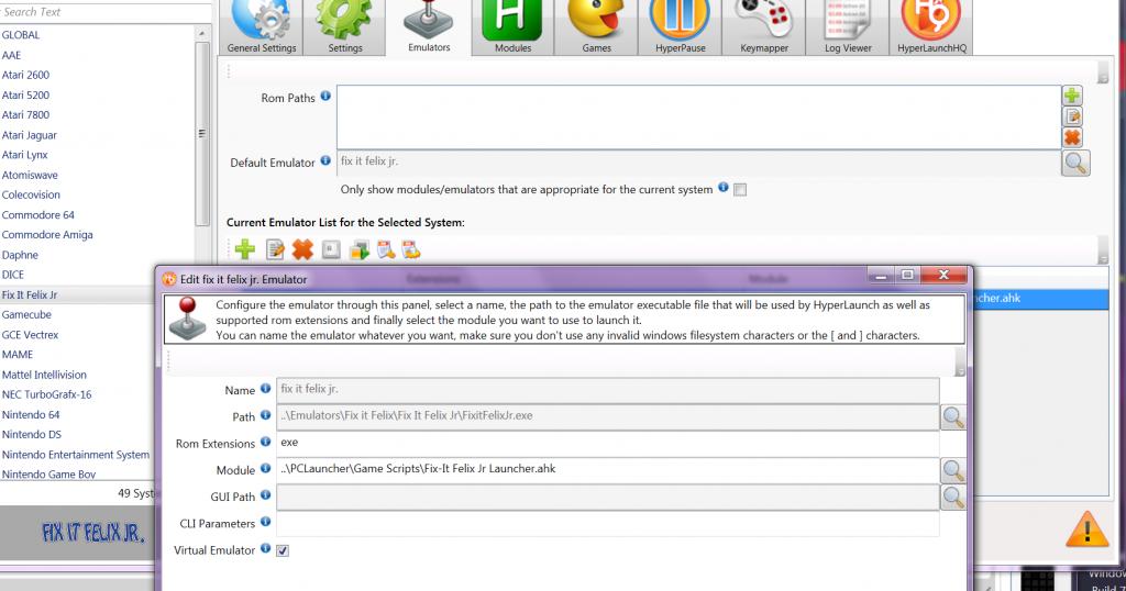

Parsec Posted July 28, 2013 Posted July 28, 2013 30+ wheels but this will be my first time using PCLauncher to get fixit Felix jr. working. I have the game working outside HL. Since this is a "virtual Emulator", On the "Emulators" tab I currently have nothing listed for the roms path. I have the emulator path pointing at the fixit felix jr. exe. For extensions I have "exe" listed. For the module I have "\PCLauncher\Game Scripts\Fix-It Felix Jr Launcher.ahk". When I click on "Launch Emulator" the game runs but when I try to open in Hyperspin nothing happens. I have it set up as a main menu wheel with no sub wheel. What steps am I missing? If anything just point me in the direction of a good PCLauncher tutorial.

gigapig Posted July 28, 2013 Posted July 28, 2013 Also, do I actually need a database file for FFJr. to run this in hyperspin? So in HLHQ have you under global, set up the pclauncher module? Which involves just checking the virtual emulator check box. Then on the left pane do you have system name? I assume it would be Fix it Felix Jr. Make sure you have the latest pclauncher module. So highlight the system name from the left pane. Click emulators tab and chose the default emulator. Then this is where I'm a little fuzzy with this one, having not set it up. You perhaps could add the rom path which may work but instead you could click the modules tab and the icon "edit module settings" if thats the wrong icon and you get a warning then try the one next to it. Sorry for being a little vague. You can then can add FFJ into the settings, here like path etc. That should it. When you created the wheel with no sub wheel, you would have a new entry in the main menu xml. Did HyperHq also create a FFJ system xml in the database folder?
Parsec Posted July 28, 2013 Posted July 28, 2013 No, HSHQ did not set-up a database automatically. In fact it didn't even create a database folder which leads me to believe one is not needed since it's a virtual emulator. I clicked on "Global in the left Nav", then clicked on "Modules" and made sure the "PCLauncher" module is ticked off as a Global module. I believe I have the latest version of the module, 2.0.5. The thing is there is already an .ahk setting module just for Fixit Felix under ...modules/PClanucher/Gamescripts and I made changes to that file to point to my exe and bezel. I'm currently point to that specific felix .ahk file. I feel like a dumA$$. I know this should be easy. Here's what it looks like and when I click the little Launch emulator the game launches (but desktop and everything else does not change)

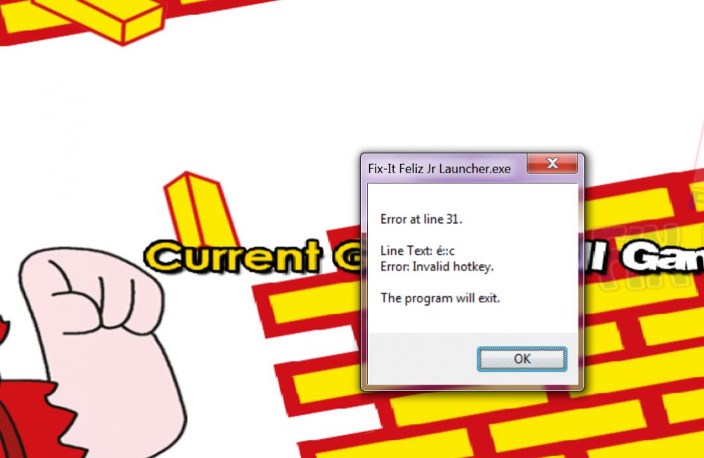

Parsec Posted July 31, 2013 Posted July 31, 2013 OK, after following 32Assassin's nifty instructions I got it to load with my Mame wheel using a wrapped version of FFJ with the same "Press any key" message. Not ideal but getting there. I would like to use the FFJ launcher but the one from the FTP is giving me an error in and out of RL "error in line 31..." So ideally I would like to run the unwrapped version using the FFJ launcher like Giggapig has done but I'm stuck with this error. Maybe I just need to find a different version?
gigapig Posted July 31, 2013 Posted July 31, 2013 OK, after following 32Assassin's nifty instructions I got it to load with my Mame wheel using a wrapped version of FFJ with the same "Press any key" message. Not ideal but getting there. I would like to use the FFJ launcher but the one from the FTP is giving me an error in and out of RL "error in line 31..."[ATTACH=CONFIG]29654[/ATTACH] So ideally I would like to run the unwrapped version using the FFJ launcher like Giggapig has done but I'm stuck with this error. Maybe I just need to find a different version? So I was getting a similar error with launcher I found. The launcher is set up for some else's machine. So the trick is to edit the fix it felix jr launcher.ahk in notepad++. You need to change the paths to you game whichever version your running. Change the path to the bezel or change show bezel to false. That is all I did with that. So save it. Now if you haven't got it install autohotkey. www.autohotkey.com/ Once installed right click on the ahk you just edited and click "compile" You should now have a new file called fix it felix jr launcher.exe. The original pclauncher ini had the correct path and other options already, I just changed the exit method to alt+f4 you can maybe try something else. With regard to the overall setup into your mame wheel. I've used what I've learnt over on the Taito Type x thread. www.hyperspin-fe.com/forum/showthread.php?26741-Taito-Type-X-and-Hyperlaunch-3-0&p=259447#post259447 Whereby you create a games.ini and put it in the "hyperlaunch\settings\mame" folder. I will edit into here later when I get on my pc. That will tell hyperlaunch to use pclauncher instead of mame,to run the game. Sadly I haven't figured out how to close the windows in the wrapper versions, but I'm using the original version for the moment with the bezel. I would suggest you look at the the TTX thread at least the last couple of pages. Boomslangz has brought our attention to something called "Event Ghost", which could be used for fix it felix. Edit: Here is the games.ini from the above folder. # This file is only used for remapping specific games to other Emulators and/or Systems.# If you don't want your game to use the Default_Emulator, you would set the Emulator key here. # This file can also be used when you have Wheels with games from other Systems. # You would then use the System key to tell HyperLaunch what System to find the emulator settings. # [GameName] # Emulator=bsnes # System=Super Nintendo Entertainment System [FixitFelixJr] Emulator=PCLauncher System=MAME

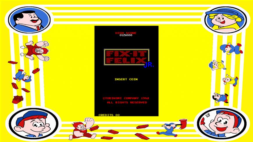

Parsec Posted August 6, 2013 Posted August 6, 2013 Finally got back to this and downloaded autohotkey and edited/compiled the launcher. I've got it running without errors but it looks like the bezel is too big and I it's not changing the resolution for my monitor. Here is the AHK I compiled. gamePath=I:\hyperspin\Emulators\Fix it Felix\Fix It Felix Jr\FixitFelixJr.exe ; the full path and exe of FixitFelixJr.exe BezelPath=I:\hyperspin\Emulators\Fix it Felix\Fix It Felix Jr\bezel.png ; the full path and extension to bezel file zoom=100 ; Frame Resolution-Only 33,50,100,200 are supported YAdjust=0 ; adjusts vertically how far off center from the middle of the screen, 0=center, negative value moves up, positive value moves down XAdjust=0 ; adjusts horizontally how far off center from the middle of the screen, 0=center, negative value moves to left, positive value moves to right title=ahk_class FOCAL Test Shell exitkey=Esc ShowBezel=true BackgroundColor=yellow ; changes background color, see here for available colors: http://www.autohotkey.com/docs/commands/Progress.htm#colors ; rotation=90 ; still need to rotate monitor, no point in having enabled ;---------------------------------------------------------------------------------------------------- Hotkey, ~%exitkey%, Close WinHide ahk_class Shell_TrayWnd WinHide, ahk_class Button SplitPath,gamePath,fileName,fileDir Gui, GUI1: New, -Caption +ToolWindow +OwnDialogs Gui, GUI1: Color, %BackgroundColor% If ShowBezel = true Gui, GUI1: Add, Picture, W%A_ScreenWidth% H%A_ScreenHeight%, %BezelPath% Gui, GUI1: Show, x0 y0 h%A_ScreenHeight% w%A_ScreenWidth% ; rotation := If (rotation=90 || rotation=180 || rotation=270) ? " -rotate=" . rotation . " fullscreen" : "" zoom := If (zoom=33 || zoom=50 || zoom=100 || zoom=200) ? " -zoom=" . zoom : "" Run, %fileName% %zoom% %rotation%, %fileDir% WinWait, %title% WinActivate, %title% winHwnd:=WinActive(title) WinSet,AlwaysOnTop, On, %title% WinSet, Style, -0xC00000, %title% ; Remove border and titlebar DllCall("SetMenu", uint, winHwnd, uint, 0) ; Remove the MenuBar MouseMove, %A_ScreenWidth%, %A_ScreenHeight% ; Met la souris hors écran CenterWindow(title) Process, WaitClose, %fileName% ExitApp ;-----Control Remaps----- ~3::c ;Insert Coin ;~?::1 ;Start Player 1 ;~?::2 ;Start Player 2 ;?::{Left} ;Move Left ;?::{Right} ;Move Right ;?::{Up} ;Jump Up a Level ;?::{Down} ;Jump Down a Level ;?::x ;Fix-It ;?::{LButton} ;Jump ;?::{Shift} ;Fix-It ;?::{F5} ;save ;?::{F6} ;FrameSkip ;?::{F7} ;ScreenShot ;?::{scrlk} ;lock mouse crosshairs to center of screen ;------------------------ CenterWindow(class) { Global YAdjust Global XAdjust WinGetPos, appX, appY, appWidth, appHeight, %class% appXPos := ( A_ScreenWidth / 2 ) - ( appWidth / 2 ) appYPos := ( A_ScreenHeight / 2 ) - ( appHeight / 2 ) WinMove, %class%,, % (appXPos+XAdjust), % (appYPos+YAdjust), appWidthNew, appHeightNew } Close: WinClose, ahk_class FOCAL Test Shell WinShow, ahk_class Shell_TrayWnd WinShow, ahk_class Button Return
