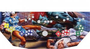

codemonkey76 Posted December 10, 2013 Posted December 10, 2013 Thanks man, I found a nice street fighter graphic on google images and have tweaked it a little.
connorsdad Posted December 10, 2013 Author Posted December 10, 2013 Nice codemonkey76 Sent from my SM-N9005 using Tapatalk

codemonkey76 Posted December 11, 2013 Posted December 11, 2013 How is your acrylic attached to your panel? is just the buttons holding it on?
connorsdad Posted December 11, 2013 Author Posted December 11, 2013 Sandman: I have hdmi out on the cab with a wireless kb and mouse plus a lan port so should be good to carry on setting up even when the cab is put together. Codemonkey76: yes, the artwork is layed on top of the mdf then the acrylic on top of that, the buttons and T - moulding keep it altogether. Sent from my SM-N9005 using Tapatalk
codemonkey76 Posted December 11, 2013 Posted December 11, 2013 Sandman: I have hdmi out on the cab with a wireless kb and mouse plus a lan port so should be good to carry on setting up even when the cab is put together. Codemonkey76: yes, the artwork is layed on top of the mdf then the acrylic on top of that, the buttons and T - moulding keep it altogether. Sent from my SM-N9005 using Tapatalk I have yet to decide on edging, my panel is 25mm thick and the acrylic is 4.5mm, I am struggling to find 30mm T-Moulding... thinking of using 30mm aluminium angle
