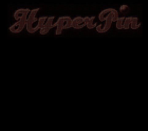

chriz99 Posted January 1, 2011 Author Posted January 1, 2011 thanks for the info, jpcurreri. I figured it out - now it works (after killing explorer.exe) with a standard background image. I finetuned this image for the correct fit on my 19" dmd screen. I need an image/dmd animation with 482x427 pixel for the right position (gstav ): btw, how is the 260.99 working? everything fine, also nudging without problems? and please post some pics of your cab cheers chris [sIGPIC][/sIGPIC] * taito egret 29 candy cabs * indy & star wars pachinkos 17" bartop with ledwiz rgbleds * 10" bubble bobble & galaga bartop * arm champs 2 check out hi-res backglasses * best vpin performance * ledwiz config and software

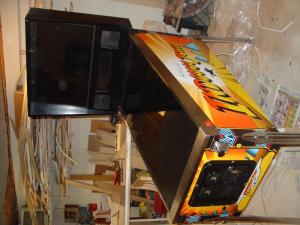

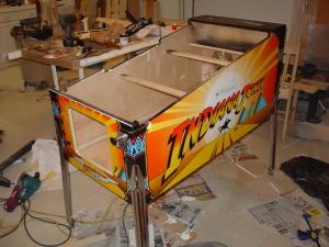

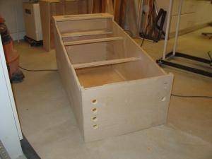

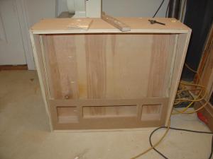

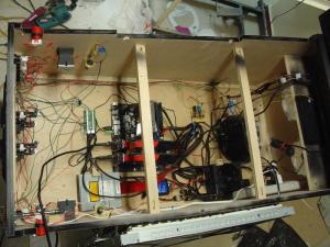

jpcurreri Posted January 1, 2011 Posted January 1, 2011 Unfortunately, the active dmd does not work without explorer but the standard png images are good. The only problem I have with nudging is that the bob hits multiple times. Here a photo of my cab: http://www.hyperspin-fe.com/forum/attachment.php?attachmentid=7335&stc=1&d=1293923444
chriz99 Posted January 1, 2011 Author Posted January 1, 2011 holy smoke my friend, this looks freakin awesome. the indy knight would say "you have chosen.... wisely" is there a thread about your cab? tilt bobs and mercury switch works nice here, especially with new core.vbs file (with tilt/nudge update). cheers chris [sIGPIC][/sIGPIC] * taito egret 29 candy cabs * indy & star wars pachinkos 17" bartop with ledwiz rgbleds * 10" bubble bobble & galaga bartop * arm champs 2 check out hi-res backglasses * best vpin performance * ledwiz config and software
jpcurreri Posted January 1, 2011 Posted January 1, 2011 Thanks for the inspiration. Once I started reading about your project, I had to build one. I get alot of double nudging even with the new core.vbs file. I never started a thread but here is a couple of pics.
