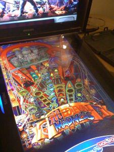

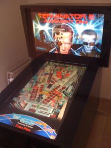

Rawd Posted January 28, 2010 Posted January 28, 2010 Nice work! One question though... Your playfield does not look perfectly centered due to the rounded bezel on the bottom (maybe just an illusion?). Are you able to trim a bit of plastic off the bezel to move it over a little?
njay Posted January 28, 2010 Author Posted January 28, 2010 Well it is centered but when i am going to mount the plexi and spray paint it the left side will be bigger then the right... and i am still not confident enough to remove the whole bezel any ideas? My Mini Pin Build: http://www.hyperspin-fe.com/forum/showthread.php?t=5622 My Arcade Bartop Build: http://www.hyperspin-fe.com/forum/showthread.php?t=14570

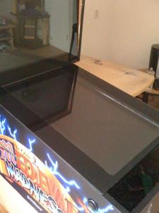

njay Posted February 9, 2010 Author Posted February 9, 2010 Hi, well i got the plexi finally i test fitted it and it fitted like a charm .. but then things happend 1. i dropped one plate of plexi for the backbox when scratch marks , sigh this material scratches really fast you dont see the scratches when the monitor is on but is there a way to polish it? 2. i screwed the backbox plexi to the backbox causing the wood to almost split on those two screws lucky me this will be painted black My Mini Pin Build: http://www.hyperspin-fe.com/forum/showthread.php?t=5622 My Arcade Bartop Build: http://www.hyperspin-fe.com/forum/showthread.php?t=14570
rosezentrier Posted February 10, 2010 Posted February 10, 2010 1. i dropped one plate of plexi for the backbox when scratch marks , sigh this material scratches really fast you dont see the scratches when the monitor is on but is there a way to polish it? 2. i screwed the backbox plexi to the backbox causing the wood to almost split on those two screws lucky me this will be painted black Must pay learning money too Buy again my macrolan on Ebay cost 15 € with shipping. I know now, polycarbonat must you use how you use a DVD (polycarbonat too). For example "cleaning with "microfaser"" Plexi- I don't know about that... I see very little scratch only when light shine directly on the plate. Painting, I want to say again "Thank you very much" to Rawd I have paint it yellow with his idea. It looks very very good. Nothing of paper can do this effect.
njay Posted February 10, 2010 Author Posted February 10, 2010 Yeah i should and can polish it but hey scratches will always be i guess ... i dont see them while playing to its ok for now ,but i know myself that i will replace it eventualy My Mini Pin Build: http://www.hyperspin-fe.com/forum/showthread.php?t=5622 My Arcade Bartop Build: http://www.hyperspin-fe.com/forum/showthread.php?t=14570
kurt Posted February 10, 2010 Posted February 10, 2010 There are agents that can get scratches out of plexi but i think it involves sanding and buffing depending on the scratch. Cab looks nice with plexiglass, well done.
njay Posted February 10, 2010 Author Posted February 10, 2010 Hi Kurt, thanks Yeah the plate is only 14 euros so i will get a new one eventually but i want to finish the cab i am going to spray paint the bezel this afternoon My Mini Pin Build: http://www.hyperspin-fe.com/forum/showthread.php?t=5622 My Arcade Bartop Build: http://www.hyperspin-fe.com/forum/showthread.php?t=14570

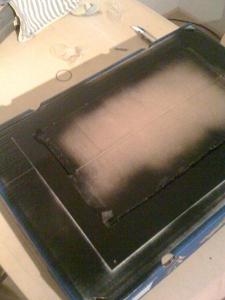

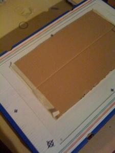

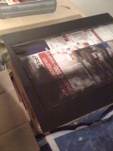

njay Posted February 10, 2010 Author Posted February 10, 2010 Got the bezels done today ! somehow some spray got under the protection , its acrylic paint any idea how to remove the spray stains after its dryed ? My Mini Pin Build: http://www.hyperspin-fe.com/forum/showthread.php?t=5622 My Arcade Bartop Build: http://www.hyperspin-fe.com/forum/showthread.php?t=14570

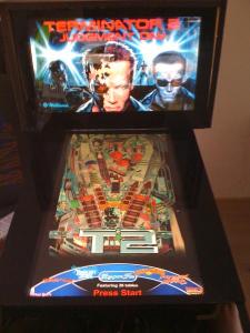

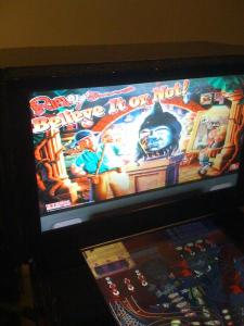

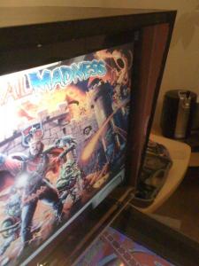

njay Posted February 11, 2010 Author Posted February 11, 2010 some more pics by daylight My Mini Pin Build: http://www.hyperspin-fe.com/forum/showthread.php?t=5622 My Arcade Bartop Build: http://www.hyperspin-fe.com/forum/showthread.php?t=14570
Rawd Posted February 11, 2010 Posted February 11, 2010 Looking really good man. I had a couple of small paint runs as well, but I used oil based paint, so I was able to use a solvent to remove the paint. On my glass I used a razor blade, but I wouldn't recommend that on plexi. It looks like you were able to center the monitor now? Router? Cut bezel? Edit: 26 tables! You have lots of software work to do. I just deleted a bunch of my tables to bring me back to 230.
