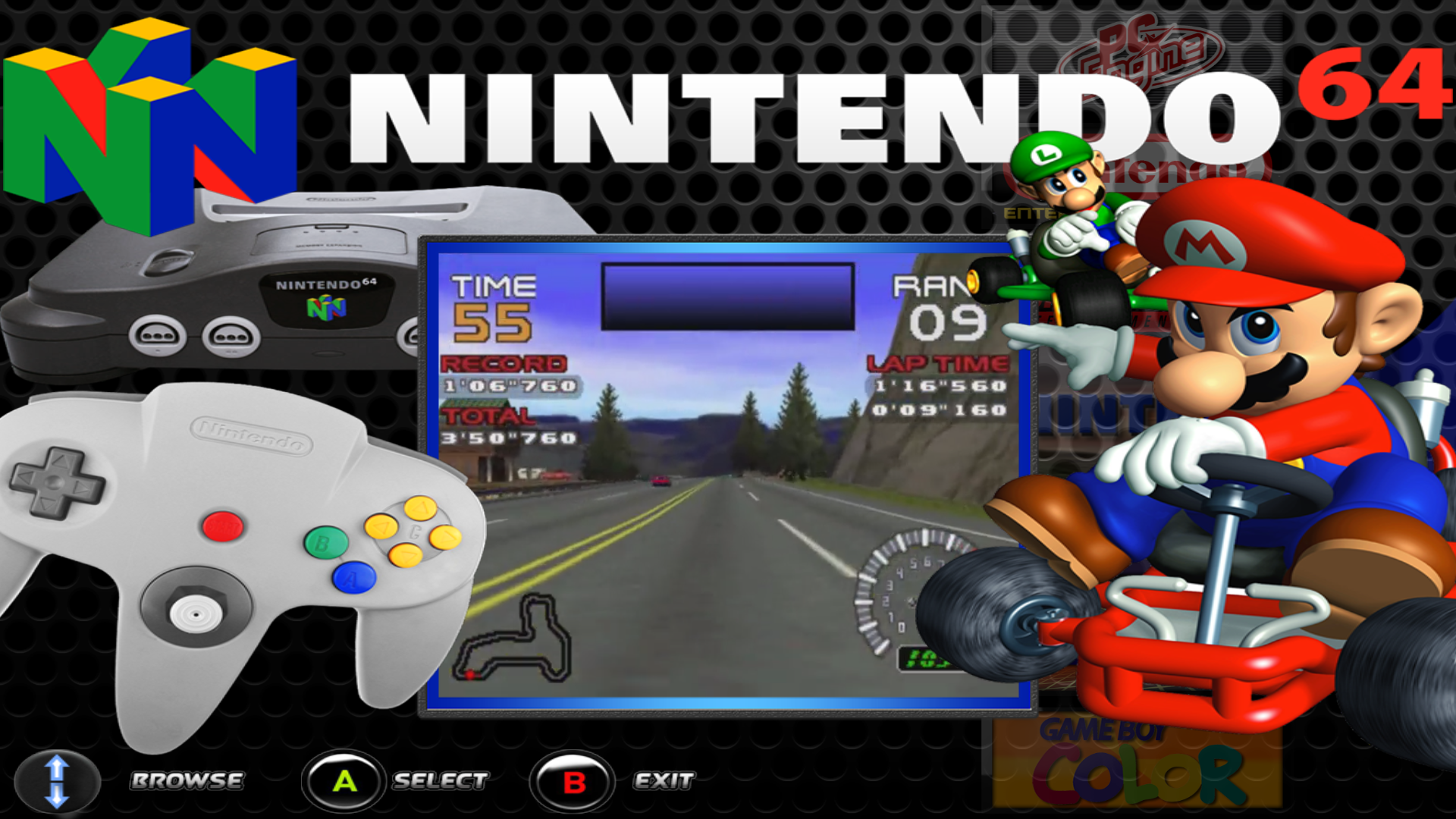

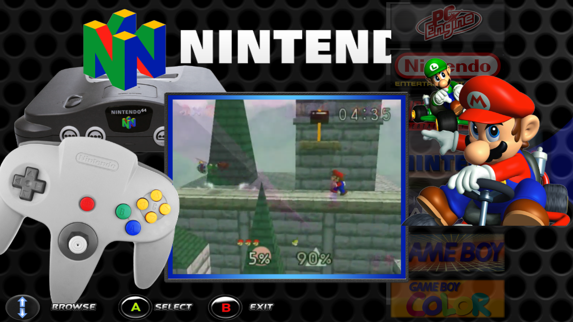

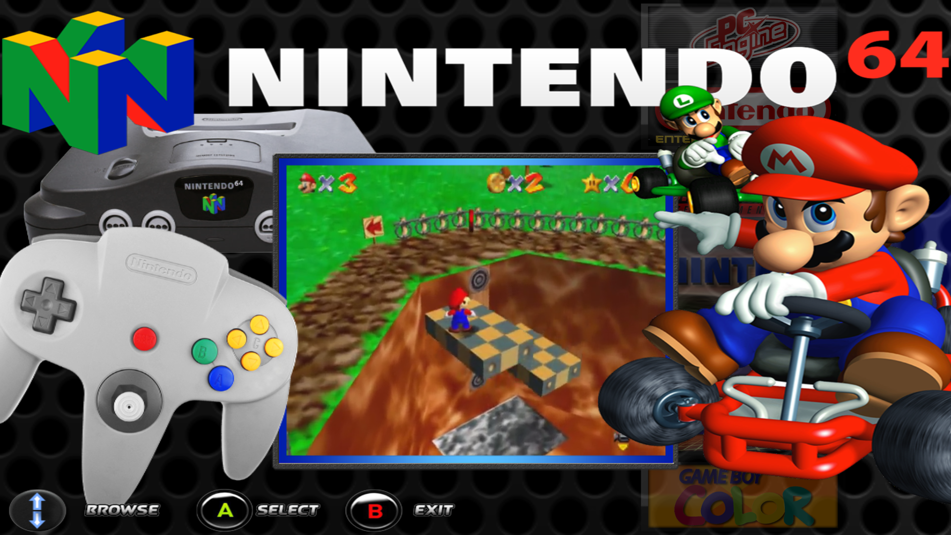

thatman84 Posted June 21, 2016 Author Posted June 21, 2016 That decompiler program is cool This is what I started with Got this sorted now. Extracted all swf to png images put them back in the theme. They were then to large!! Reduced some by 25% keeping aspect ratio on with fotosizer (from Avars widescreen conversion tutorials) Some images looked a little oversized. The SWF background was zoomed in. All a bit weird if you ask me. I reduced some by 60% Zoomed in Version This what I ended up with, it will do until i get more time many thanks (that beer me function is going to start costing me a fortune now i have found it!!!) Hyperspin 2.0 Latest Download Hyperspin 2.0 Documentation -------Pre Hyperspin 2.0 Below---------- HS Android Overview & Install HS Android Base Pack Download My Tutorials

thatman84 Posted July 1, 2016 Author Posted July 1, 2016 Cool yeah makes sense ish, So the anamorphic process that the smooth script applies does some sort of reduction to the image so it isn't stretched again. The cut off kart screenshot is the swf and the one below is just the PNG. As you can see the scale is completely different. Just wondered if there was a set ratio the smooth script applies so I can resize my png's the same and not have to guess with trial and error. Save some time Maybe the script doesn't work that simply but would be handy for me when I start converting more. So extract png's Reduce width and height by X amount Squish width to 75% (as per Avar/fotosizer) Put back into theme Enjoy Hyperspin 2.0 Latest Download Hyperspin 2.0 Documentation -------Pre Hyperspin 2.0 Below---------- HS Android Overview & Install HS Android Base Pack Download My Tutorials
BakerMan Posted July 1, 2016 Posted July 1, 2016 Cool yeah makes sense ish, So the anamorphic process that the smooth script applies does some sort of reduction to the image so it isn't stretched again. The cut off kart screenshot is the swf and the one below is just the PNG. As you can see the scale is completely different. Just wondered if there was a set ratio the smooth script applies so I can resize my png's the same and not have to guess with trial and error. Save some time Maybe the script doesn't work that simply but would be handy for me when I start converting more. So extract png's Reduce width and height by X amount Squish width to 75% (as per Avar/fotosizer) Put back into theme Enjoy Well, anything you find here within the downloads section ... swf's already have smoothing applied. Show your support for the Most Badass Project of them all! Subscribe to me on YouTube and Facebook!
