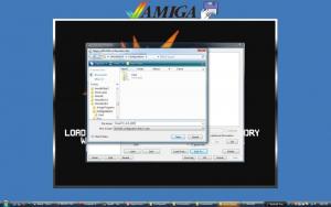

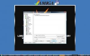

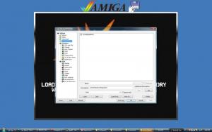

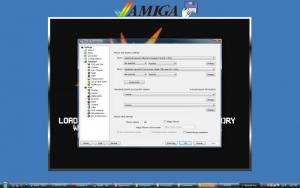

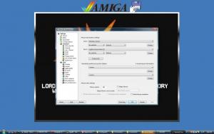

rfancella Posted November 21, 2014 Author Posted November 21, 2014 Ok, So, here is how to create per-game configurations that load each time you launch that specific game. This is very similar to the post above by Tarranius. Lets say, you want to play Smash TV (SmashTV_v1.0_2293) with 2 players and two joysticks (or 2 player control panel). The default settings in your WinUAE setup are for Controller Port 1 = Mouse & Controller Port 2 = Player 1 Joystick. Harumph! We need to have Controller Port 1 = Player 1 Joystick & Controller Port 2 = Player 2 Joystick. So, launch the game as you normally would in HyperSpin Or HyperLaunch HQ. Once the game is running, hit [F12] on your keyboard. This will bring up the WinUAE settings dialogue window: On the left side, click "Game ports" and you will see the default Port 1 and Port 2 assignments: Click on the drop down box for "Port 1:" and select your new Joystick or Keyboard Layout: Or... At this point, you can use the "Remap" button to change the button assignments. You can also make any other changes to the settings you would like to apply when you next launch the game. Once you are back to the above screen, click on "Configurations" on the left: Click the "Save As..." button on the bottom of that window and it will bring up a Save As dialogue box: You should be saving the file in your {Emulator Directory}\Configurations directory as shown above. In the File Name box, type the exact name of the rom. IE: SmashTV_v1.0_2293 and hit the Save button. You should see this now: You can hit the OK button at the bottom and play away! The next time you launch this game, the module will load this settings file with all of your changes in it and you should have to do nothing else. NOTE: There are a couple of instances where this will break. If your rom name changes or your rom path (location of your roms) changes, you will have to delete the {Rom Name}.uae file and do this procedure over again. Hope this helps some out there. Thanks, Ron Code Monkey and all around Command Line geek!If you like what someone has said or done for you, be sure and 'Thank' them. And if they changed your life, send them a Beer!
