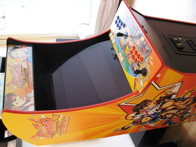

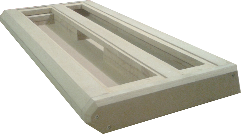

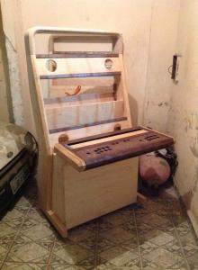

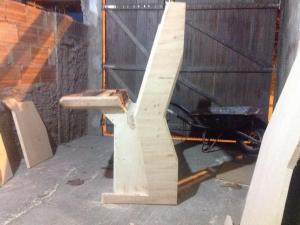

Looking good! Are the sides and the "base" (the lower part where the PC goes in) still separate pieces at this point of the build? So they can be painted white and black (or any other colours of course) easily?
And another question: The backpanels are not shown here, but on Maxime's website they seem to pretty much seal the back of the machine, but the site shows mostly renders it seems (http://www.arcadefromscratch.com/index.php/modeles/la-borne-hd) , so I wonder how they fit on your machine in real life?

JaronSenna, you can contact me on my facebook page if you want more informations or more pictures of real built of my newlix.

Never shared a picture of the controlpanel so here it is!
@JaronSenna - I'm pretty sure the base and sites are stuck together. Which I kinda regret, but deamed necessary at the moment.
Not sure what you mean in your second question.

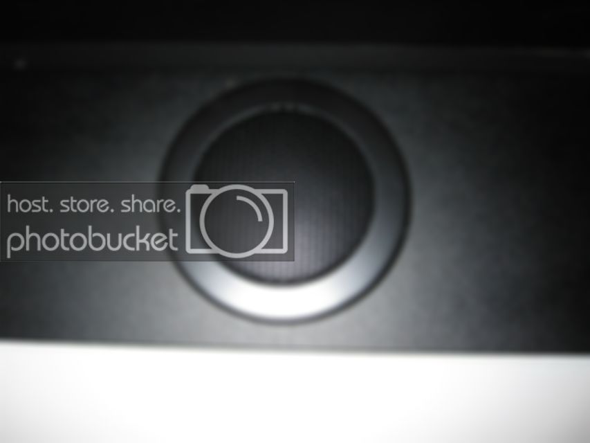

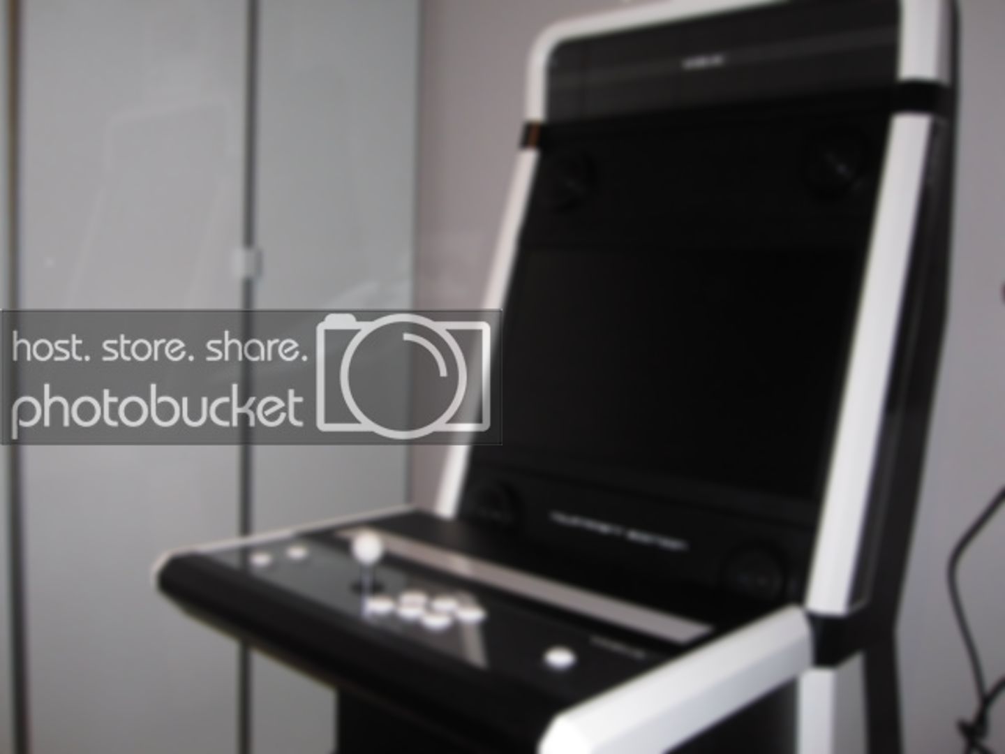

I have most likely already asked this question somewhere here, but would like some suggestions for speakers to use in this cab. I've been looking around and done some testing, but found nothing I like or there's an issue with the formfactor. Hoping to get some responds so I can finish this up.
I used a 2.1 kit for computer and i have replaced the two speakers by pionner two way cars speakers with black grid.
It sounds very good ans looks good.

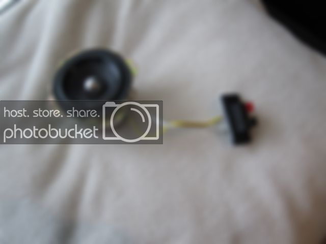

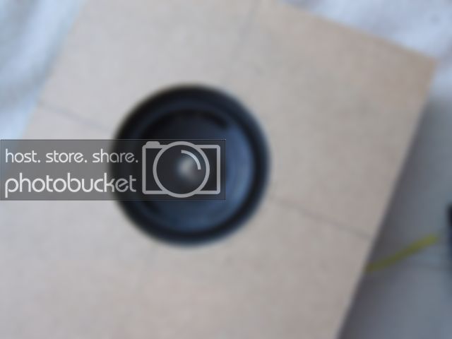

Not sure whether you want to go 'authentic' or not. The rest of your awesome and accurate build indicates that you might! I used the Logitech Z-5450 running in dual stereo mode. Left and right channels both come out of 2 sets of speakers whilst retaining the use of the subwoofer.
Edit: I de-cased them:
Mounted them on MDF board:
And found some fairly authentic looking speaker grilles:
What I meant is: have you made the back panels already? And if so, could you share how their shape fits? From what I can see, they have a special chamfer?

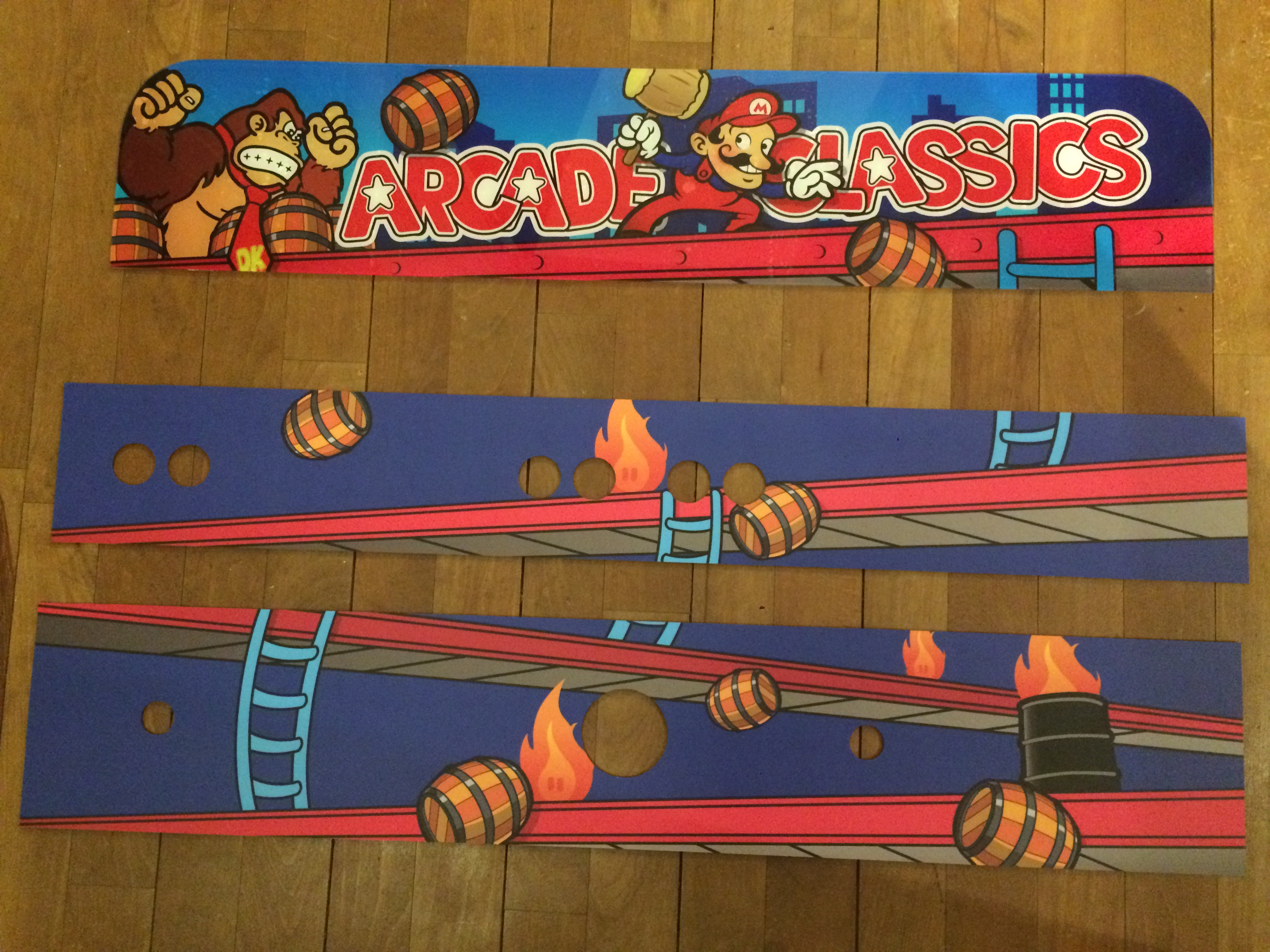

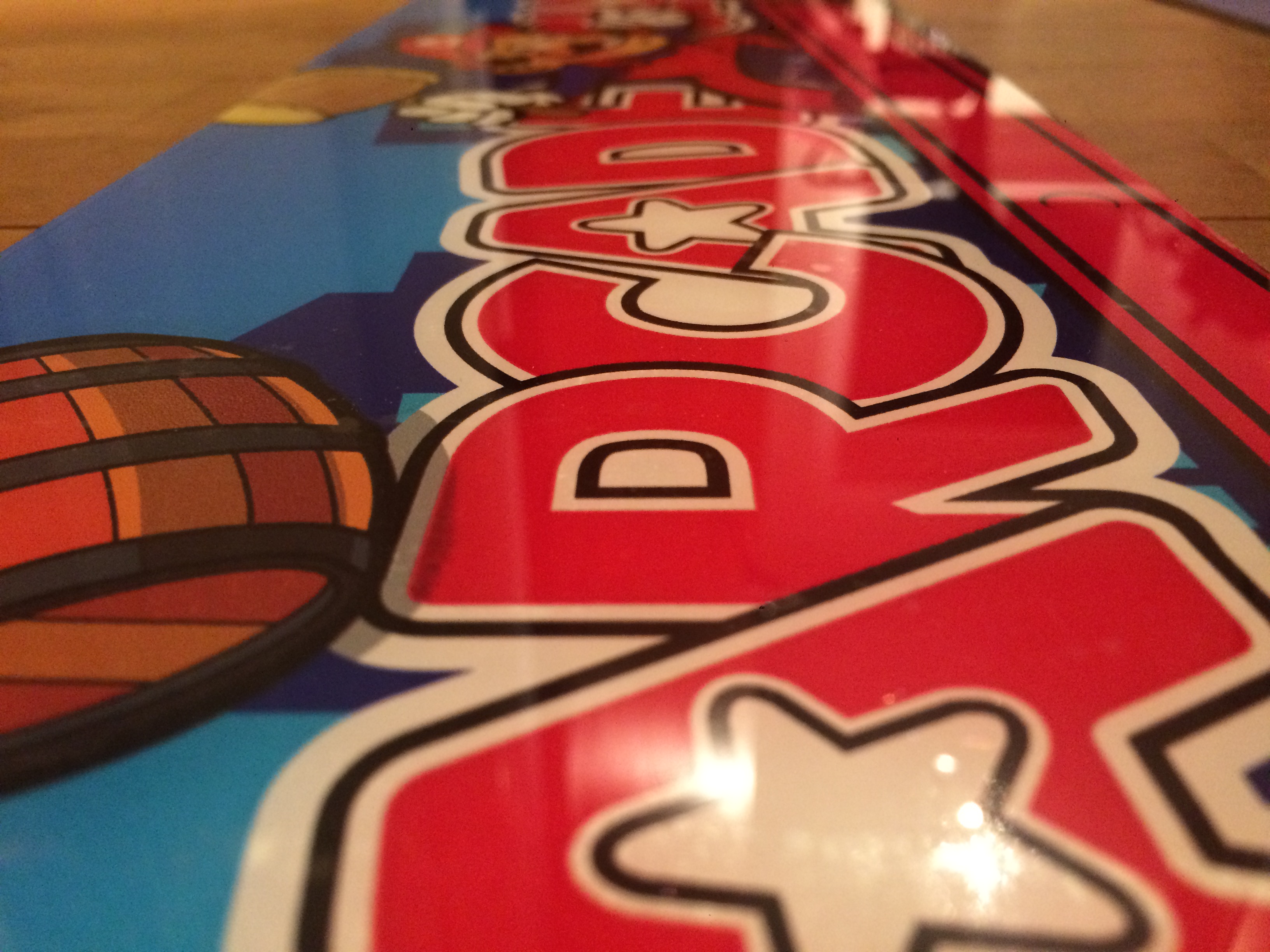

Recieved and applied my artwork today.
Marquee
CP
Artwork applied
Not the best pictures, but Bradley did a great job on these.

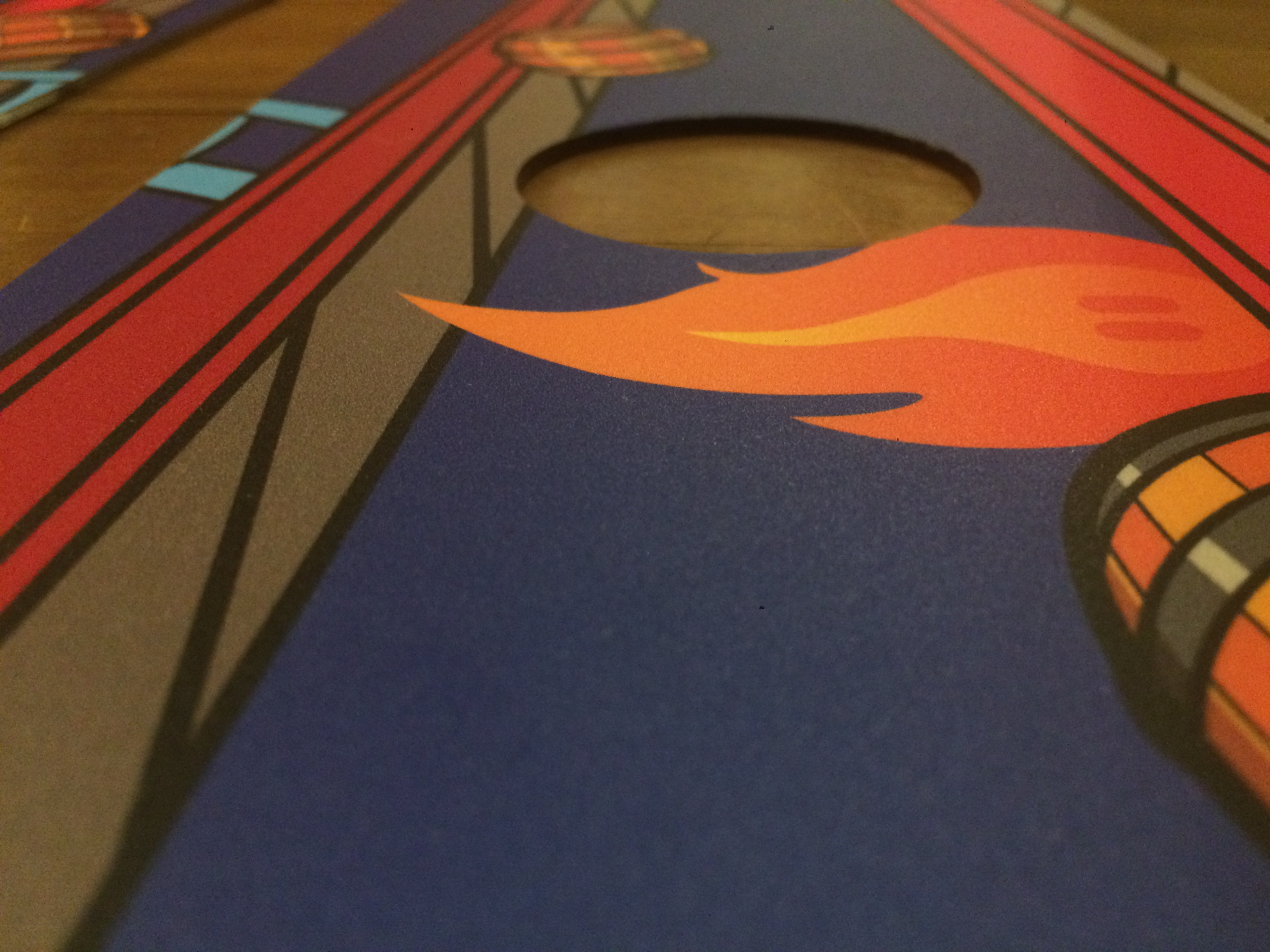

Texture of the CP
Reverse printet Marquee
Got some bubbles. Lesson learned for next time I guess.
Credit goes to @SubZero for designing these. Had to redraw all of it because the original file got corrupted.
very nice :) I had a few air bubbles in mine i used a pin to prick then warmed up very slightly with hair drier then used a decorators roller to flatten

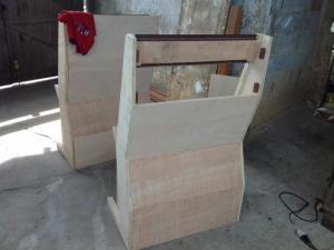

Today I made some progress. Back and front of the lower segment have been mounted.
So many things have been finished and just needs to be assembled.
Not in that big of a hurry though as it's way to cold to paint atm.
