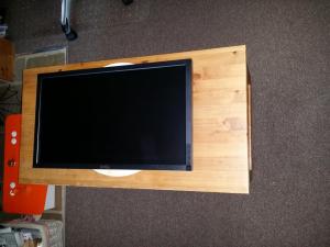

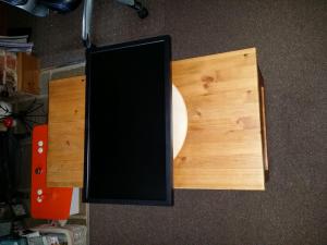

gigapig Posted August 27, 2016 Posted August 27, 2016 Hello Gentlemen After putting this dream off for many years I am finally going to put together a cocktail table which I've always wanted. Why a cocktail table? Well that's just a question of space and I've always loved them even though some are ugly and mine may turn out ugly going by what I have to work with. I could use a kit but the standard kits look slightly to tall to fit in front of my couch and aren't the most exciting. So this is what I intend to convert, It's our current table and it's a chest full of crap. Here it is with the monitor I've saved for it. It's sat on a lazy susan I picked up from Ikea for £5. Now here are my problems. I've also dreamed of a rotating screen but that would require either a different box or building another square box to hold the screen. I did a bit of reading this morning and Phulshof suggested using a 16:10 display and I can see why that may be better but it's extra cost. The bigger problem is something I always struggle with and it's controls. My current CP has the guts of a 360 controller in it so I'm not familiar with Ipac etc. What I want to use are the UltraStiks, has anyone got any advice on using these either coupled with and ipac or without. Do I have controls just at the ends of 2 on the side as well making that a total of 4 sticks. If I use 4 UltraStiks it's going top cost $240 (£148) or could I use 2 UltraStiks and 2 cheaper sticks for the horizontal games? I'm sure there are ways to tell mame which to use and this will be mainly for Mame, maybe some TTX and other arcade systems. I think I would like to sink the glass or plexi into the top so it's flush and maybe have minimal artwork the head is spinning. If any of you guys have finished a cocktail table then please post links or pictures and any advice would be greatly appreciated. Just found this which looks quite nice, I like the glowing cut out. Oh my I've just found these which are stunning. How do they get that finish on a tyre. I did also consider a DK barrel, I can buy a new wine barrel for £120 but you are limited to a small screen. Thank you.

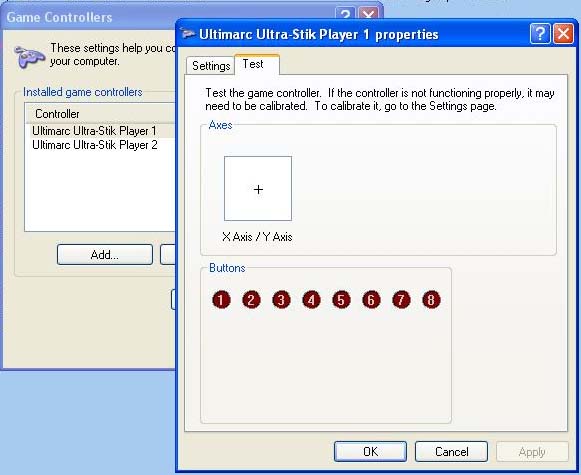

32assassin Posted August 27, 2016 Posted August 27, 2016 What I want to use are the UltraStiks, has anyone got any advice on using these either coupled with and ipac or without. Do I have controls just at the ends of 2 on the side as well making that a total of 4 sticks. If I use 4 UltraStiks it's going top cost $240 (£148) or could I use 2 UltraStiks and 2 cheaper sticks for the horizontal games? I'm sure there are ways to tell mame which to use and this will be mainly for Mame, maybe some TTX and other arcade systems. the Ultra Sticks 360 can be used as a geric joystick that requries a keyboard encoder or it can be set as generic joysticks with 8 buttons, similar to the Xbox controllers https://www.ultimarc.com/ultrastik_inst.html best thing to do is to use them as your main controls (Map it directly to the emulators) and use an ipac to control 2 cheap controllers and wire the service keys (coin P1+2 start ect) to the ipac. I would use an Arduino Leo since they are less then $10 over the Ipac, but that's just me.

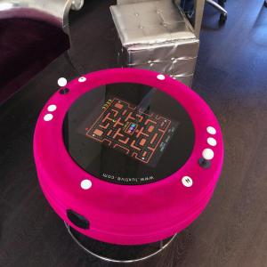

KlopjerO Posted August 29, 2016 Posted August 29, 2016 the tyre looks powder coated | My themes / downloads | Get the MS-DOS Wheel sound pack | Get your MS-DOS game themes here | Get the MS-DOS wheel set here | My YouTube channel | WarcrafT - Lord of the clans |ZeroJay's Ultimate DooM archive
gigapig Posted August 29, 2016 Author Posted August 29, 2016 the tyre looks powder coated Yeah it looks like a soft touch rubber coating or velvet finish. Plasti-kote do velvet and suede finish and I think Dr Brains, the only other product I found was not for domestic use.

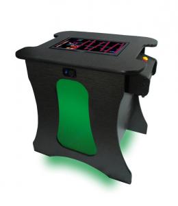

majorspawn Posted August 30, 2016 Posted August 30, 2016 This is awesome http://www.rnrassociates.com/wordpress/retro-arcade-table/ Gig i think i just found your design! Sent from my SM-G930F using Tapatalk My Arcade Projects: SNES PC Project Vewlix Cabinet LS-30 Rotary Joysticks
gigapig Posted August 30, 2016 Author Posted August 30, 2016 This is awesome http://www.rnrassociates.com/wordpress/retro-arcade-table/ Gig i think i just found your design! Sent from my SM-G930F using Tapatalk I was thinking along those lines for sure. What worries me about that is the smoked glass making the image darker and it's adding to the slight darkening caused by shaders. Something else to check up on. I do have some long sheets of plexi in the garage to try. Has anyone used anti reflective glass or coatings? Edit: Perhaps it's not smoked glass, just toughened.
